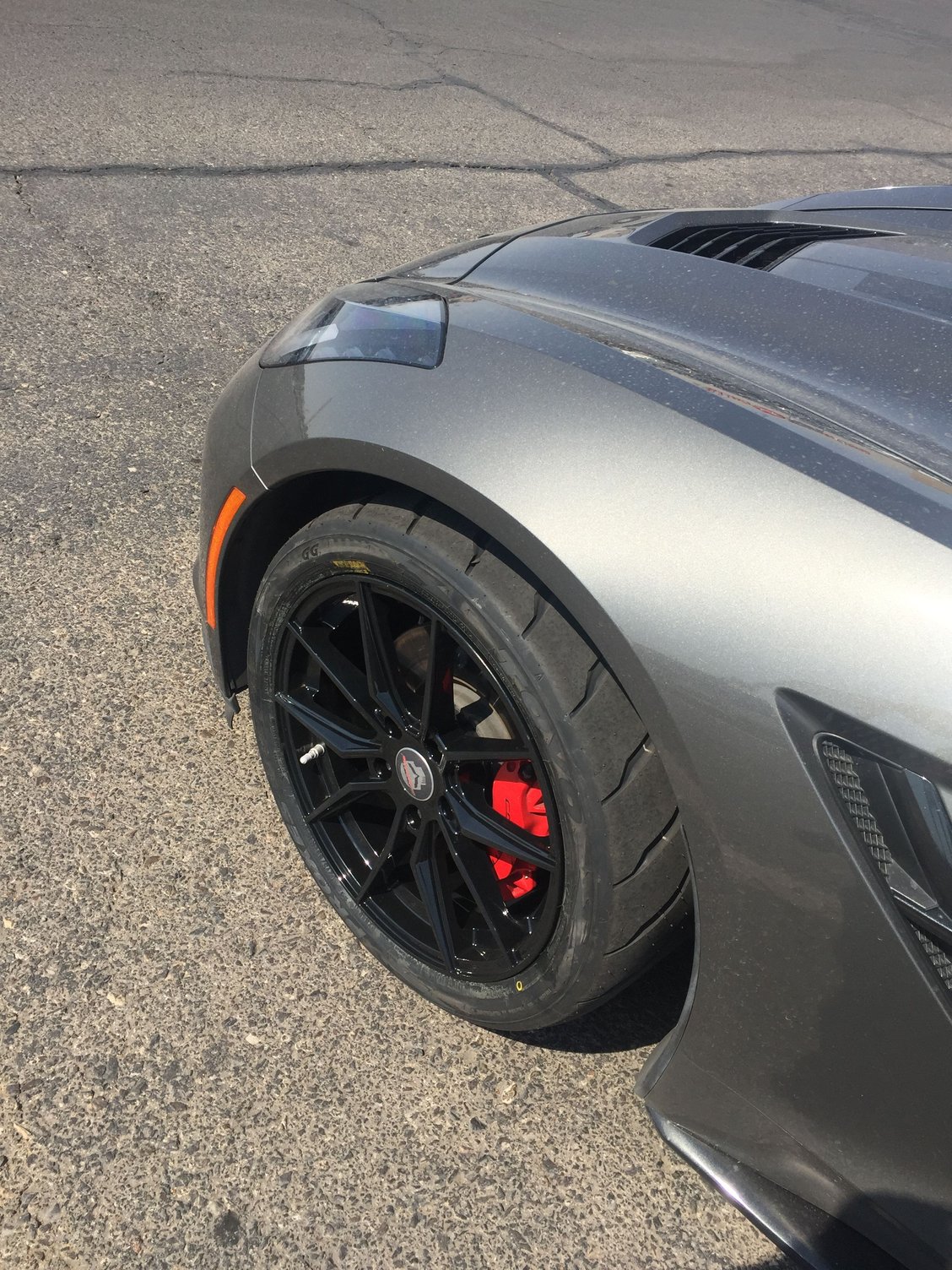

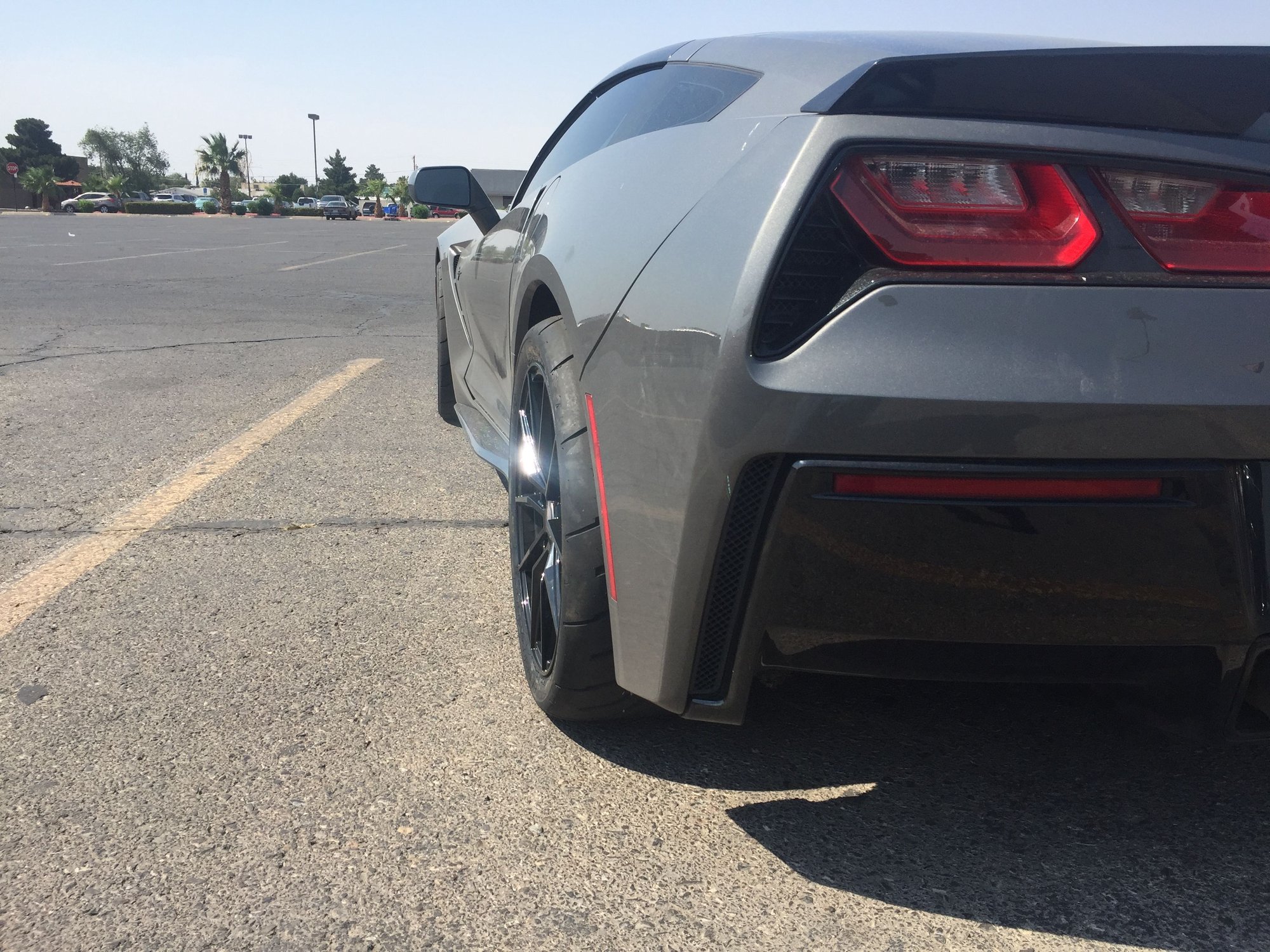

325/30/19 Toyo r888
275/35/18 ToyoR888R
Finally got my wheels and tires no more spinning

no rubbing whatsoever but mine is a base 3lt
wheels are Cray Spiders 19x11 76 offset and fronts are 18x9.5 59 offset not sure on that one Rears stick out slightly
Im at 630 thru an A8 and would spin viloently at any speed below 80
I havent started from a dig but so far the cat just takes off at any speed
