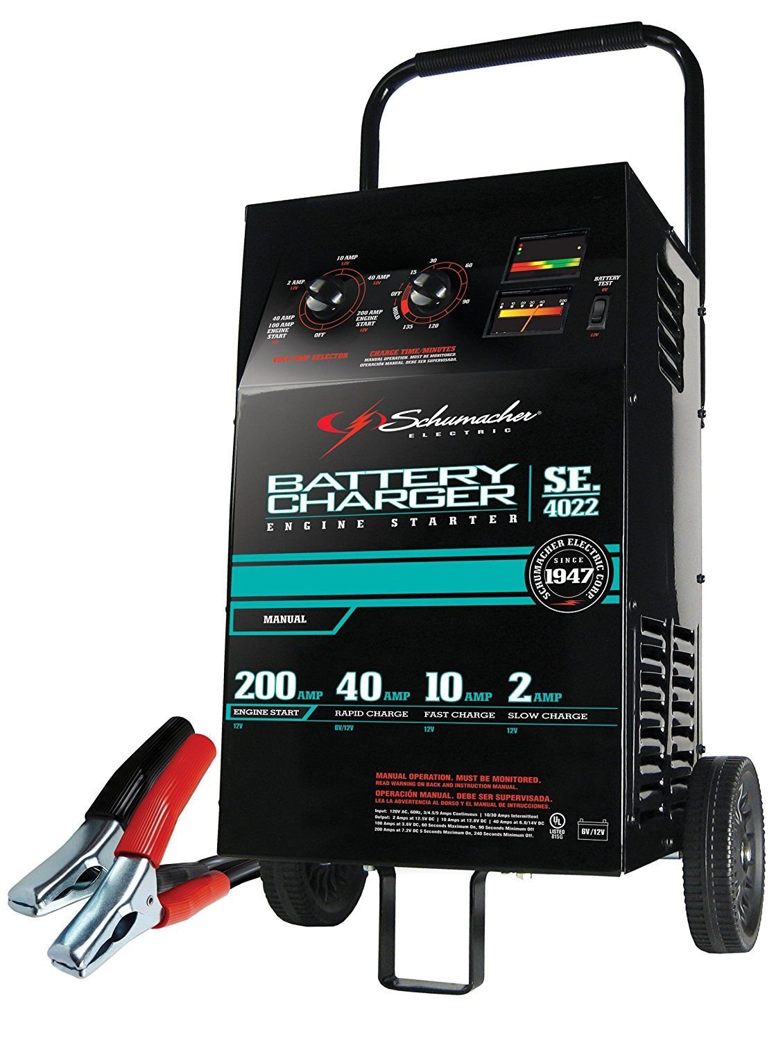

My charger is the type you see in service stations. It is similar to this one but mine is over 30 years old
