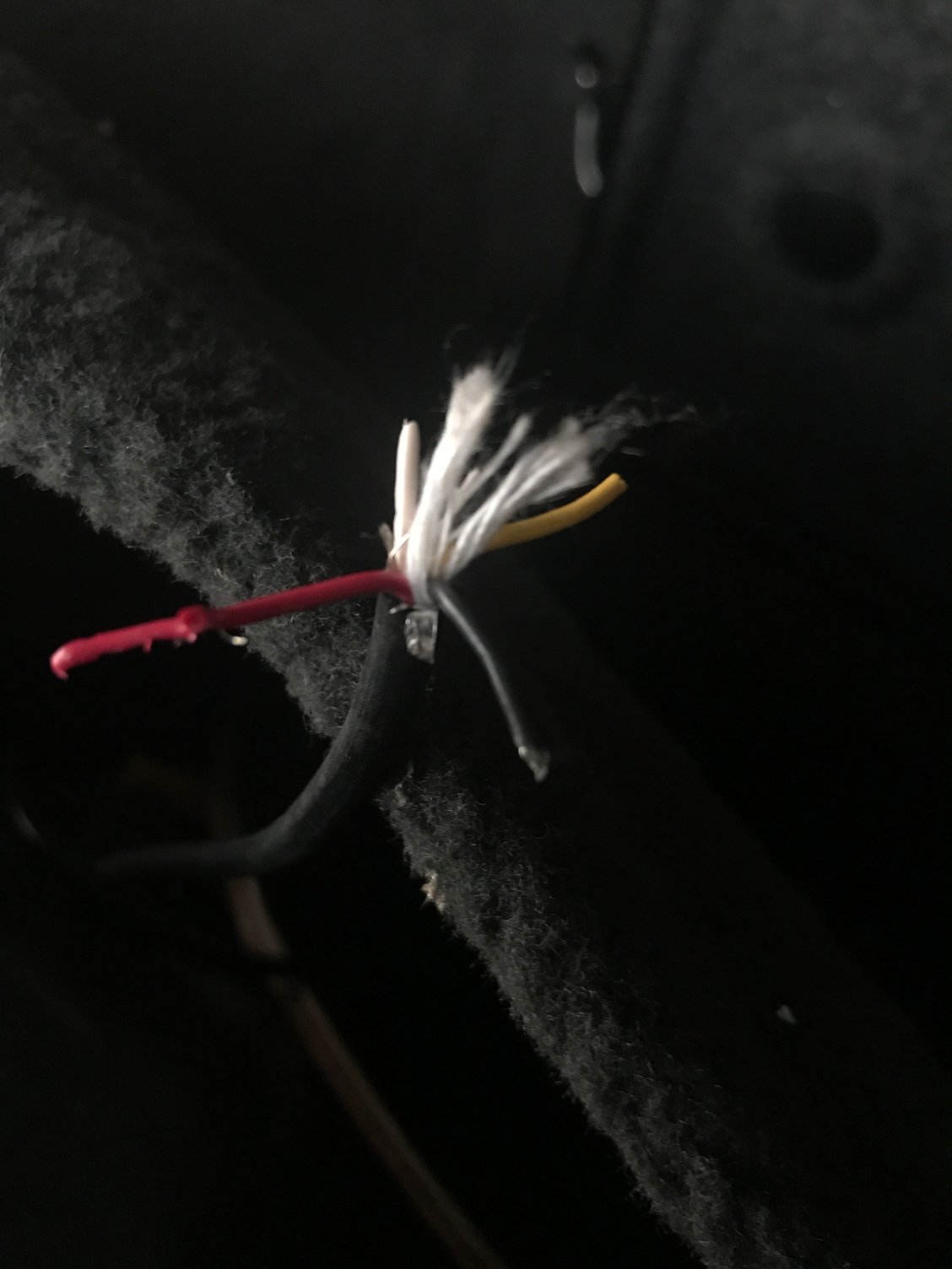

i have the same camera, but like an idiot cut the cable about 6-8inches from the pigtail. Now I only see 4 wires. Red, white, yellow, and 1 black.
