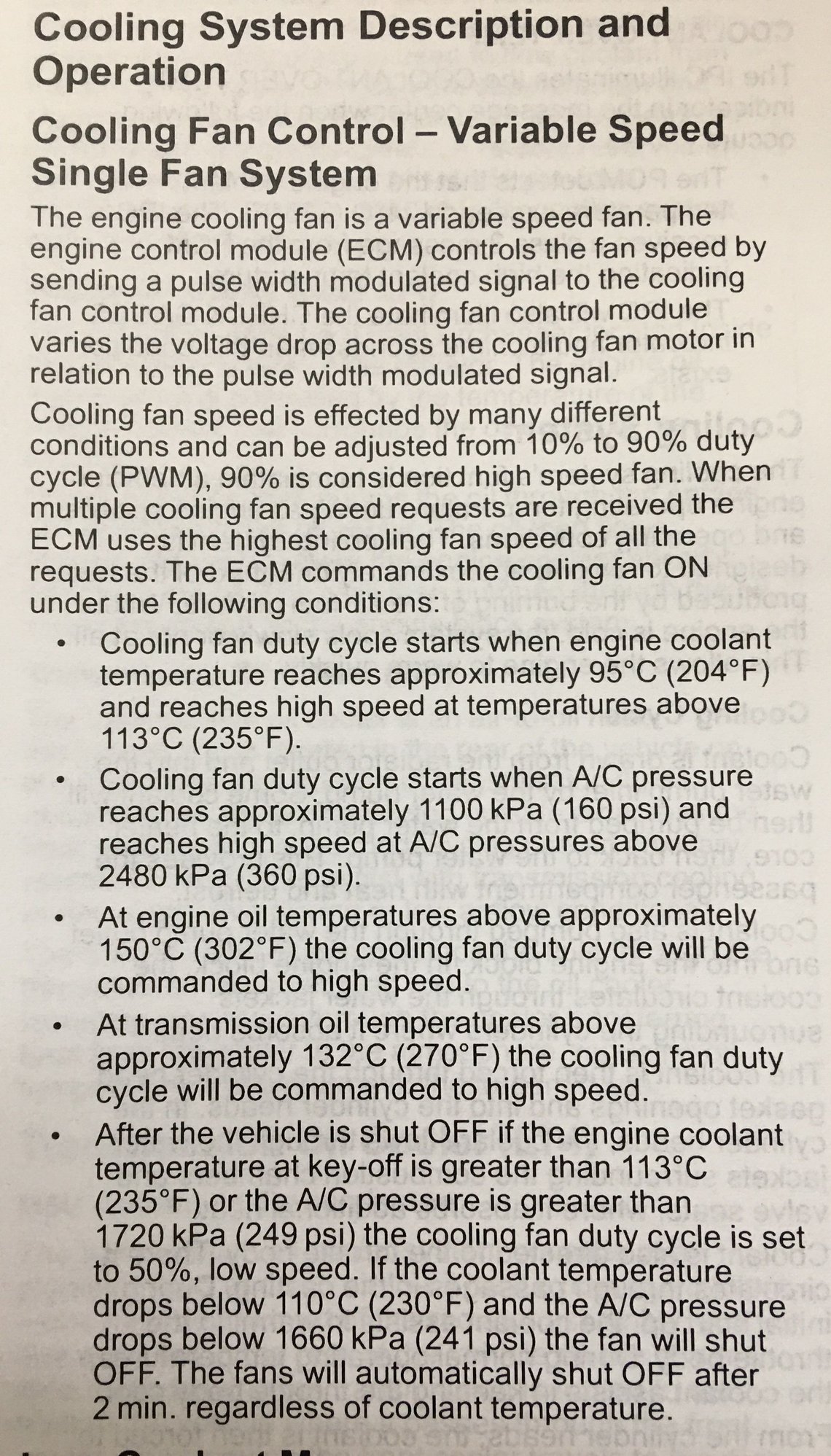

Originally Posted by Greenkirby21
Hi there!!
I too also have a 2014 that is randomly overheating. I have taken the car to the dealership 4 times now and have been sent back home with nothing to fix.
The last time it happened, I was actually just arrived at home and was sending a text message when I noticed the needle started to climb.
I took the following video
https://youtu.be/yOlp-IOcT6o
It has been very sporadic when it has happened to me. About a month apart each time. It's been 2 weeks since my last episode.
I contacted GM and their service has been terrible. They kinda told me the same thing as the dealership, well if we can't find anything wrong with it we can't fix it. There are a lot of threads about 2014 models overheating in traffic/slow speeds
Your video doesn't show any over heating. I see no warnings and the final coolant temp only reaches 240 after idling for a while. Oil temp is well within temp limits so isn't a concern.
Here are the cooling fan operating temperatures and pressures.
At 240 degrees your cooling fan should have been on high speed. I couldn't tell whether it was or wasn't but the car definitely didn't over heat through the video.
Bill
Bill
it never turned on from what I saw. It scares me to see coolant temps that high though I'm doing everything I can to make my car run at 200* or less in 100* ambient temps lol
Bill
Ya, the fan never came on at all. 240 is my limit now before I turn the car off. If I don't touch it, it goes all the way to 260+ and a message pop ups that says engine overheating, idle engine - which is funny because it is idling anyways when it climbs from 200 to 240+. Trying not to destroy my engine. Once I turn it back on immediately it is slow to churn, but the fans immediately kick in and within a few seconds the temp starts to drop to what I see as "normal" (<200).
That being said, I've been in intense rush hour traffic and the fans are good and never goes above 205. Seems to be sporadic but I kinda have a feel for when it will happen if the temps start to randomly rise.
