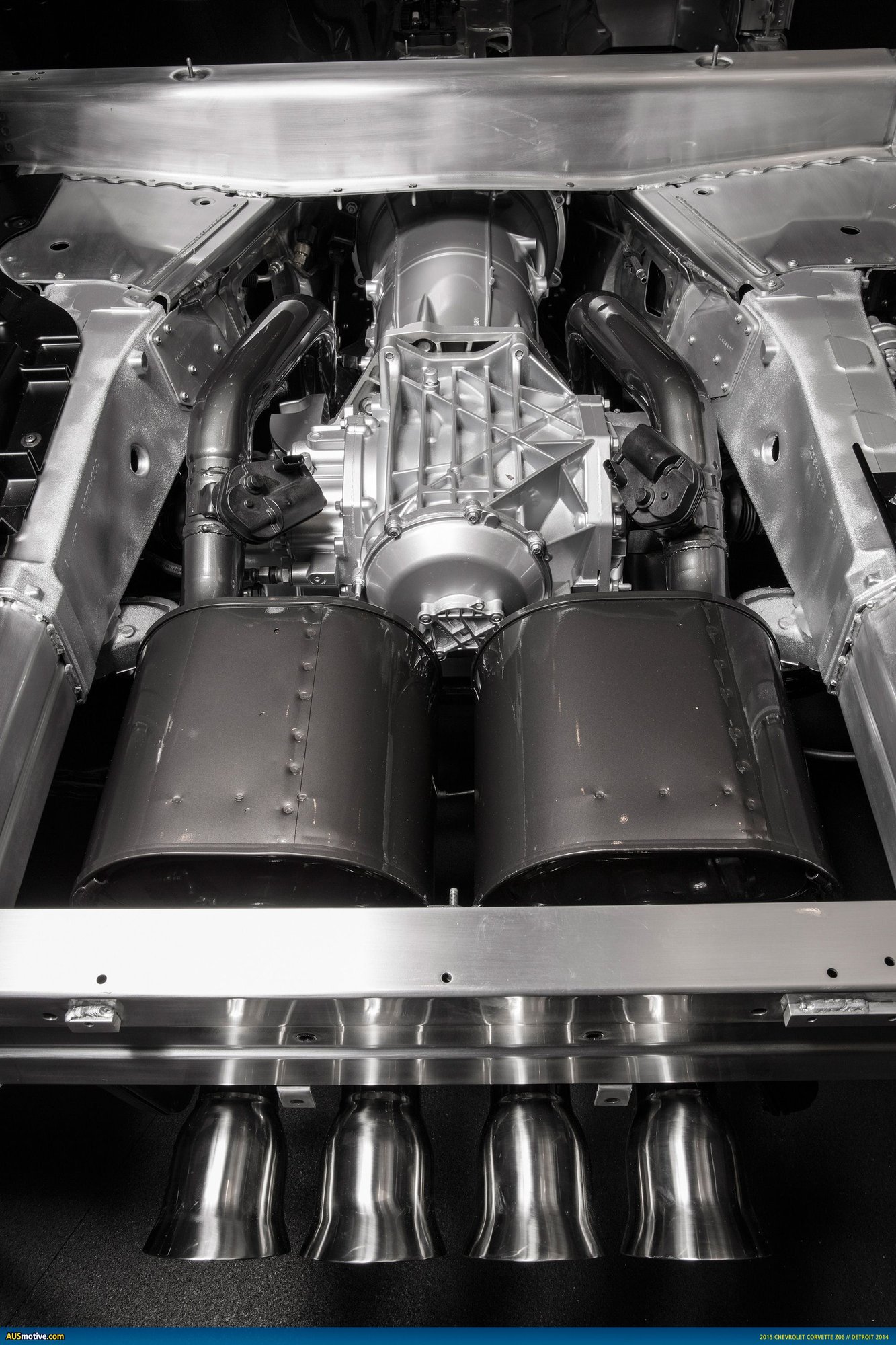

You can see in the picture below the AFM valves sit just in front of the mufflers and are tucked up inside the frame.
To access them the axle back assembly has to come out. That means removing the lower rear fascia on the bumper cover, removing the tunnel plate, unclamping from the X-pipe, and disconnecting the wiring/hanger isolator/center bolt. Then the assembly slides out the rear, and the actuator can be replaced easily. And then put it all back together. I'd say 4 hours is a generous estimate for this work by a professional. On a lift with the right tools, 2 hours seems more like it IMHO.
