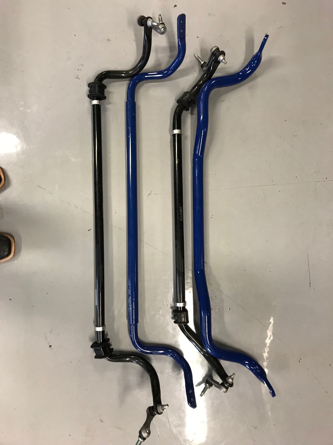

I have a 18 Z06 taken apart for a complete track build so I put the OEM and our sway bars side by side for comparison. LG Front 1 9/16" LG Rear 1 1/8" OEM Front 1 1/8" OEM Rear 1 1/16"
My measurements on the OEM cold be slightly off, I did it in about 5 seconds with a tape measure.
Our sway bars aren't only larger/stronger but the over-all design is what we found worked best on the race track.

What type bushing do you use on the LG bar. I know you guys have lots of track experience and I’m looking for a sway bar system that’s proven not to bind up . ( some I’ve seen use questionable bushings)

If I'm not mistaken we use a modified GM bushing.
