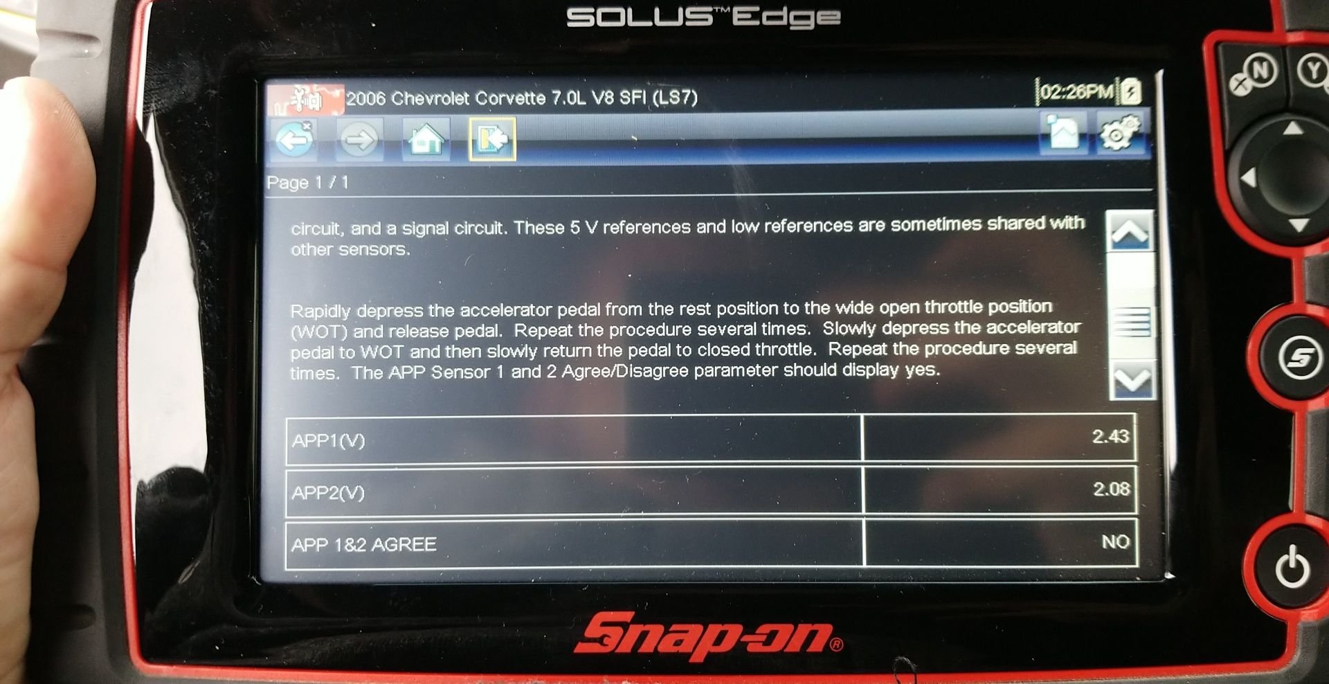

Hello All! I recently bought a car from a forum member, the weather is starting to break here in Indiana so took the car for a drive around the neighborhood (haven't drove it since I bought it) a couple minutes into the drive i got the "reduced engine power" and P2138 code. I made it home and now trying to figure out what the issue is.
I swapped in a new pedal from the dealership, same issue.
The car is an 06 Z06 with RPM Auto Swap. The previous owner says he's never had the code pop up but it doesn't make sense how it does it all of a sudden, the car went from his drive way, to my trailer, to my driveway and all of a sudden it's got this issue?
The car has a 102TB, RPM Auto Swap, H/C/I & Exhaust. I got some scans from my snap on scanner but not really sure where to go or what to look for, any help would be appreciated. I don't think the dealership would work on the car because it's modded to the moon and back, you know how it goes...
Here are the pictures from the SnapON Scanner...
Ignition OFF, PEDAL NOT PRESSED
Ignition OFF, Accelerator Pedal PRESSED TO THE FLOOR
