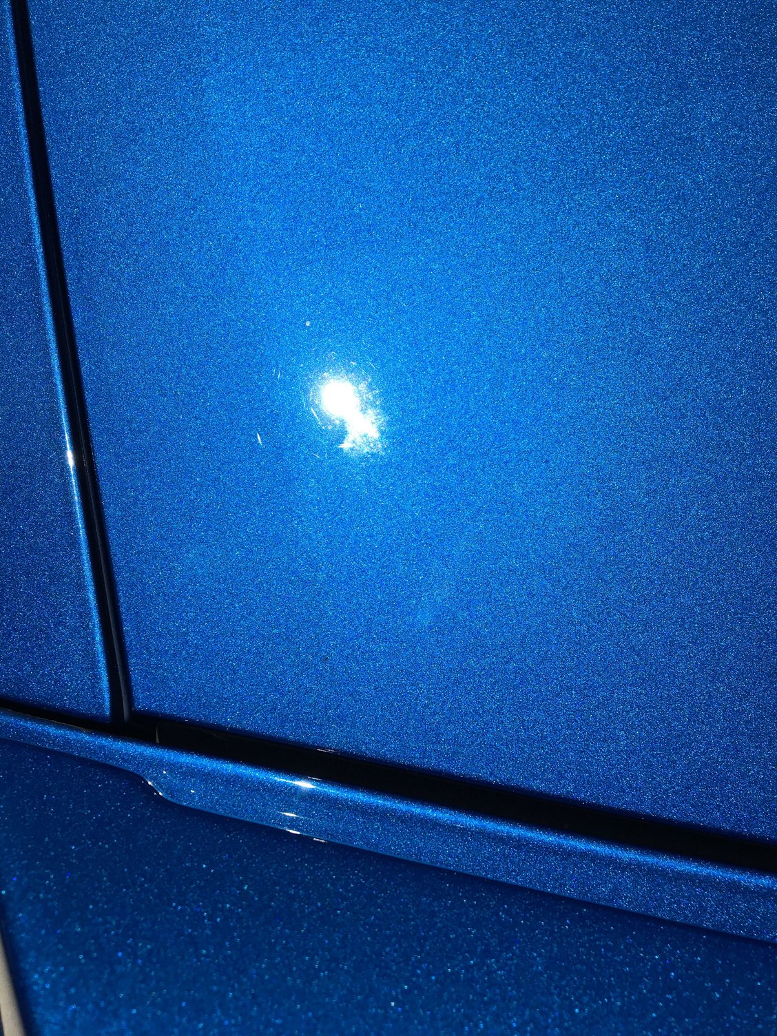

i have this issue on my ‘14. i took it to the dealer and they said the rear hatch lift bracket needs to be replaced. they want over $600 to replace a lift bracket that can be bought for $59 from gmpartsdirect. naturally, my gm extended warranty doesn’t cover brackets. trying to find someone who has changed the bracket to find out what is involved with making the repair. so far no luck. btw, tried the silicone lube thing and it worked for awhile but no longer.

thx, i’ll give that a try. may not work though because my hatch is misaligned. i think that is why the lift bracket failed in the first place. just a theory.

ride close door with windows up thing and it didn’t work. because my hatch is misaligned, the one edge is providing enough friction to keep the hatch from popping up enough to open it. need to realign the hatch but have no clue how to do it.

i bought the car from a close friend. i’ve known the car since he bought it new. it has not been hit. i think the lift window bracket is damaged as it no longer functions. but i think the misalignment caused it to fail over time. that’s why i need to adjust the hatch first. right now when opening, it the rear passenger side hatch edge rubs slightly on the rear deck keeping it from popping up at all. here’s pics at of the hatch edge and the gap between drivers and passenger side. note the drivers side (second pic) is wider.
