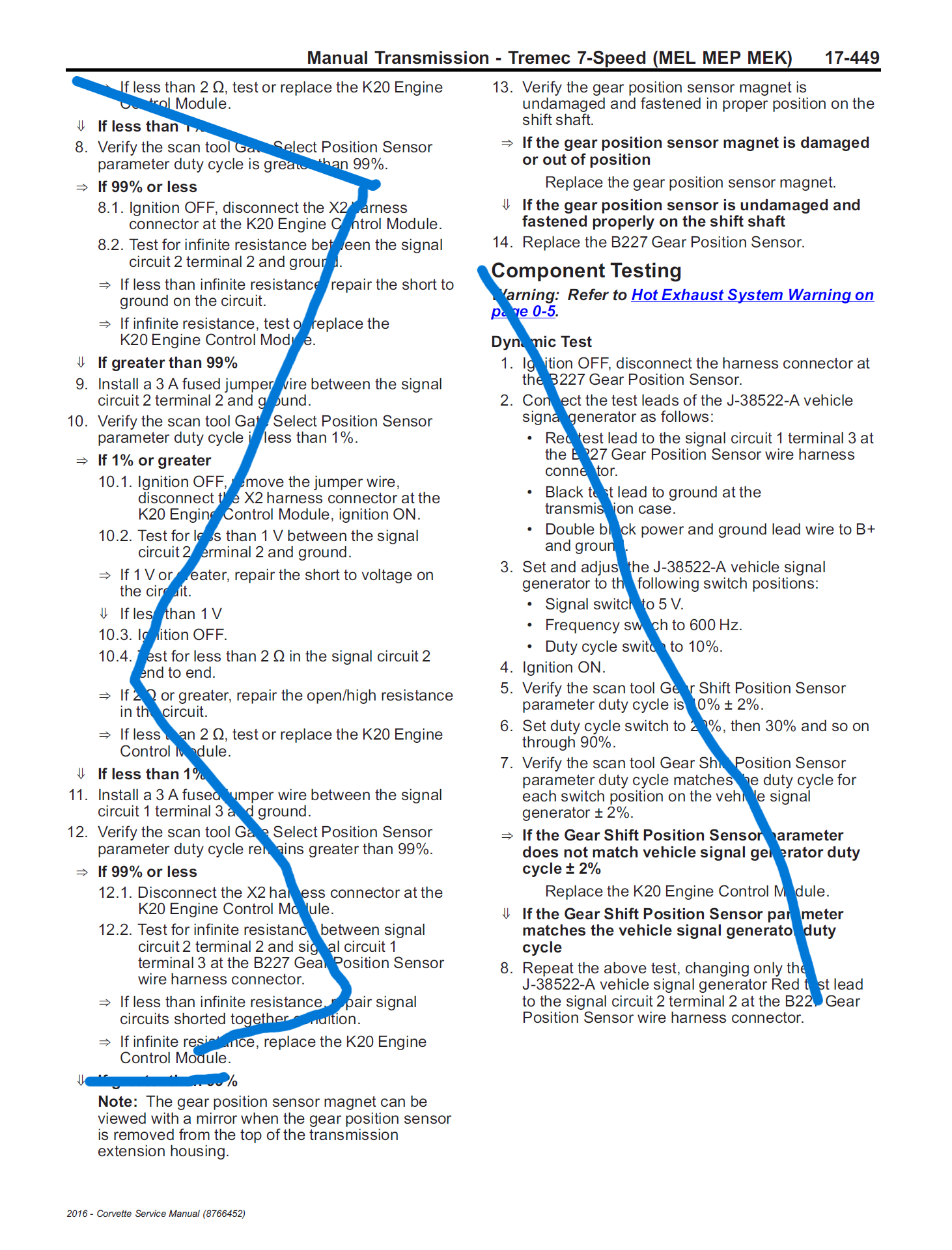

Changing the air filter won't affect the Rev Match feature. The ECM uses the gear position sensor to determine when to blip the throttle. The sensor is mounted to the top of the transmission extension housing. There is a gear position sensor magnet that is mounted on the shift shaft and it has to be in the correct position.
The Rev Match feature seems to be working so you don't have any Rev Match codes set that would inhibit Rev Match so the issue may be more alignment/wear related than anything else. Here is a page out of the FSM that addresses code diagnostics but may be applicable in your case. I have crosse out the areas that I think don't apply:
Several transmission P Codes inhibit Rev Match. They are related to sensor position, sensor voltages and sensor magnet placement. If you find any of these codes listed as history codes they might help point you to the area where the intermittent is occurring. If there are no codes then it is likely the problem is an adjustment issue.
