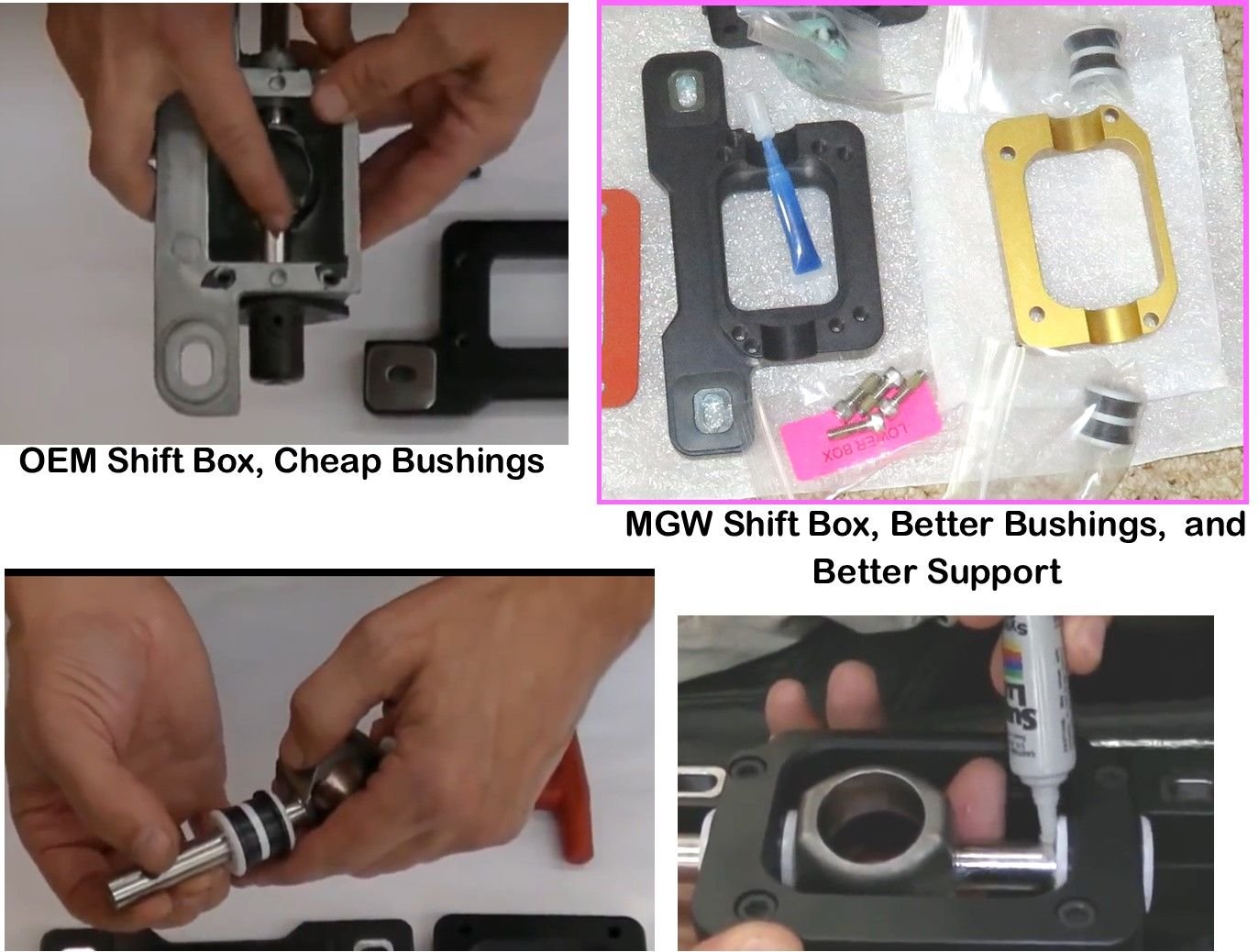

I wonder if it could be the shifter h\getting a bit sloppy?
This is from an old post above:
"I'm very good at heel-toe for "slam-shift-fast driving" as you refer to it! Not hard to learn to stab the throttle and get a perfect match as the single lower gear you're downshifting to is near redline!
Much harder to modulate the throttle to get a perfect match say when cruising at say 45 mph in 5th gear (~1400 rpm) when making a turn and wanting to be in 3rd gear (~2800 rpm) and get a perfect match! I do that in most turns while causally shifting and rev match makes it perfect every time.
Same on the interstate when in 7th gear at 70 mph (~1450 rpm) and going on to an exit ramp where 4th gear may be where you want to be. Using two other overdrives, 6th and 5th, to get there is a waste of time so I go directly to 4th (~3000 rpm.) Rev match makes that casual shift easy and a perfect match.
One thing you cannot do that I had to unlearn was putting the shift level anywhere accept where you intend to shift. I'll explain. In my C6 I would also shift from 5th to 3rd when making a turn. However an old habit was "while the clutch was depressed" I would put the shift lever in 4th then 3rd before I engaged the clutch. Spools up the cluster gear! Confuses the computer that is anticipating your intensions.
Perhaps a better example is folks who say it overrevs. I was able to duplicate that in a test! On my normal casual 5th to 3rd downshift while driving at ~45 mph I pulled the shift level just slightly toward the 1st/2nd gate BUT while still in neutral. The computer anticipated I was going to shift to 2nd even through I was in the neutral gate. So instead of holding at ~2800 rpm it jumped to ~4000! There are Hall sensors that monitor the shift level movement even in neutral.
Bottom Line
, you can only put the shift lever where you want to go! Can't rattle it in neutral to be sure that is where you are! "

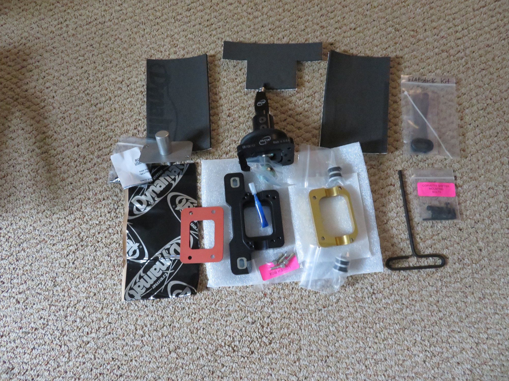

This is a detailed How To Doc on installing a MGW Shifter: http://netwelding.com/MGW_Shifter.pdf
If the shift lever gets a bit slopy over time wonder if that could be a cause. Although the sensors are INSIDE the trans not the shifter I found the MGW is a much more rigid as well as shorter throw.
May help, May not but you'll love the shifter!
Quality Kit
Much better bushings and support
