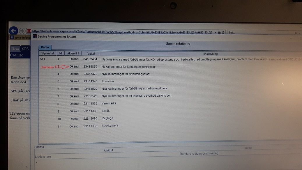

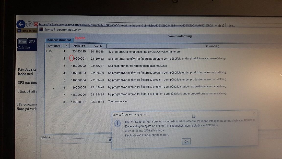

I have bought some new boxes to the car and i did start to program them using monegoose and tis2web.
But i have a few problem with some box.
One box says unknown software number in the actual #
and a other one have the symbol (*) in front of the software number
I can not update this two boxes, how do i do?

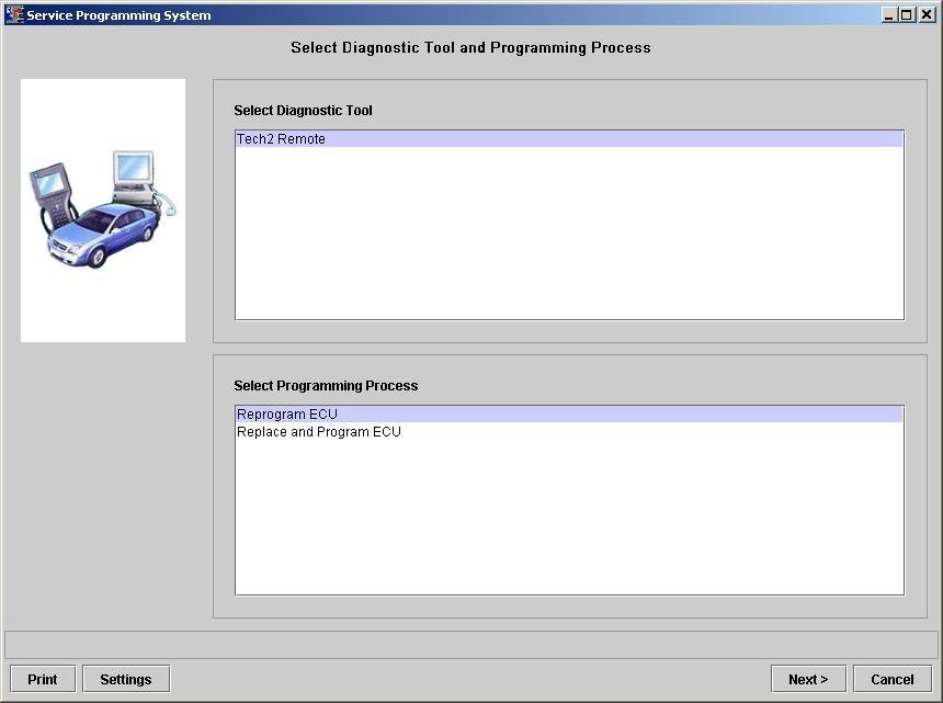

It shouldn't matter which market it's for. All GM cars are programmed the same way.
On the very first screen where you chose your programming tool (Mongoose) there should be two options. 'Reprogram ECU' and 'Replace and Program ECU'
This screenshot came from the GM Europe support page: https://www.gme-infotech.com/info/tis.html
If the Replace option is missing, then you still need to talk to technical support to find out why. There's no 'tricks' you can do in the software.
