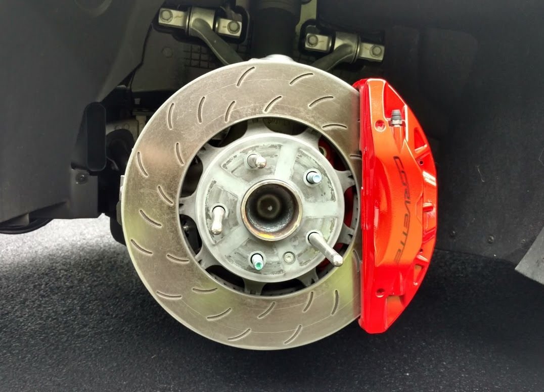

Power Stop Pads will turn your rotors Brown !!!!!
Power stops didn't turn my rotors brown, and I could care less if they did. I do not consider brake rotors a component that adds to or detracts from the appearance of a vehicle. And I see no brown if that is suppose to be a rotor your ashamed of. Do you worry about the appearance of the treads on the tires also?
