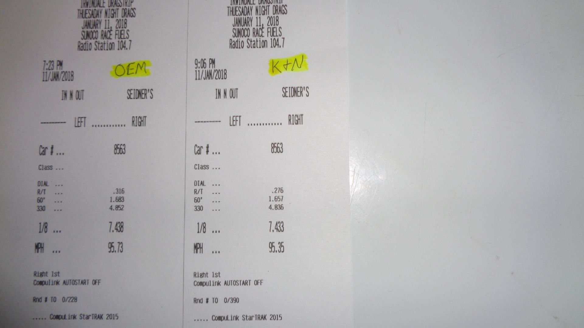

I do not rely on Dyno testing, I rely on my time slips at the drags. I have run the 1/8 and the 1/4 with the OEM, K&N, Burger and AFE Dry, all are within 1/2 a tenth and 1/2 mph. Here is the time slips comparing the OEM and the K&N on the same night. You do not get any magic on a stock LT1 changing the air filter real world. The OEM paper may be more restricted but has may more pleats then the K&N, Burger and AFE.
