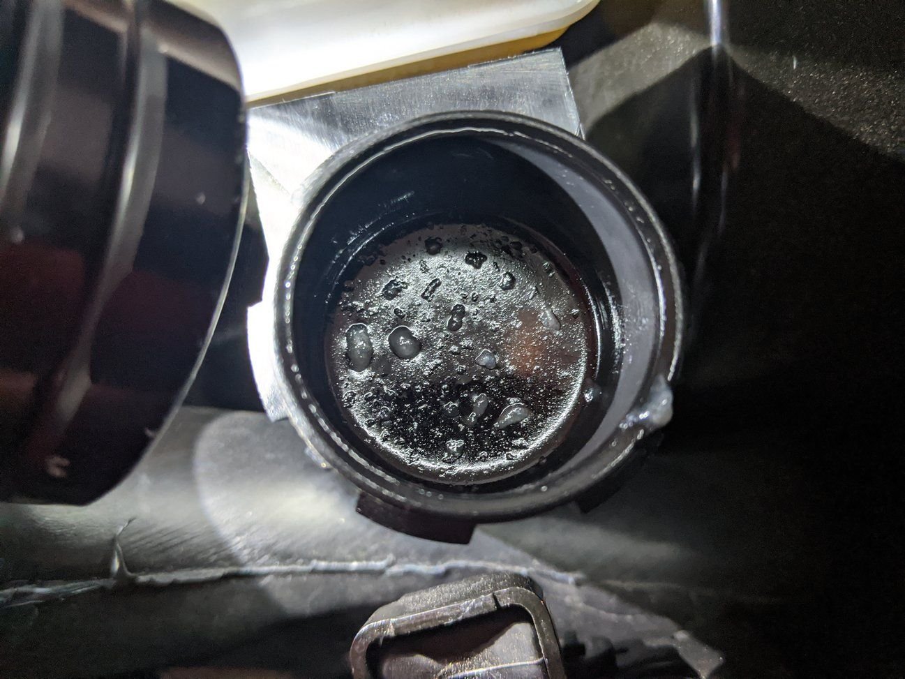

Well, I'm back. : )
Here we are more than 3 yrs later and I still have the issue with slime instantly showing up in my clutch fluid (after a simple ranger method). The dealer claimed to have done several vacuum flushes but I call B.S. because there is no way they got to the bleed valve in the amount of time I was in the waiting room.
They claim "there is a lubricant, maybe lithium grease" used in the assembly of the master cylinder and that is what it is. They literally suggest the ranger method and it will eventually work its way out. Well, that was like > 3 pints of fluid ago, and ZERO change.
I have Googled my a$$ off and cannot find one single picture of fluid that looks like this with slime in "suspension". If it were moisture or air you'd think I would have found other examples. I am totally baffled. I've attached a pic today after a ranger method and a spin around the block. You can see the slime just starting to form in suspension. Overnight it will settle to the bottom.
So, I'm about to bite the bullet and replace the master and do a proper bleed (uugghh) and see what happens. I cursed that bleed screw back in my C5 days and now I'm 20yrs older......haha.

My 1LT MN6 was manufactured 8/31/19 and I purchased it new on 10/17/19. The car is garaged, not driven in winter and has never been tracked. In July of 2020 at 2,800 miles I checked the clutch fluid and it looked like nasty cooking grease. I have no idea why or what GM filled it with. Never had another manual car with a reservoir that looked like this. I did the Ranger method using Prestone DOT 4 and have done it once a year ever since. It has remained clear and "normal" looking between procedures.
You're in good company - the fluid in my '19 Z06 looked sinilar when I checked it at about 3500 miles earlier this year. I used the so-called "Ranger Method" to clean it up and top-off the reservoir. I later found this variation on the theme that works even better... Move over Ranger Method! DIY clutch fluid flush tool.

Originally Posted by Torch-Red-Z06
interesting. Did it have that white slime in it as well?
No. The photos look worse than it actually was. When doing the Ranger method after 2-3 times of repeating the remove, refill, pump, repeat, the fluid cleared up and has been good ever since. I still check it and go through the procedure once a year.

I've read that the master and slave cylinders are packed with a considerable amount of assembly grease during manufacture and that grease is what ends up making the fluid look gross but is actually harmless.
Is it possible that leaving it alone is better for the components than changing it out and getting rid of the grease? Does the grease allow the fluid to feel spongy? I don't know.
Is it possible the grease inside the components at assembly time makes bleeding the system easier for the line-workers?
I change mine using the ranger method every couple thousand miles. I've done so on C5, C6 and C7 and never had a clutch problem.
