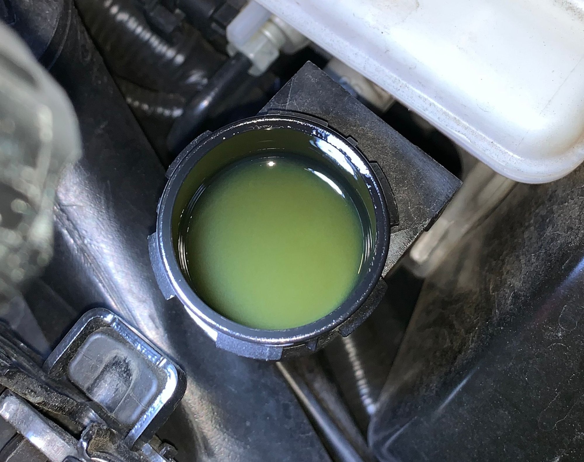

Last week I noticed a noise that sounds like the one here: https://www.stingrayforums.com/forum...ys-normal.html
I reminded me that I need to do the Ranger Method again (I've done it on a regular basis on my previous three Vettes). I have a container of 19299570 Dot 4 fluid (per the owners manual). I opened it in late November last year and it has been in the house since.
Anyhow, I do the ranger method, everything is nice and clear when I finish up. About 25 miles later it looks like this. I"m really surprised that got that bad that fast. It did NOT look like that when I opened her up to started the Ranger Method.
I sucked it out with the large syringe that I have and it looked clear so those aren't blobs of anything "gunky". My best guess is water or air bubbles that mixed and pretty much disappeared when I sucked it out. I've seen comments on the shelf life being weeks up to a year. I'm chunking the fluid and have a new container coming in tomorrow.
Does anyone have an experience with what causes this? My best guess is air but that is creepy. Where the heck is it coming from? If I'm lucky the fluid I used was garbage.

How does the clutch feel? Was the clutch fluid new and sealed when you performed the ranger method?

Fluid was opened previously.
Clutch feels fine.

Clean it out and chg it make sure you get all of the old out of it.

I'd probably get the system flushed. I have my dealer do it every-other year and its under 100 bucks.

I've done it multiple times on the my C5 but it SUCKS getting to that stupid bleed valve. Hmmm, trust the dealer or not. Scares me every time. I may come out with more issues than I went in with unfortunately.

Obviously I"m going to. I'm just curious if folks have ever determined if this may be air bubbles or the fact that the bottle was opened the first time like last November.
Anyhow, going to do a complete Ranger Method tonight with an unopened bottle and go from there. I put a remote bleeder on my hotrodded C5 that worked great.....I wish they made it easier to bleed the clutch the right way on these cars.

I agree from that but that crap I would flush it full system. Good luck on her but like the other guy has said if it didn't look per say like new I would do it every other year just to be safe on her. But if not every other yr 3 to 4 yrs for sure but if tracking the car other yr. Robert

Well, still looking for ideas. My car has been to the dealer as I was an unfortunate one who had a pilot bearing take out the torque tube input shaft. Needless to say, the clutch was bled bleed several times during that time at the dealer. I got the car back and it looked like this within a week or so. They thought maybe the cap was bad, letting moisture in, so the replaced it. Obviously that isn't it. They are talking to the factory trying to get more clues.
I've Googled a lot but can't find any pictures of fluid that looks like this. I can't be the only one with fluid that is "contaminated" like this. Seems it would be moisture or air, but if it was air the clutch wouldn't work properly but it works just fine.
Any other ideas out there?

Ok, went out and bought a Dot 4 moisture tester. Is it a POS, I have no idea but it does light off like a christmas tree for very high moisture.
Where the heck could it be coming from? There is no fluid loss in the system.

You're supposed to use DOT 4 fluids within one month of opening. Even your fluid in the bottle might be having too much water, now.

Understood. But this is fluid the dealer put in when they bled it. So it happened with their fluid too. This is my 4th manual Vette and 6th manual car and I've never had an issue like this.

That is sure some nasty looking clutch fluid in the OP's car. I wonder what is going on here?? I did my first Ranger flush of the year yesterday and the old stuff was nothing like the OPs. His might be contaminated with some sort of foreign agent besides just moisture?

Any additional thoughts/experience with where moisture can be coming from?
I replaced the cap and reservoir and that didn't fix it. : (
