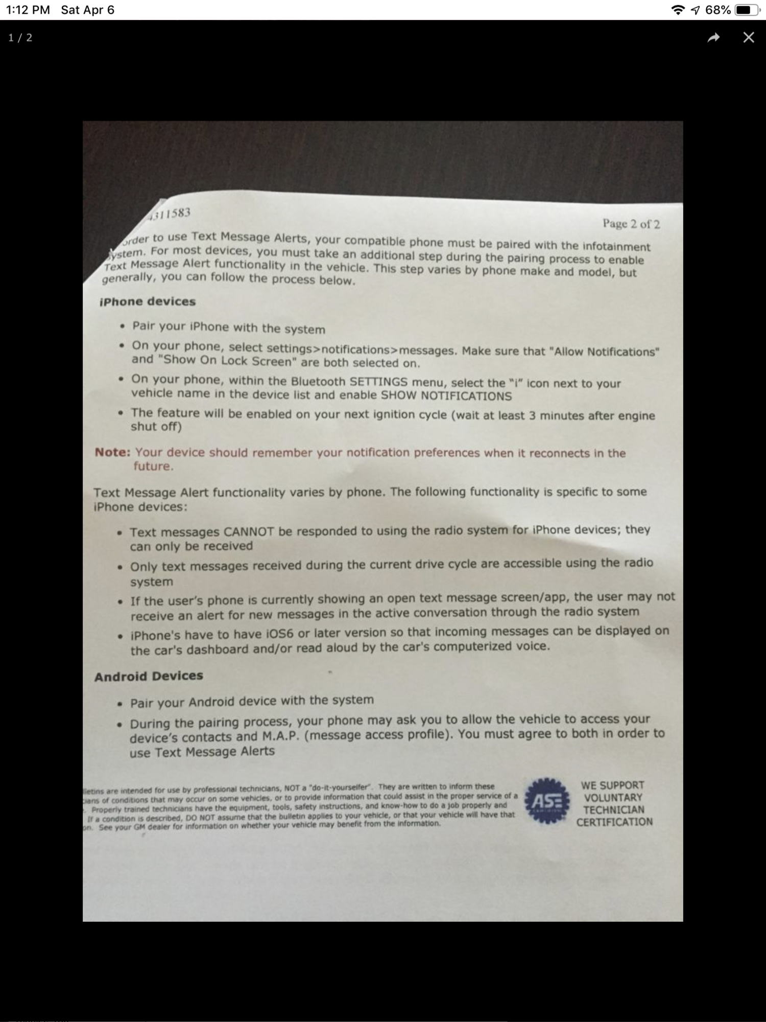

To get text messages wirelessly make sure your iPhone has these settings selected.
