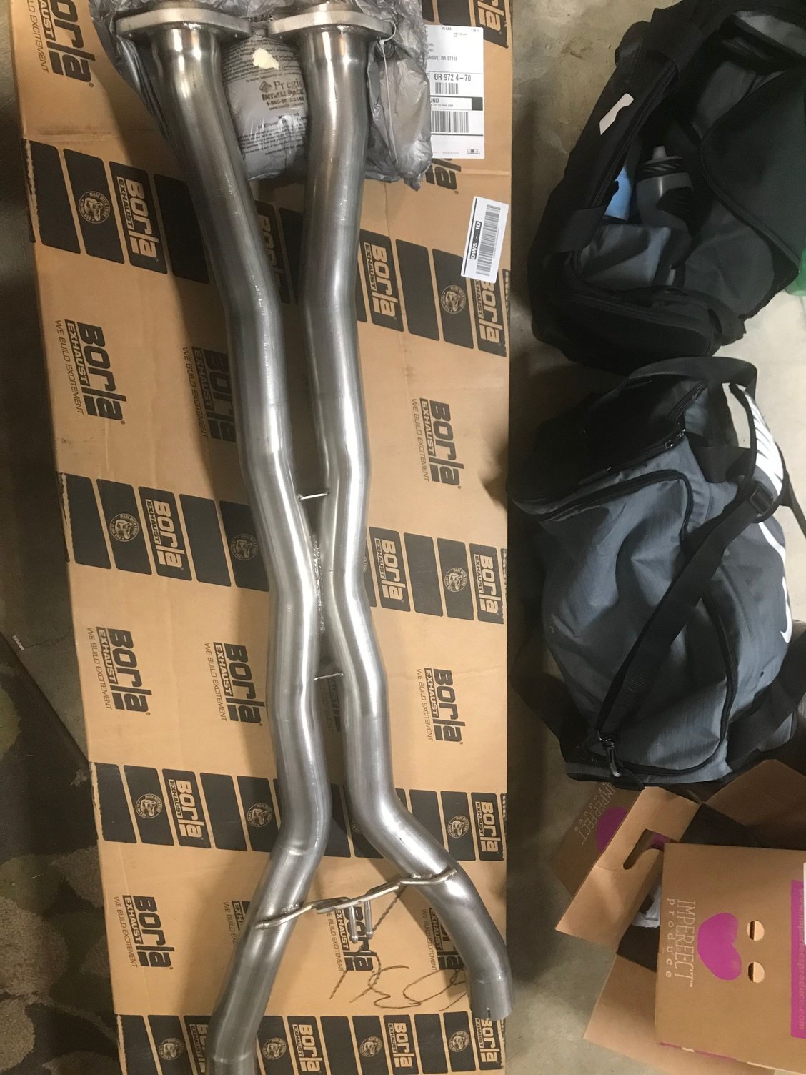

I would go with the two recommended brands (borla or corsa) because you know fitment will be spot on. I have the borla and fitment was perfect. Any x pipe will make the same power (you're deleting the secondary cats and running a straight through pipe) so airflow is going to be nearly identical for any x pipe. People why say one x pipe picked up more power than another are literally talking like 2 horsepower. And that can't even be measured accurately on a dyno under the most perfect and controlled conditions. In a nutshell, the corsa seems to sound a little raspier while the borla sounds a little deeper. Listen to a few videos and determine which sound you like better. You can't go wrong with either choice.

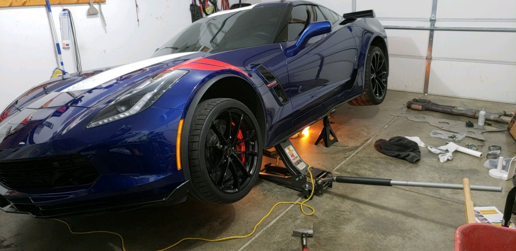

Default I did it
Originally Posted by saleen556
This post got me more excited. Just waiting to find out when I can get it on my Z. No lift and I’m not young enough to roll around in my garage.
hi, I did it on ramps, on my garage floor, in 2 hr, and I'm 60!!

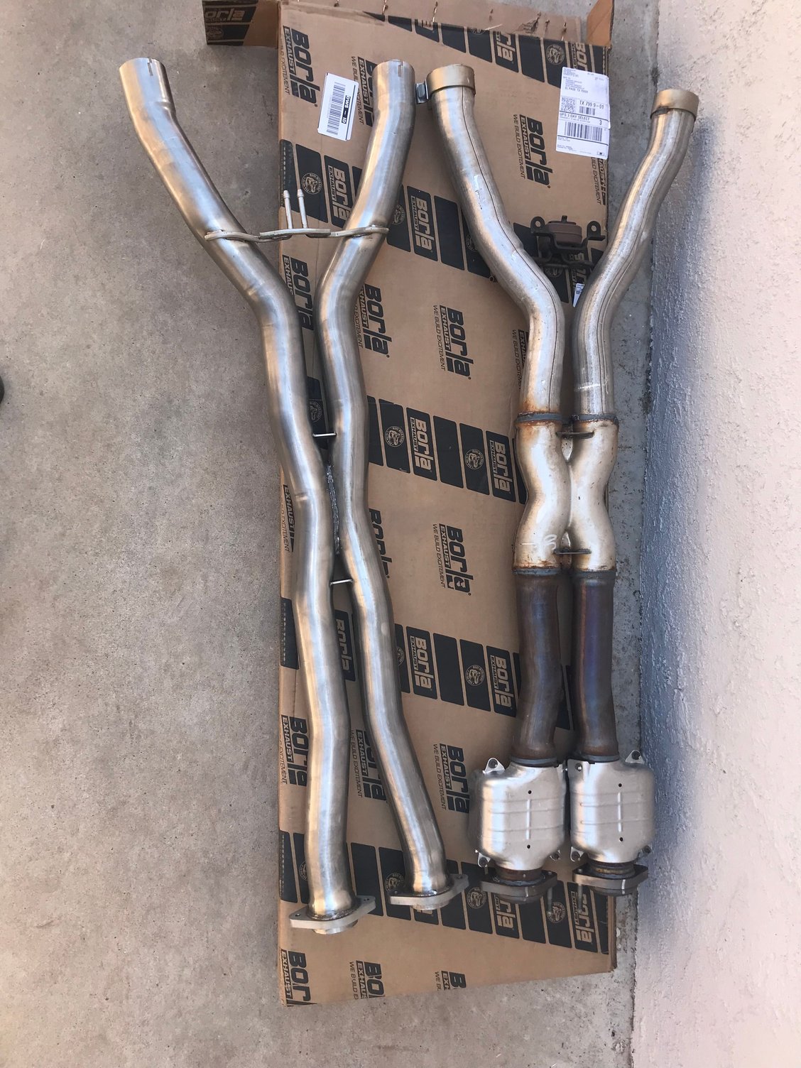

There is no engine control feedback loop post the secondary cats. O2 readings taken pre and post first set of cats only. The secondary set only act to further reduce greenhouse gas emissions
