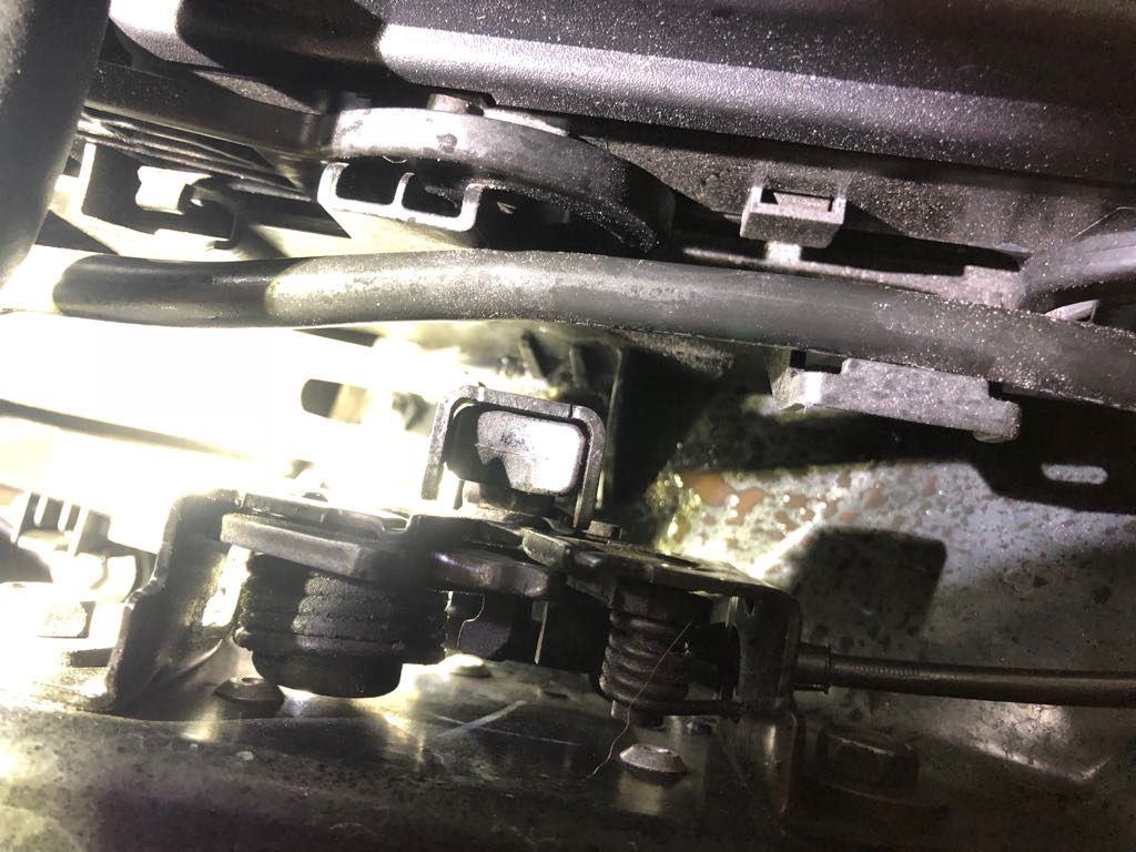

Sunday morning I went for a short cruise (20min) and when i came back home everything was fine. I stopped the engine 2 minutes to drop something and when i turn the engine back up it said change oil.
Then the temperature alarm started and steam start to come out from the hood. I stopped the car to let it cool but when I came out of the car the engine cooling fluid was all over the floor.
Any ideas?
Thank you

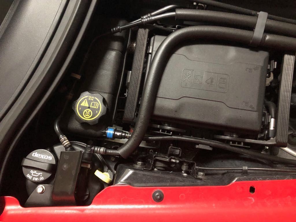

From looking at your pictures, it seems the coolant is coming from the passenger side behind the front wheel underneath the coolant reservoir.
Overheating for causes other than a coolant leak would cause coolant / pressure to be relieved at the pressure cap on the reservoir.
Also look at the obvious things such as fan belt is there, radiator and heater hoses don't show obvious leaks, bottom part of radiator (seen from above) not wet...

It'strange. But I suspect I suspect the oil coolant reservoir cap. When it' tight the cap still moving I don't know if it"s normal never opened it before. Is there a safety catch on the cap or clicking sound ? Because mine doesn't maybe when the pressure rise all the oil when through the cap ?
