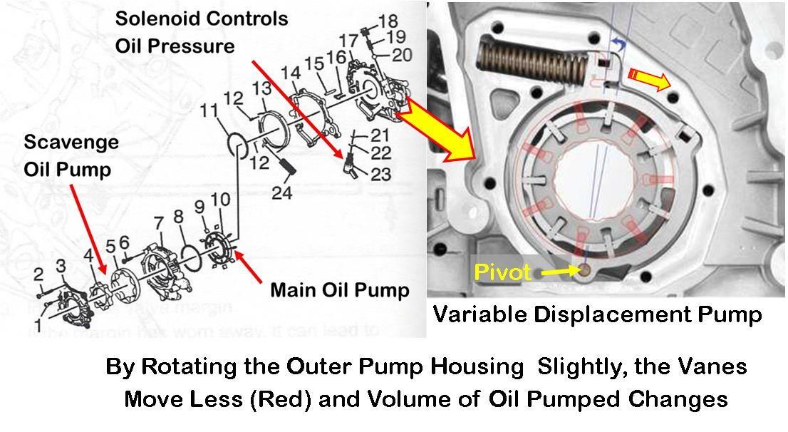

OIL PRESSURE:
The C7 is the first Vette to use a variable volume oil pump to save energy. That is what the pressure is lower and at time jumps form one level to another- it's computer controlled. The key is when oil does exceed 300 F it's not breaking down, Mobil says it can withstand much more than 300 F but the viscosity does decrease. That is why as LG Motorsports notes for all out racing as they participate in a 15-50 oil is used. Pressure are less than in my C6.

Another note on oil pressure in the C7.
First: The sleeve crank and rod bearings need much higher psi than supplied by the oil pump! Several thousand psi! But they generate their own pressure when rotating, by what is called forming a hydrodynamic wedge! The oil pump just needs to assure enough oil is supplied to the breakings. Oil viscosity is a significant factor in defining that pressure. However I recall when we were a sponsor of the Petty race team I asked Dale Inman, who was the team manager, what oil was used and he indicated something like a double 0 or some such rating. It was used to reduce friction. I recall I asked if that is good for engine wear and he said, "For the 500 miles we need!"
Second: The C7 changed the location of where it is measured to be near the end of the passage that feeds the crack. So it is the pressure after whatever pressure drop occurs in that passage.

As far as oil pressure, whatever the molecules look like, with the new “variable volume” oil pump the C7 and now many cars are using to save energy, 45 psi is sufficient and about what I see. The issue is the pressure will occationally jump from a low reading to high as it’s being controlled by the computer based on a number of variables.
As I noted, after the engine is started the pressure in the crank and rod sleeve bearings is a thousand+ psi., created my the rotating movement as long as there is oil present. The C7 apparently located the pressure sensing sender near the end of the bearing supply passage so even 40 psi means there is sufficent oil supply to that critical area.
