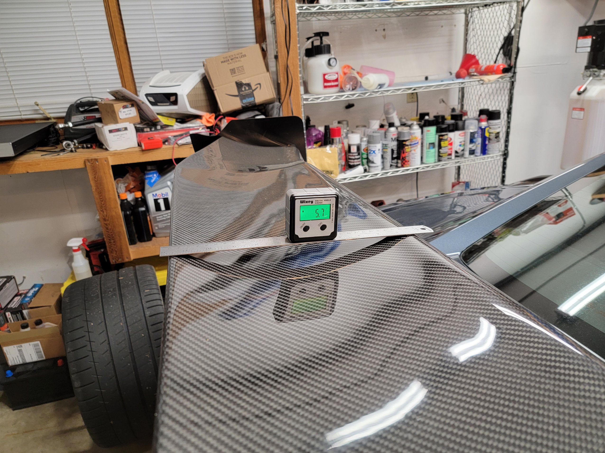

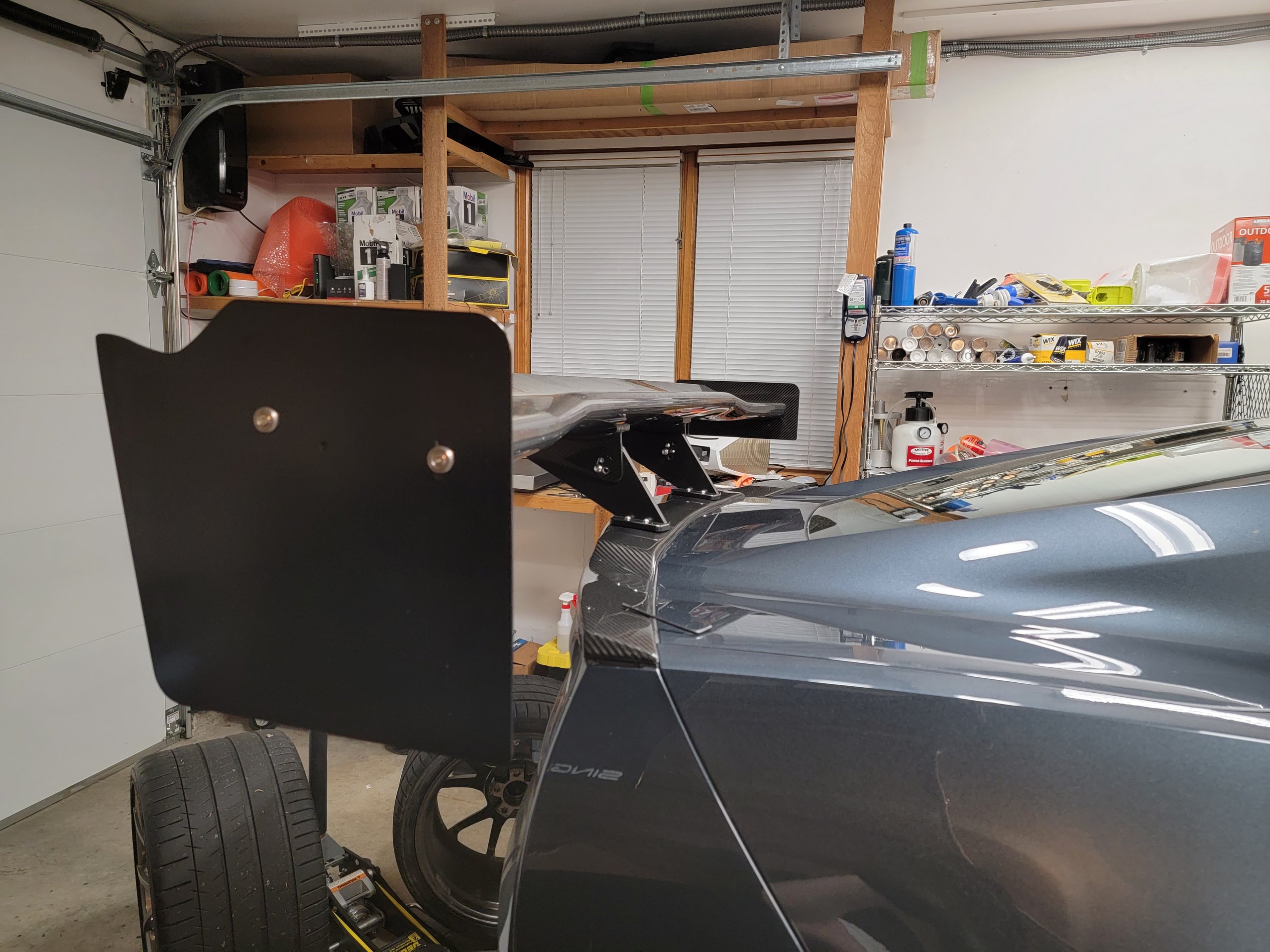

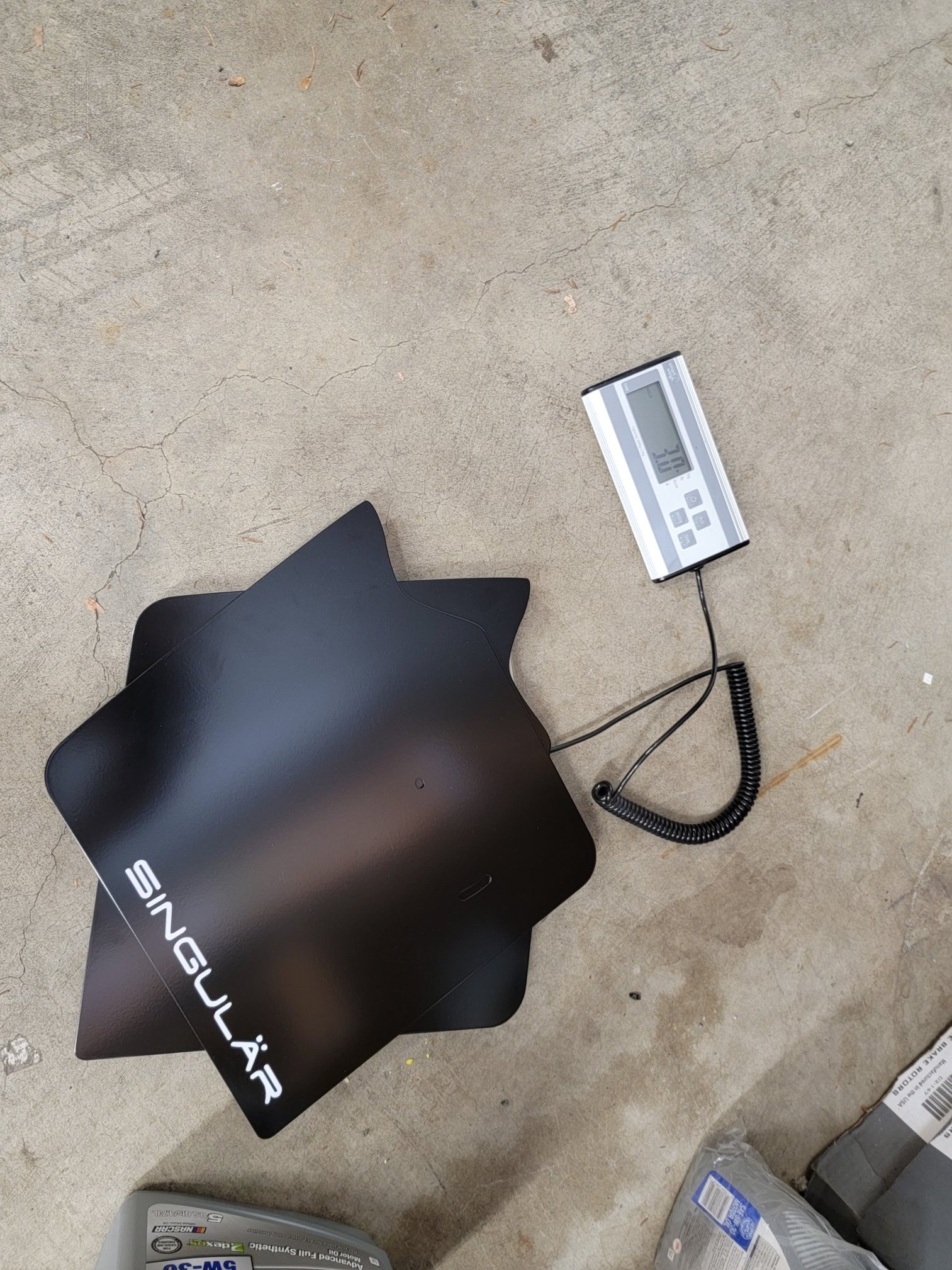

  • Received Singular side plates for the GTC-500 wing. These will supposedly reduce the turbulence by the end sides of the wing, making those sections more effective. When the wing becomes more effective, you can then get the same downforce with lower AOA, helping you reduce the drag.
  • Looks like GM will be fixing the original transmission by replacing parts (3rd gear, etc.). I got the dealer to ask about replacement transmission, but I presume it was not approved.
  • While the transmission is out, I decided to replace the clutch as well with a new unit. The dealer will charge only 1.5 hours for the clutch replacement. I am not replacing the flywheel, but also ordered a Monster clutch remote bleeder.
The side plate is considerably bigger than the original one.
They will instantly add 3 lbs of downforce AT EVERY SPEED. WIN/WIN : P
For comparison, the original side plates are cf (instead of aluminum), and weigh next to nothing.
NOTE: Their product description:
"Up to 40% increase in downforce on the outer 1/3rds of the wing – that is a 25% increase in overall downforce!
Raise your top speed! Add these endplates and reduce your wing’s angle of attack to achieve the same downforce as before with far less drag.
With the standard APR endplates, the wing is less effective near the outer sides.
These improved endplates were designed around real-world airflow and pressure data to improve the downforce and efficiency of your wing

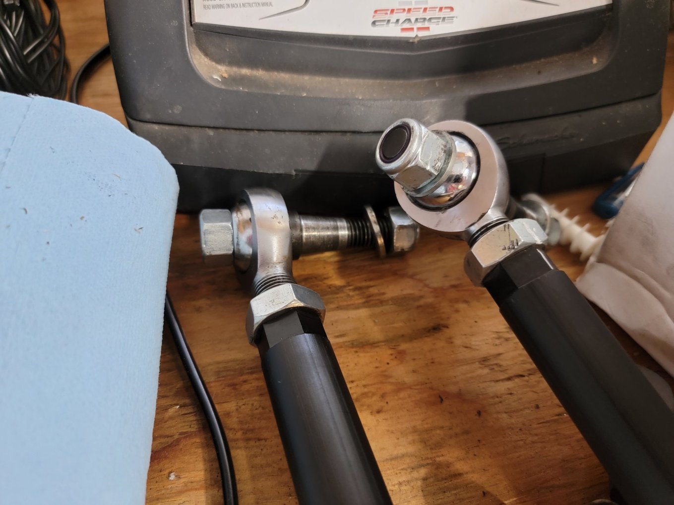

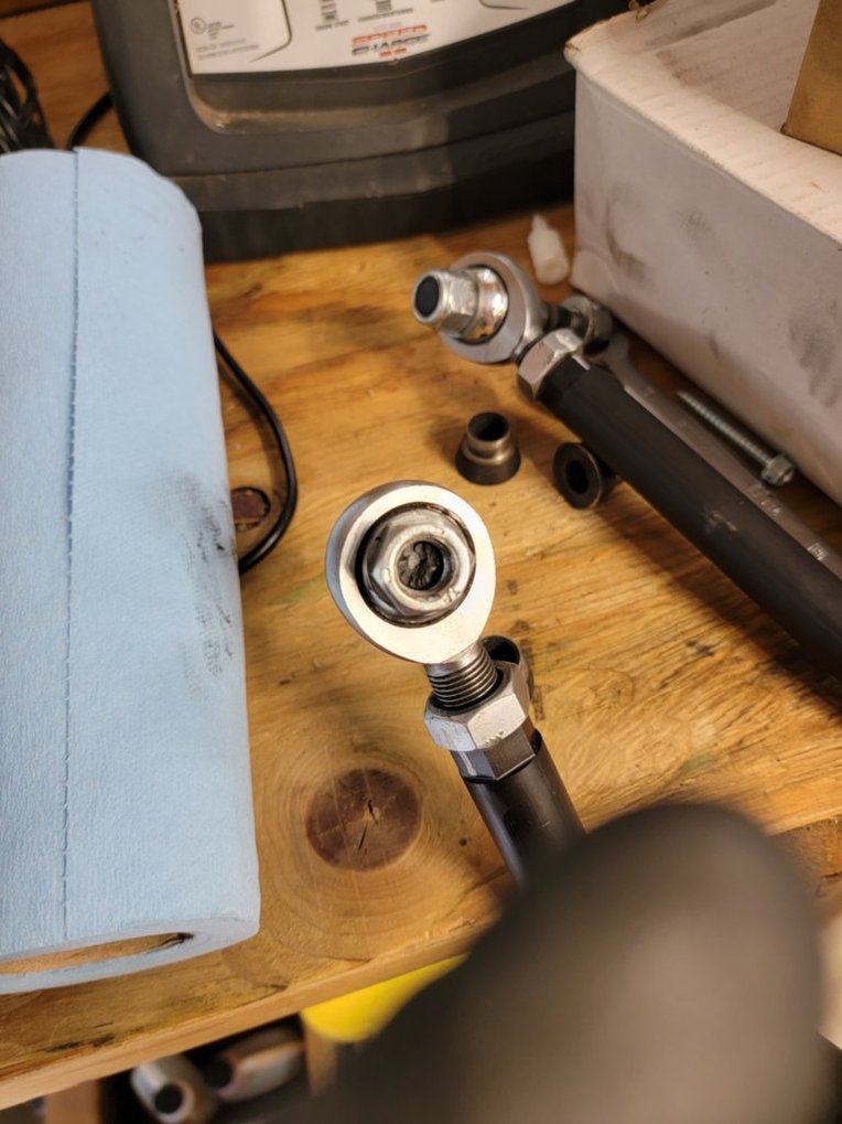

  • 1 of the rear Granatelli toe links is cracked per the dealer. I ordered a new set from LG Motorsports this time.

If you think about it take a picture of the cracked link. I got a 2s and love it!

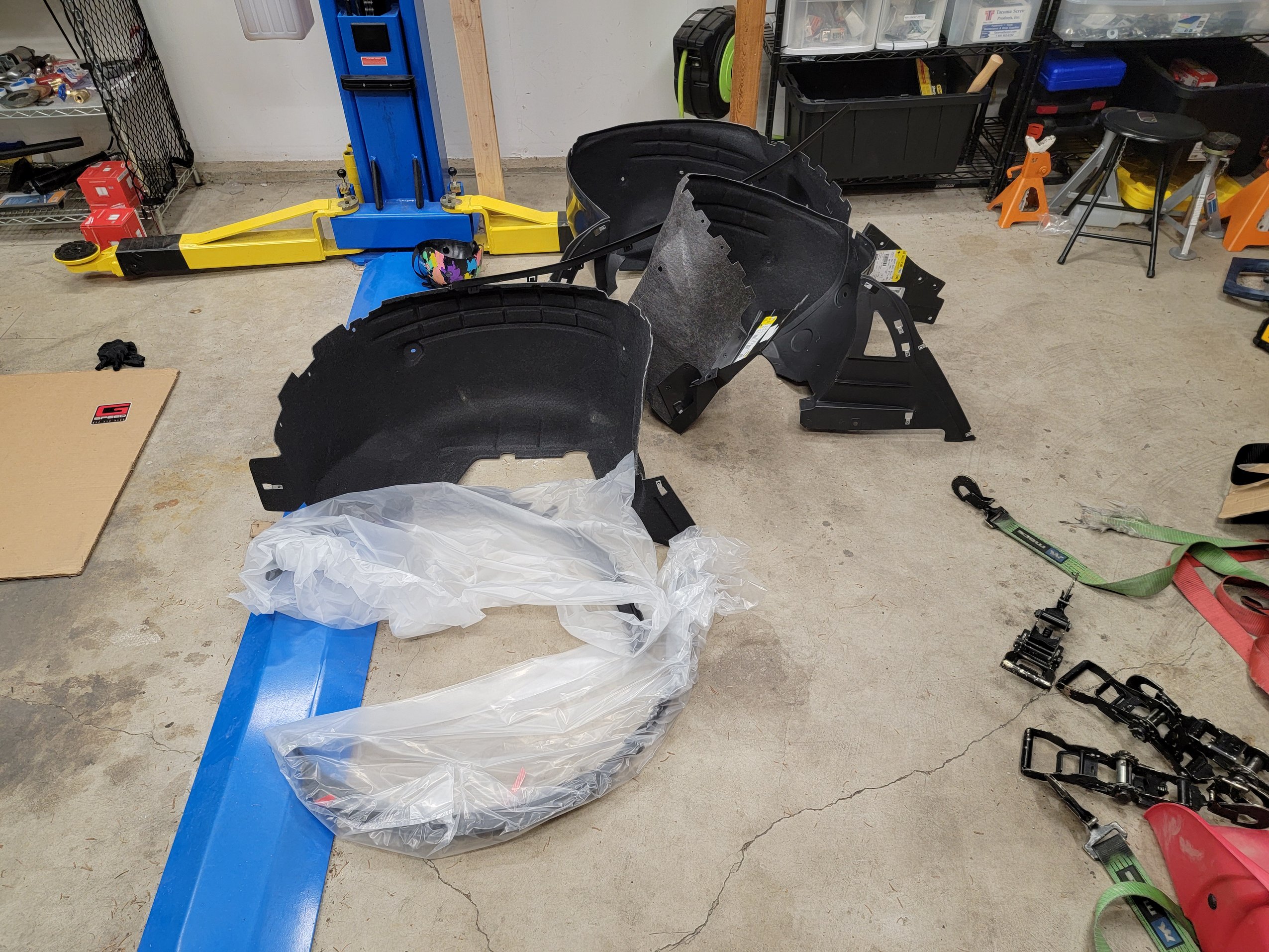

Update (4/25):
I received the new liners. Once I get the car back, I will also replace all the liners and wheel spats. With 0-degree rear caster, much less-flexible Delrin control arm bushings, and end of 335 front tire experiments, the liners will hopefully hold up longer. I'm tired of collecting rocks from under the liners : P

This is how the back of the conical joint looks when in good shape.
Looks like it sheared on the other side. The dealer said there was only 2 or so threads holding on to it, so they decided to ask me for replacements (I provided OEM links instead to save time).
My new LG HD links will be delivered, tomorrow. My alignment shop won't have time until next week's track event for the full alignment with camber kit (which takes at least half a day), but will install links and fix rear toe for me, to make it work for the time being.

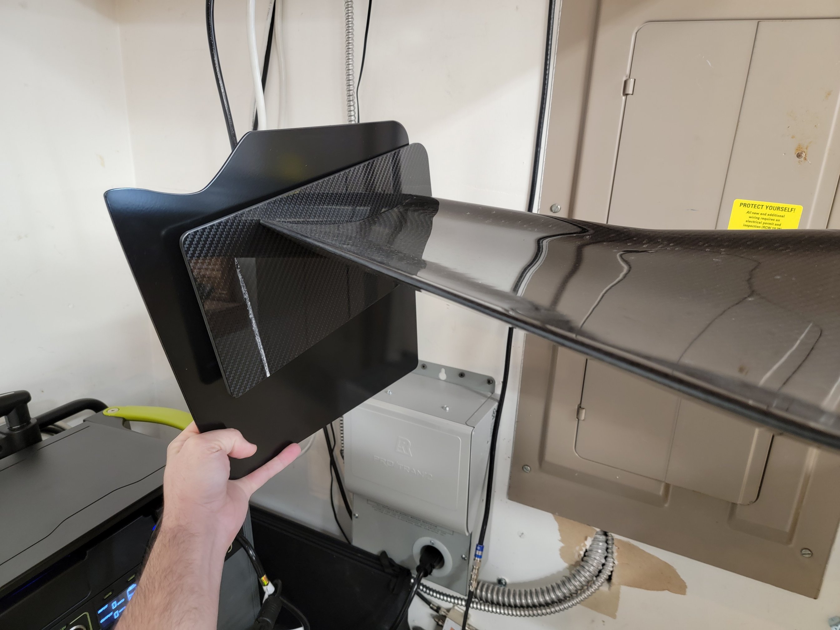

Decided to test out the car at the track close by on Saturday before I head out to Oregon, next week. I installed the wing back, switched to larger side plates, and also switched to Hoosiers.

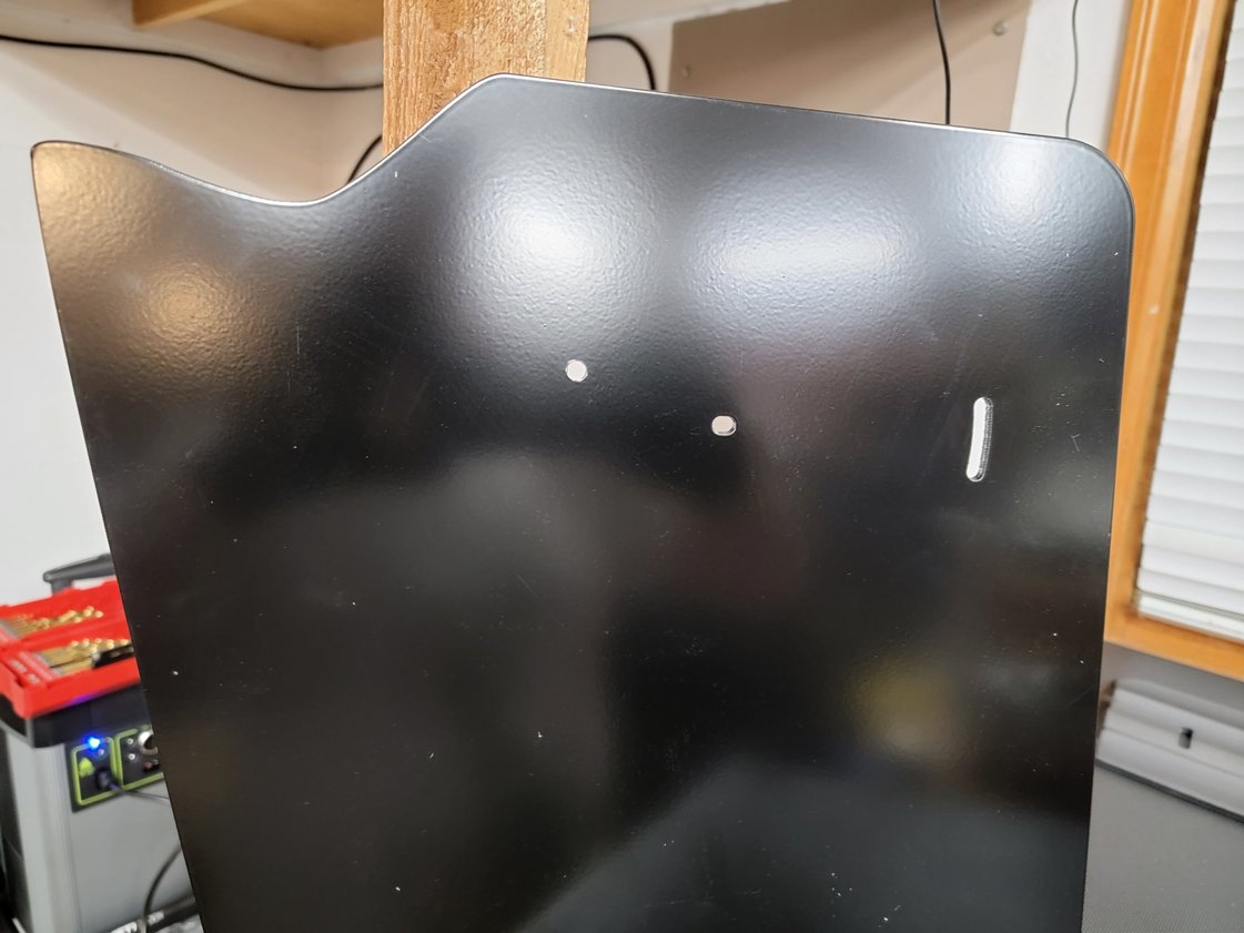

I had to drill a third hole since APR's hole locations have changed in 2020, and Singular side plates use the old locations.
This one compares the new side plate to the APR's original one.

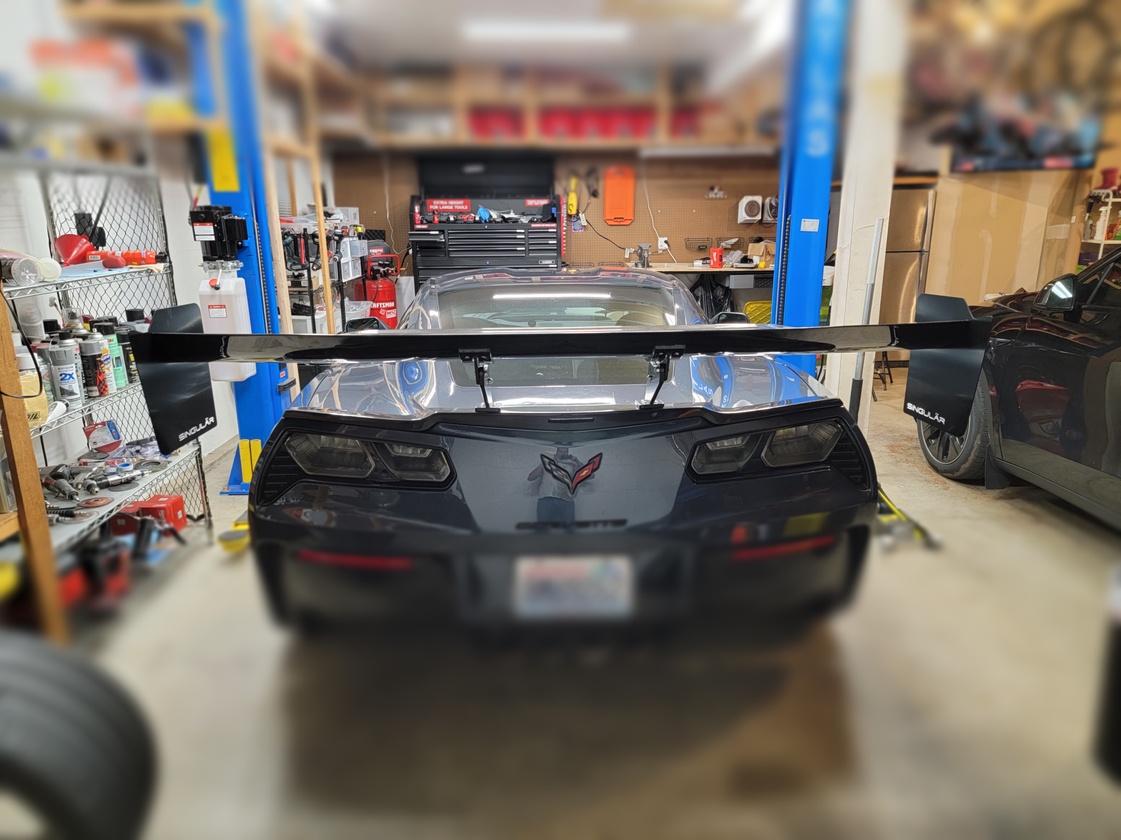

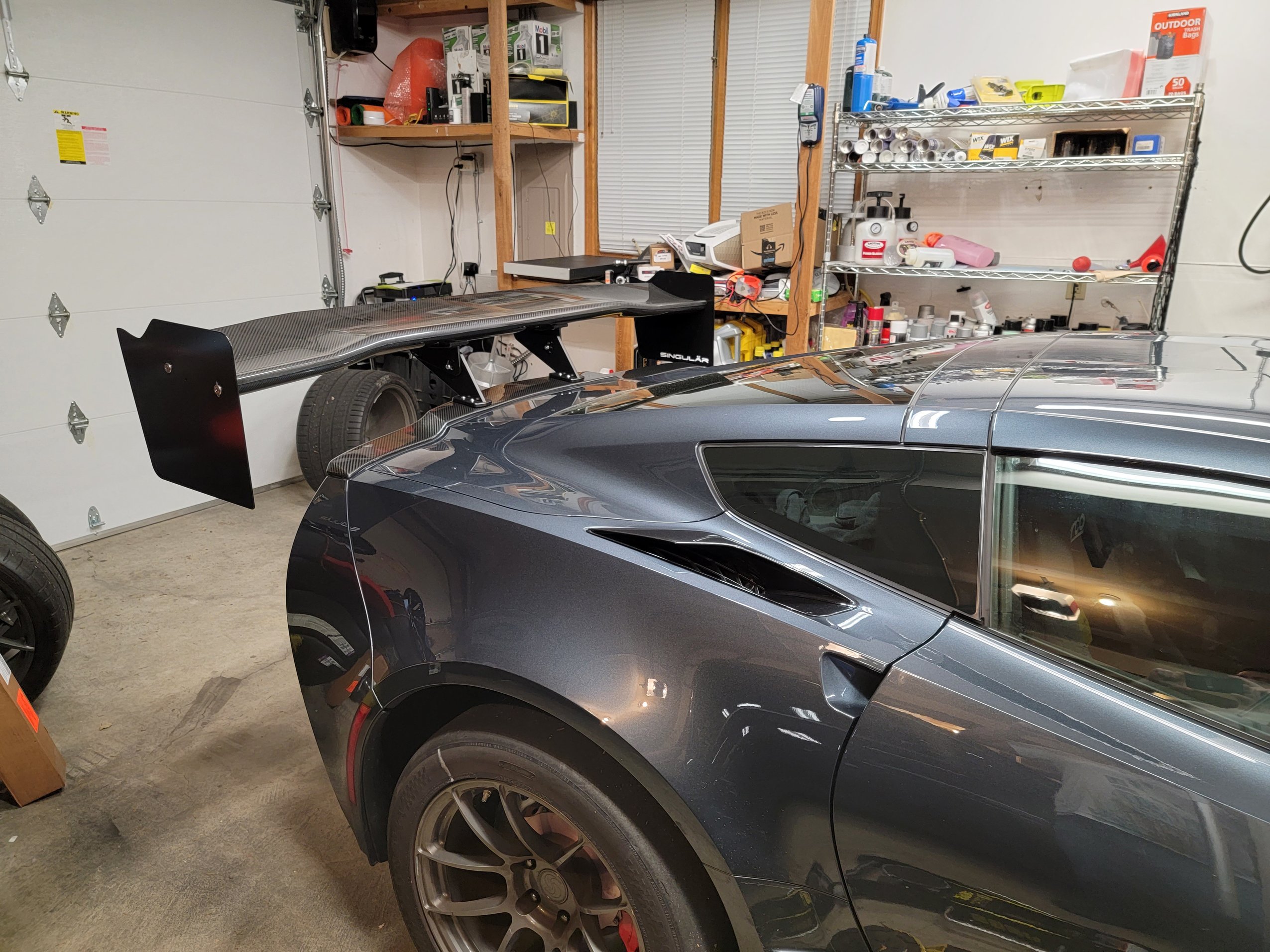

I'm keeping the wing angle low-ish, since I have not yet received LG's front splitter.
Finished.
