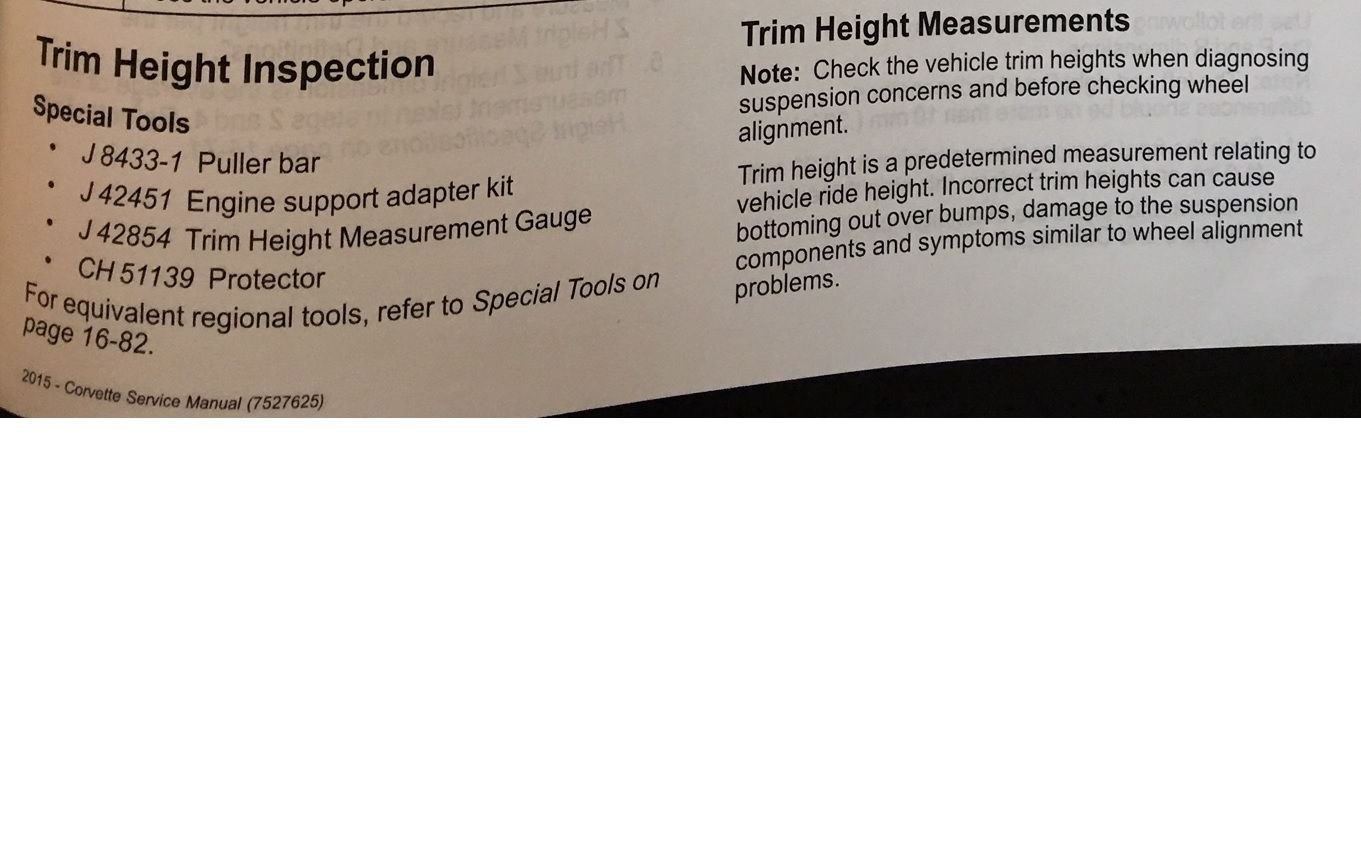

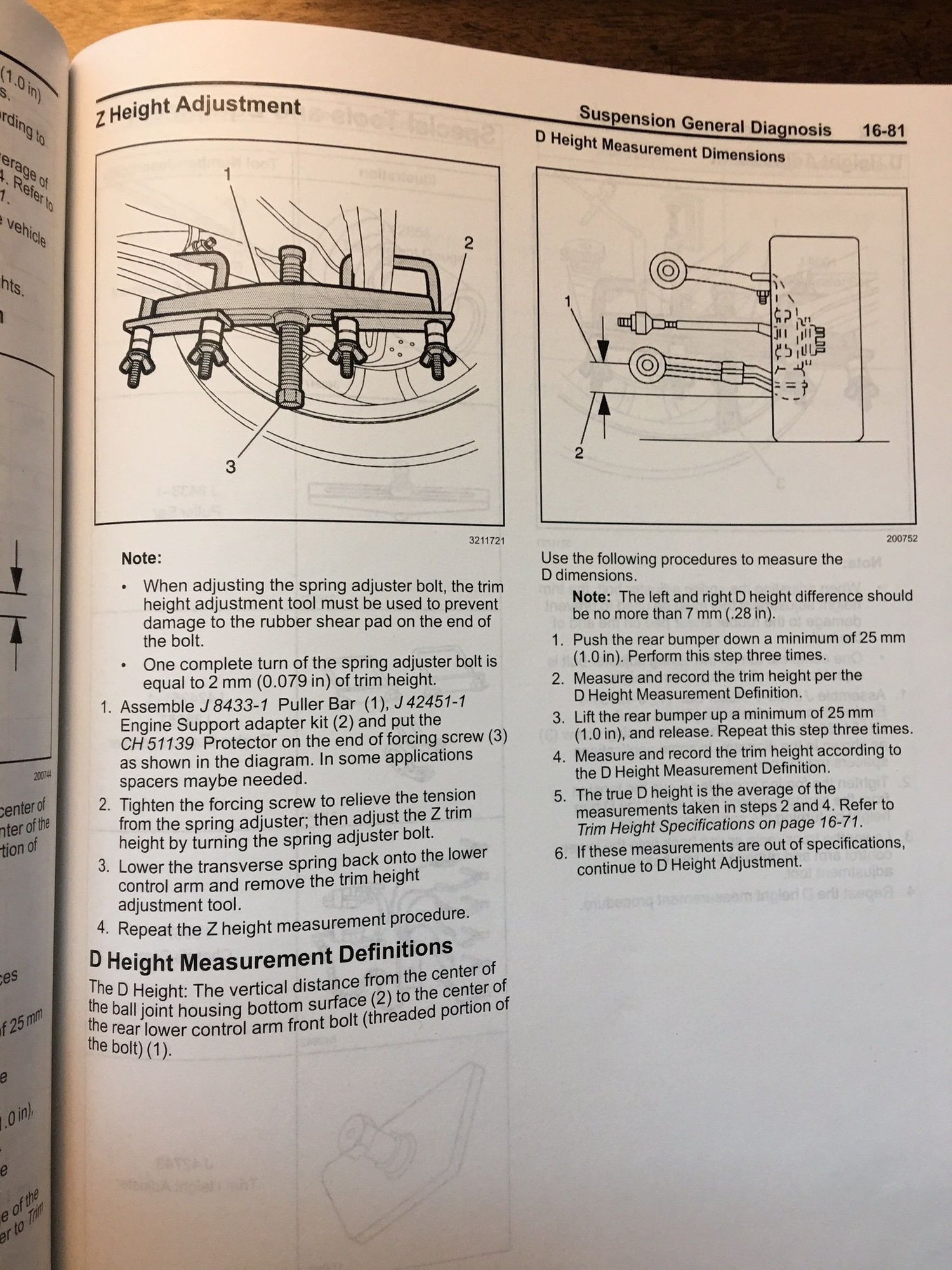

This help?

I raised my car back up on the stock bolts. Used to stock friends Z06s as reference for measurements. Taking the measurement from center of the wheel well to the ground on each corner and visibly counting all threads seen on the keys. The manual posted is the best guide you'll get! An get an alignment after any sort of suspension change. I know mine was jacked up after lowering it. And raising it back up.

Everything you want to know about Trim Height:
The method using the GM tools on the LCAs is more accurate.
Bill

Thanks. The P and R measurements table was a great help. I had just raised it to what looked reasonable. My front ended up right in the spec. I have to raise the rear a little more. The front to rear rake was a little more then I would have expected based on the spec.
