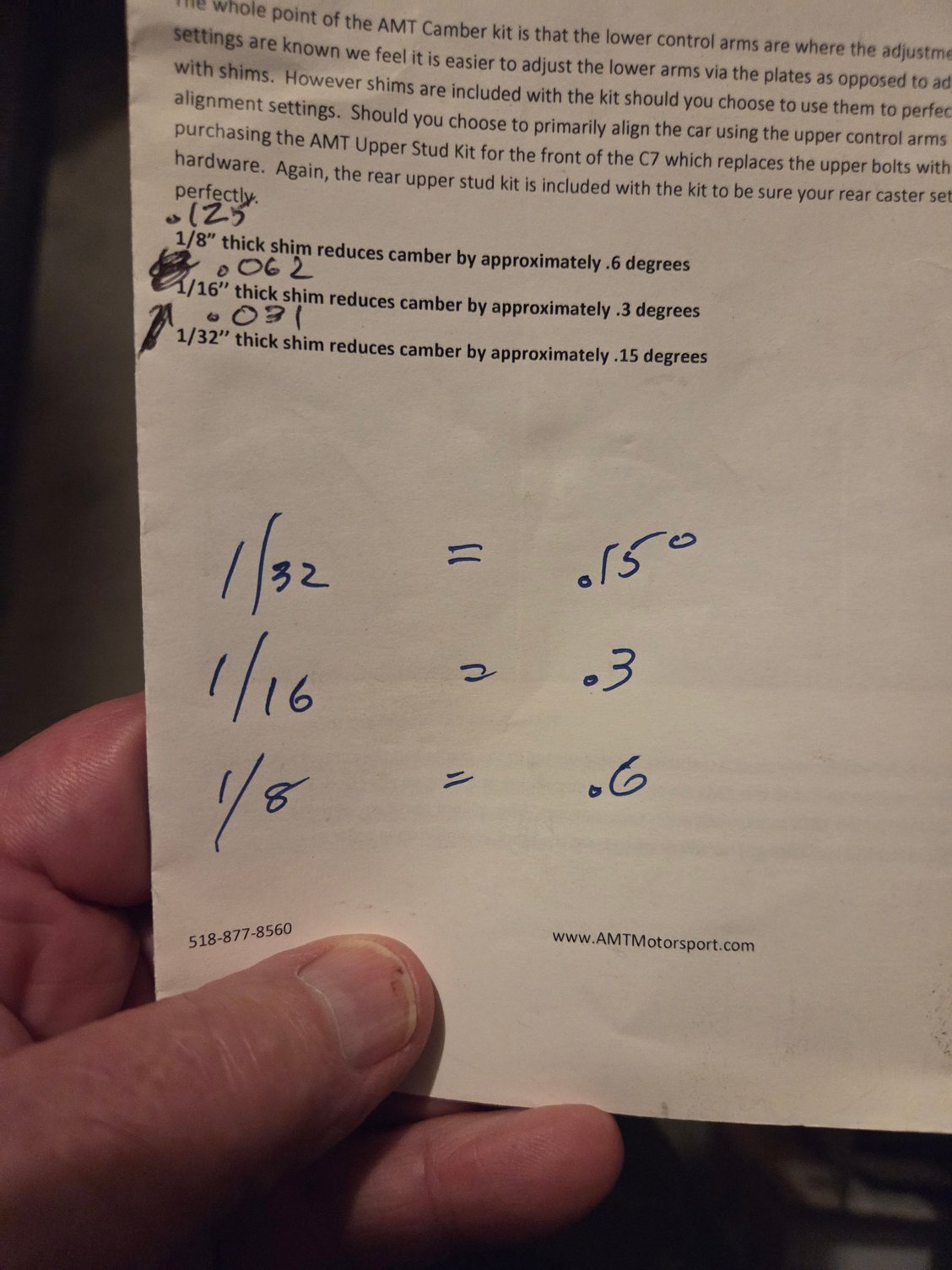

AMT camber kits include a chart that gives camber change per shim.
Sure wish I knew how to make these pics smaller like most other forums.

That will be very useful to some people, but I'm still trying to figure out what part of my rear wheel arches to measure for ride height (post #22).
