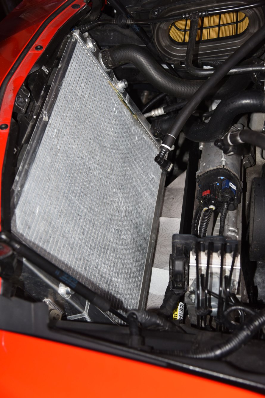

My aluminum radiator definitely has a leak, somewhere where I cannot see it -- i.e. it's not visible from the rear, but with a 20psi leaekdown tester in place, I'm getting multiple drips of coolant after 10-20 minutes (when cold). So the radiator has to come out :-(
The paper towel down under the radiator serves as a tell-tale that it is leaking. Sadly, they are not staying dry. There is also an epoxy-type fix on the right middle edge of the radiator, it does not appear to be leaking there ...

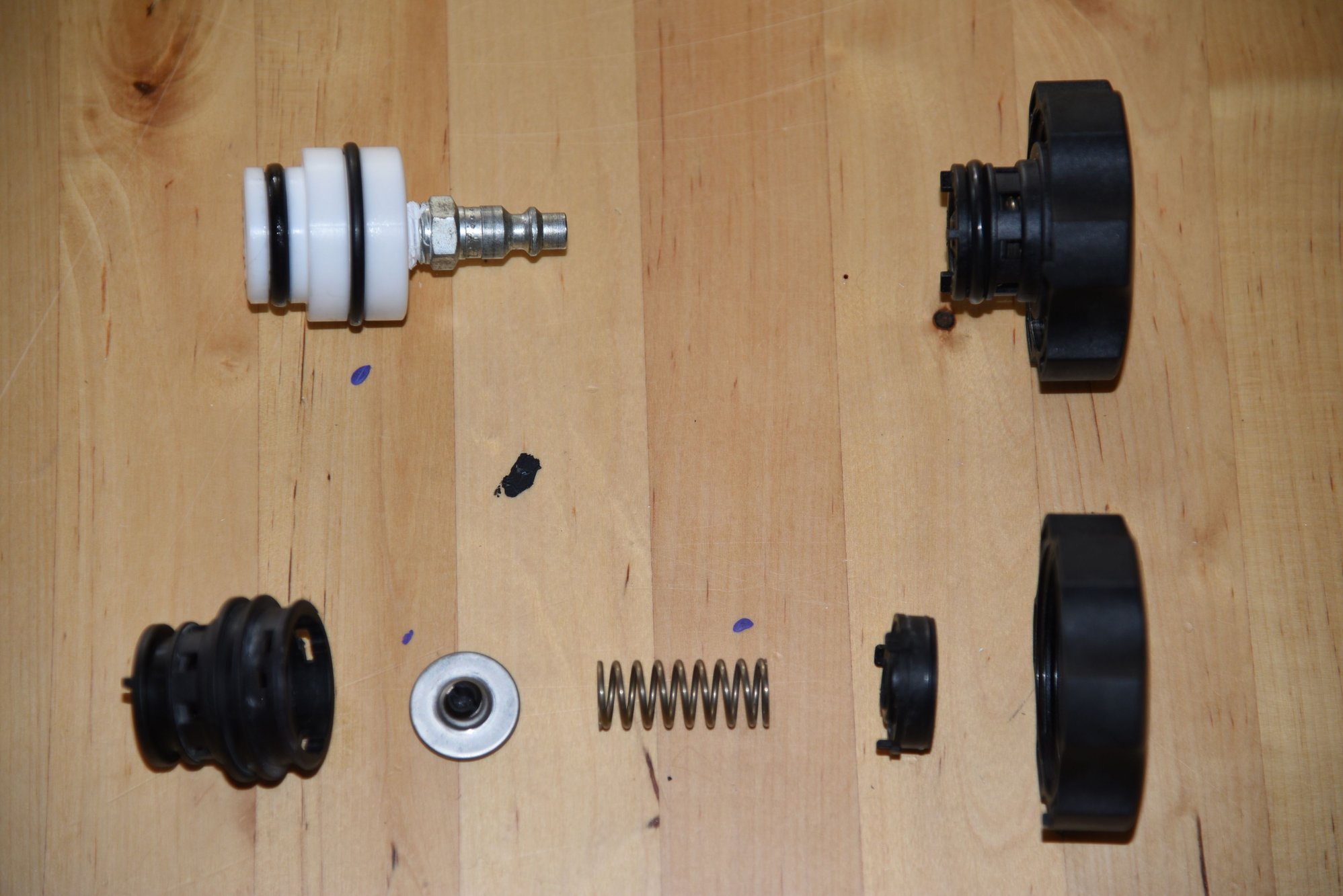

As an aside, I made a leakdown tester adapter for the coolant tank cap:
Leakdown tester and coolant pressure cap adapter used to pressurize the coolant system to 20psi. The adapter goes where the coolant pressure cap went, and is held in place by a gutted original cap with a hole in the center of it.
The coolant pressure cap is kind of interesting -- it has two O-ring seals (lower and upper). The lower one seals the overall system. There is a pressure valve (and atmospheric pressure) above this, and the valve will open if 20psi is exceeded. If this happens, coolant passes upwards where it is stopped by a second O-ring. "In between" these two O-rings is a kind of exhaust vent that is in the inside front of the mouth of the radiator surge tank, down low in the bore. I'm not sure where the passage leads, should be to a hose somewhere so that overpressure coolant will dump to the ground. To make an adapter, I machined some Delrin with the right O-ring grooves, and took the O-rings from an old radiator cap. Technically, I only needed the lower / smaller-diameter O-ring. I drilled a 3/4" hole in the center of an old cap (after I popped off the valve assembly), and that secures this adapter plug in place.
On the top is my adapter and a complete cap coolant pressure cap. Below is a complete coolant pressure cap, disassembled. The O-rings from the disassembled cap have been moved to the adapter.

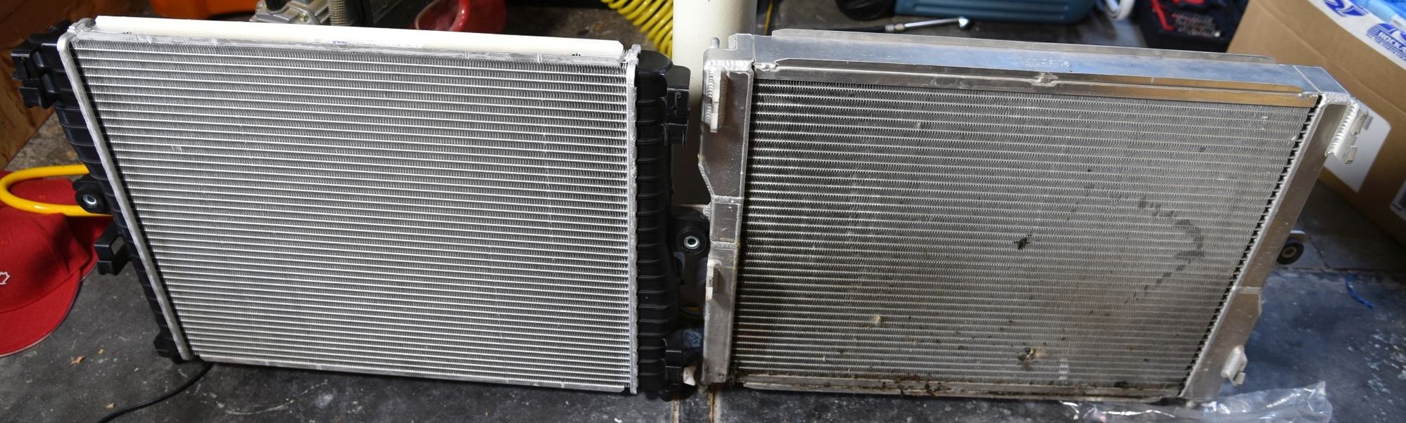

The Ron Davis radiator is much thicker (and noticeably heavier) than the stock radiator.
Stock plastic tanks + aluminum fins radiator on the left, Ron Davis all-aluminum on the right. The stock one costs 15% of the other.
The Ron Davis radiator (on the right) is all-aluminum (tanks and fins), and is much thicker than the stock radiator (on the left)

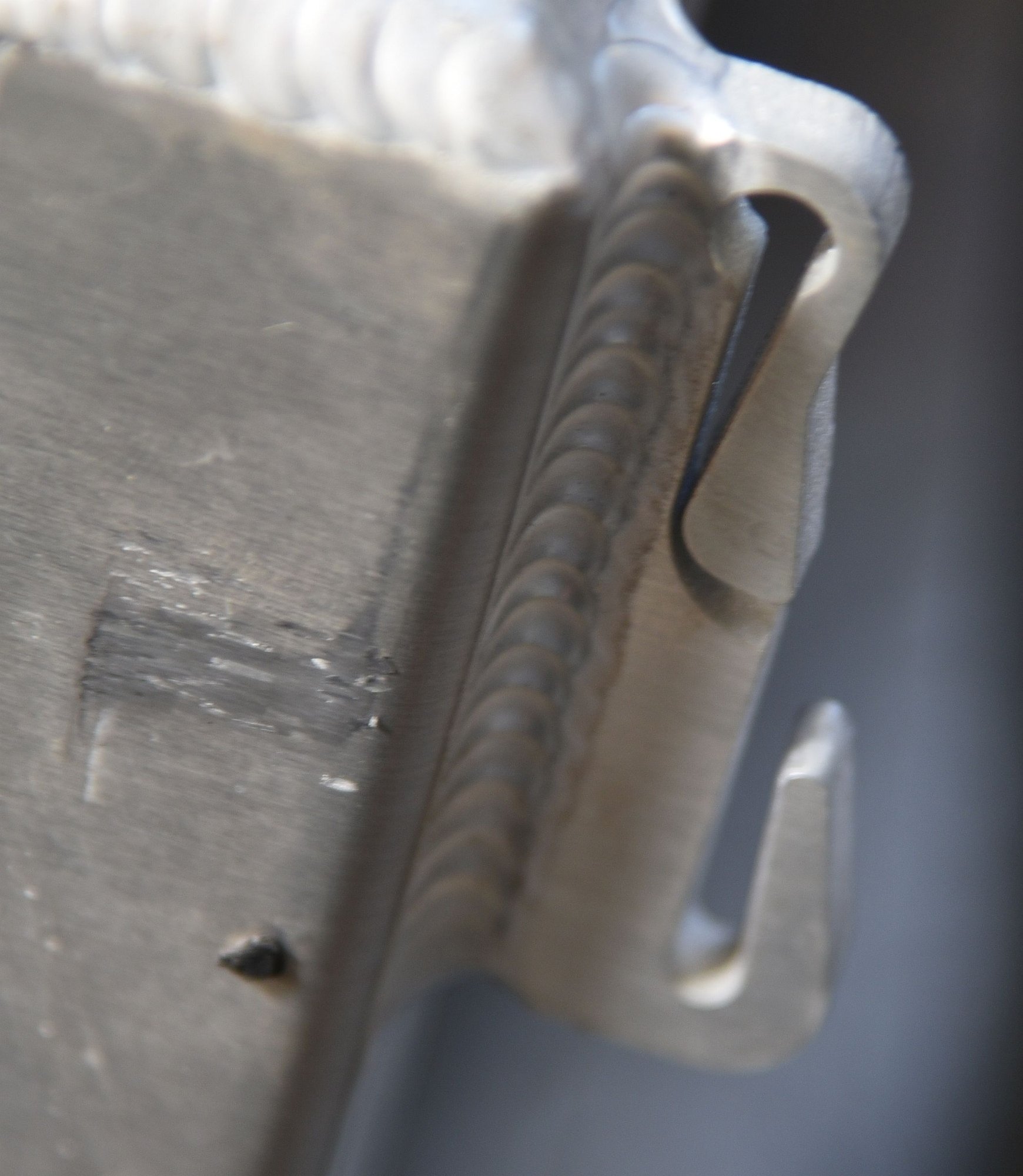

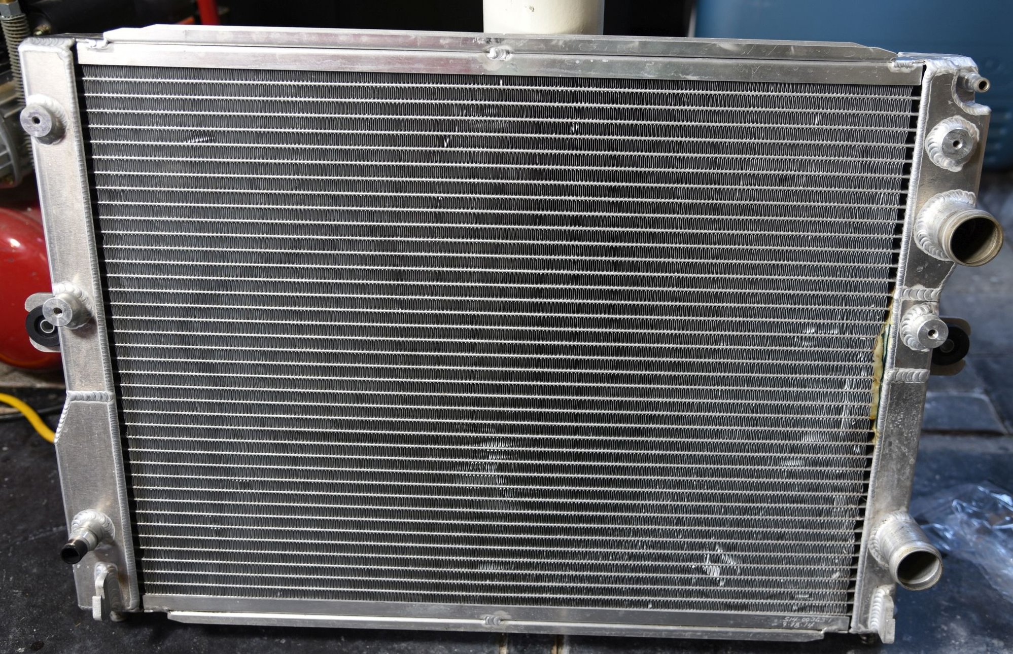

The fan side of the Ron Davis radiator. This is a very heavy-duty, very nicely TIG-welded radiator. You can see the 2014 build date stenciled to the bottom right corner. Note that the main outlet is on the passenger side (stock is on the driver side), and the fan and shroud mounts are via threaded (aluminum, of course) bosses. Dunno why there is black discoloration on the output to the oil cooler. You can see the repaired area on the right side, mid-height -- that repair appears on both sides of the radiator, and is where it's still leaking, as best I can tell.

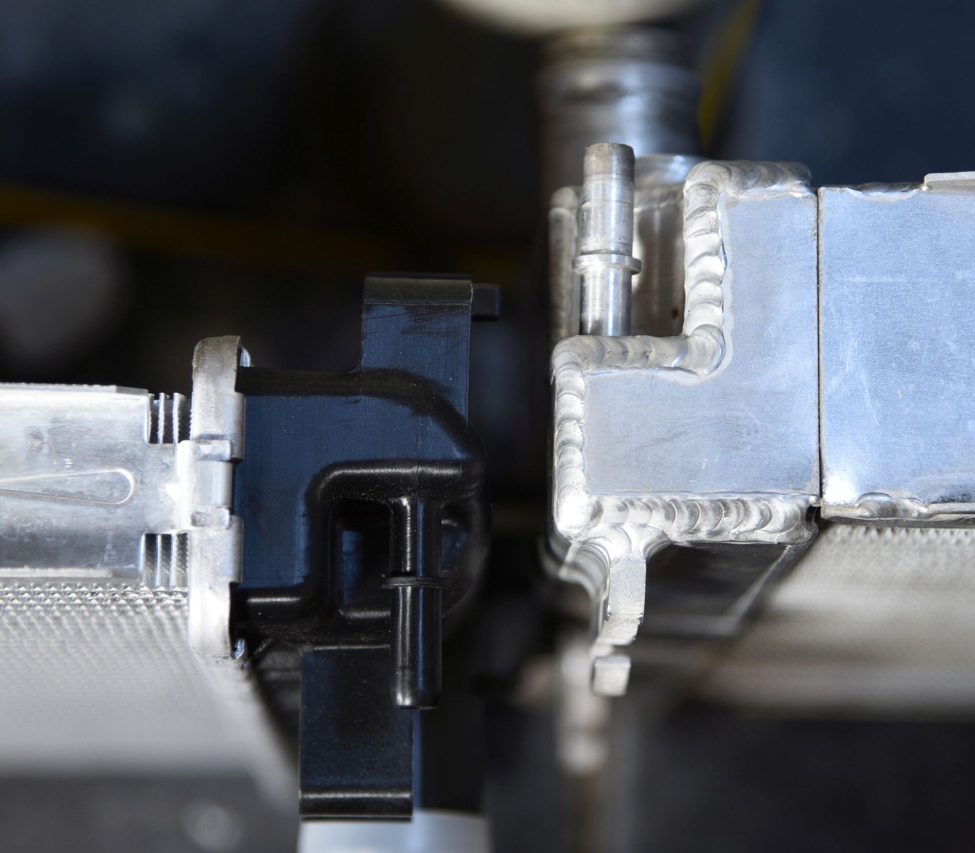

An upper A/C condenser slot + clamp on the Ron Davis radiator. Water-jet (?) cut relief for the A/C condenser tab tensioner.

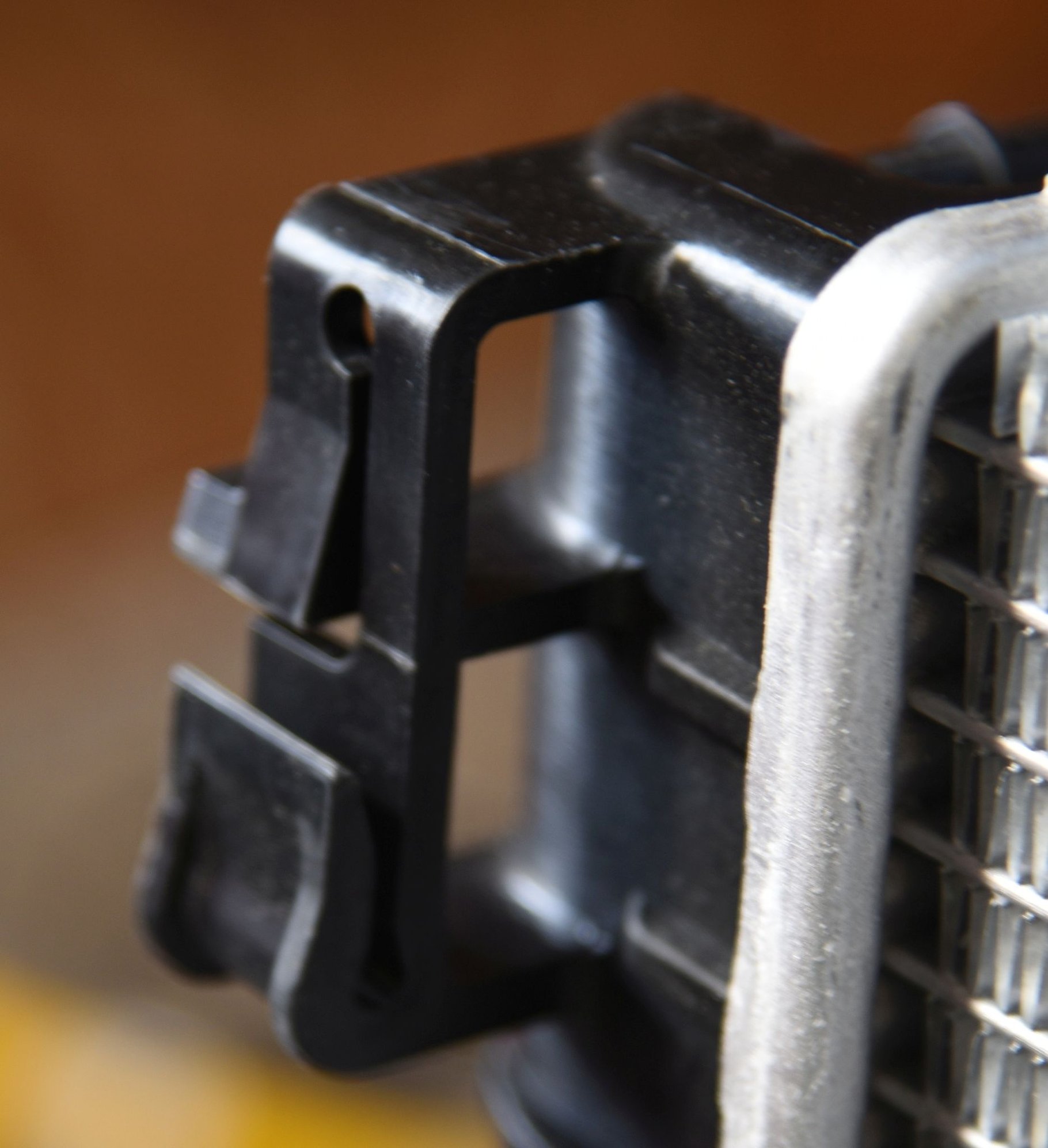

Here's the same feature (how the A/C condenser tabs are secured) on the stock radiator.

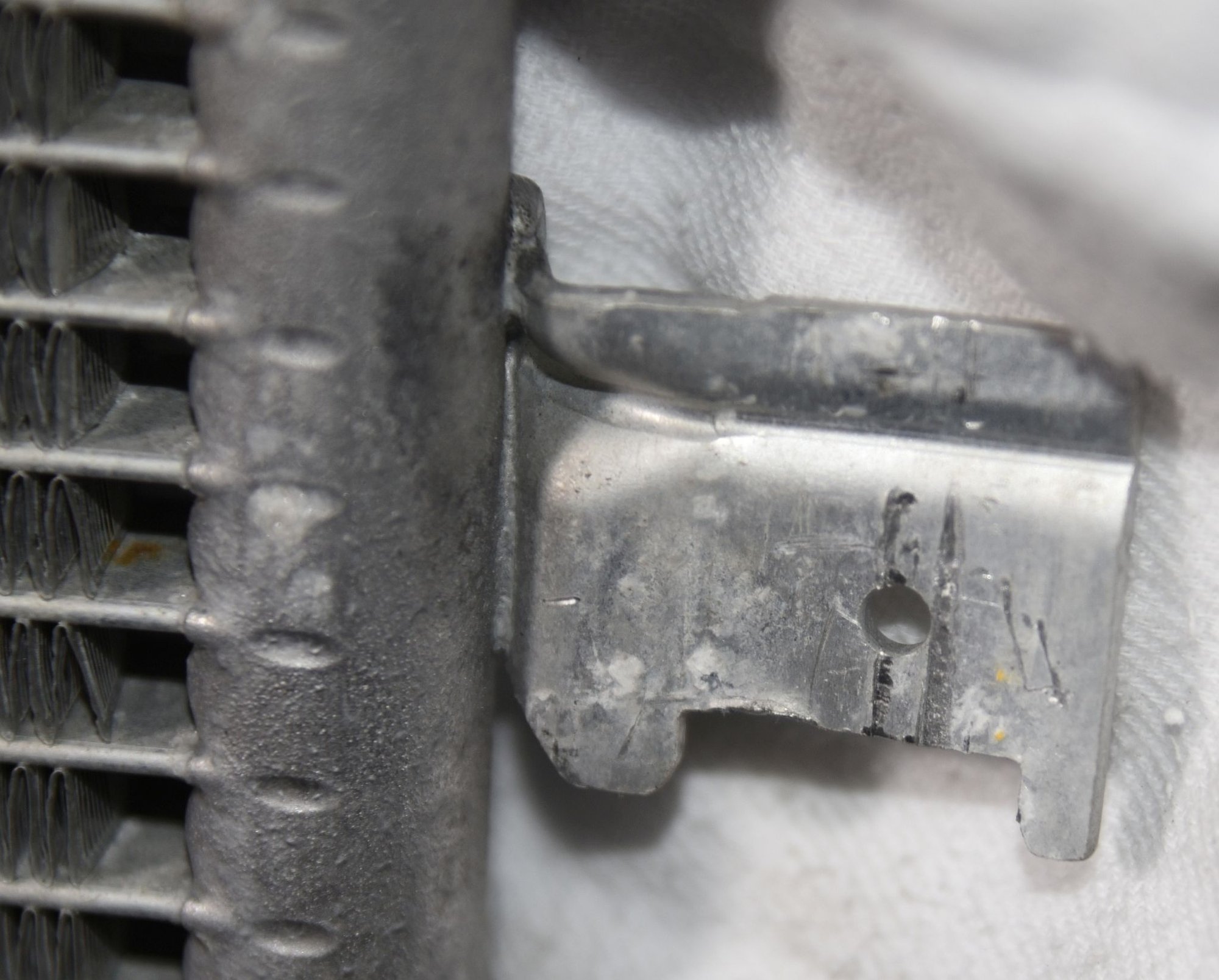

Here's the upper passenger-side tab from the A/C condenser. Notice that it is scratched and somewhat bent in the middle. The scratching is probably from Al-on-Al contact with the Ron Davis radiator (and is not a big deal). The bend, OTOH, made it much harder to disconnect from the Ron Davis radiator, because it was "sticking" in the tab slot. I straightened this out, and it popped right into the stock radiator.
I am the second owner of this C7, and it was under the previous owner's watch that the Ron Davis radiator was installed, to solve the usual on-track overheating problem. Unfortunately this particular radiator had a leak; a repair was clearly attempted at one time, but it still leaks under pressure. I will contact Ron Davis and see what can be done to get it fixed properly.

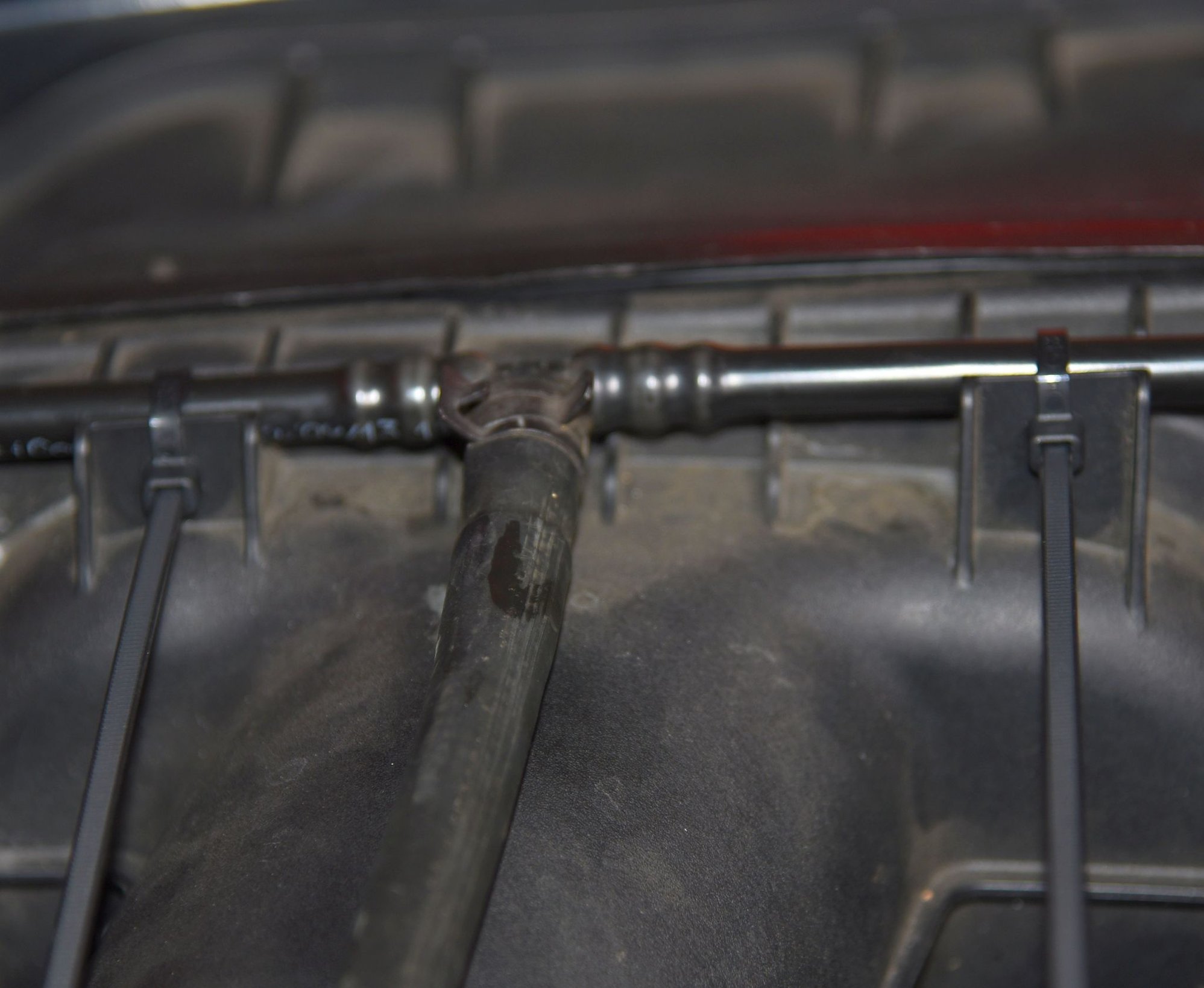

I also made a small mod that I find very useful -- I drilled two 0.250"-size holes in the body of the air filter housing, to accommodate tie-wraps that will hold the surge tank hoses in place (mine were always popping off).
Holes in air filter housing enable me to keep the surge tank hoses in place. Yes, I cut the extras off after this picture was taken.
