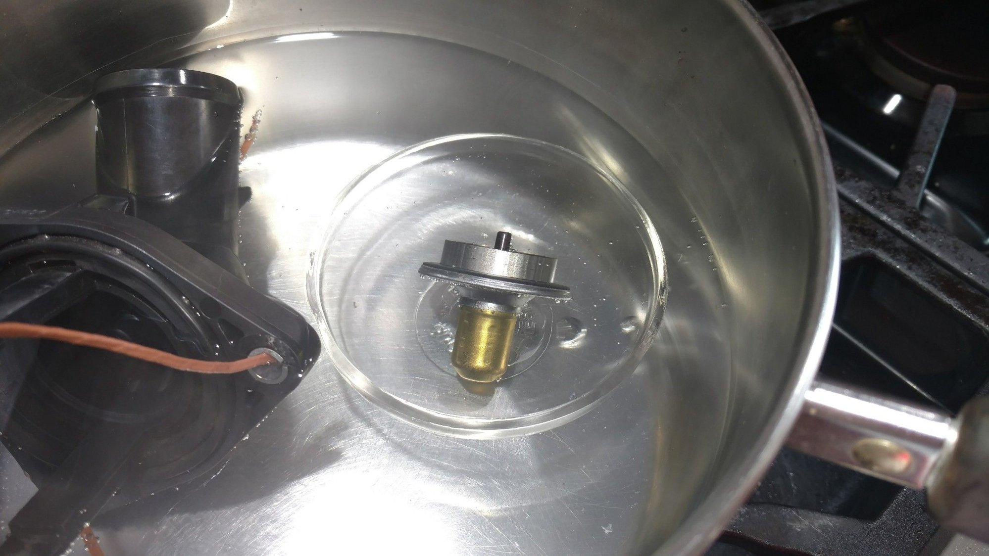

Test 3 (inside): At home, I tested the old thermostat (which exhibited the same problems):
  • At rest, the 4mm diameter tip of the thermostat bulb is around 1.5mm proud of the "circular wall" that surrounds it.
  • I could not clearly see the temperature at which the bulb tip started moving, BUT
  • Immersed in 204F water for 15 minutes, the bulb tip had extended to around 6-7mm above the "circular wall" that surrounds it.
I'm attaching two pics of the thermostat (the housing body is also in the pot, to hold the two thermocouple probes in the water). In the image of the thermostat, I took the picture at exactly right angles to it, so you can see how much the bulb tip sticks out (I marked it with a black Sharpie, prior to putting the thermostat in the pot).
Tip is fully out after 15 minutes of 204F water surrounding it.
Looking at the stock thermostat from the side, you can see 6-7mm of protrusion of the bulb's tip (the black part)
From this we can deduce:
  1. It looks like my old thermostat probably works fine. I dunno exactly what temperature it opens and closes at, but being fully (I haven't found the spec yet, but it looks right) open at 204F suggests that it's probably fine.
