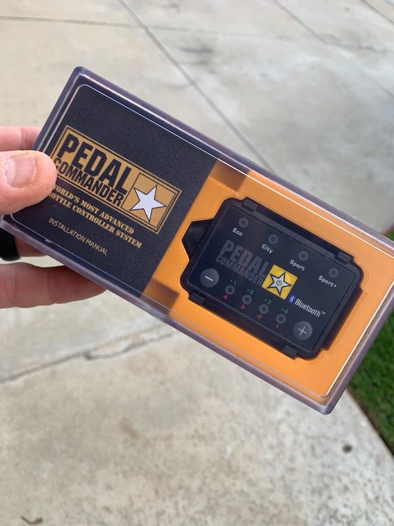

Again, if anyone has done it to their C7 please post a comment and let me know what your experience was. I'll post some install pics after I install it and follow up with some comments on my experience. My car has the PDR so once I get it set up I will try a couple of 0-60 runs with it off and again with it on in sport mode and see what sort of difference it makes if any.
This is the new one for the C7. It comes with a mount and all that so you can use the buttons right on the unit to change the settings but since it's bluetooth now, I just tuck and zip tie it up under the dash and use the APP to control it.

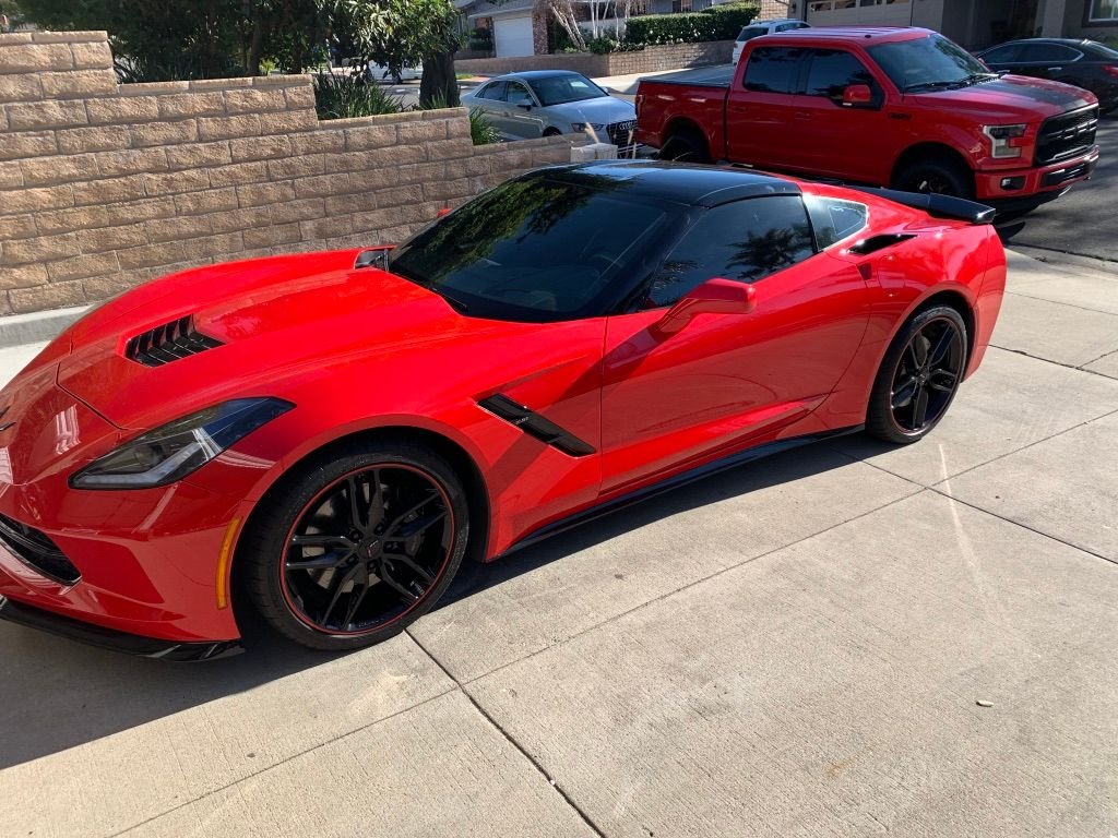

That's my F150 with the installed Pedal Commander in the background.

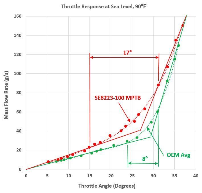

For you guys/gals w/ throttle controllers, regardless of brand;
1) Do you feel an abrupt change (jerk) in power delivery at about 33% throttle?
2) Is your tip-in accurate?
3) Have you gotten a hiccup (hesitation + surge) in performance shift mode?
I know they respond faster, I've used Vitesse TC before, but; do they respond smoother and controllable?
If no, this is why:
Throttle Controllers (TC) change the pedal mapping, not the actual throttle response. In other words, it sweeps the OEM curve (green) at a higher rate (faster) but not any smoother. Whichever problems you had at part throttle will remain.
If you look at the knee (bend) on the OEM curve you'll see the driver only has 8 degrees of blade travel to go from part throttle (gentle slope) to power throttle (steep slope), traversing that range faster will make the transition more abrupt yet, and less predictable. It works almost like a switch that goes from little response to too much response.
On the other hand, our throttle bodies not only increase the slope (response) at part throttle, but also make the knee much wider (17 deg), and accelerating the car is more of a continuum in which you can gradually control speed w/o the switch-like action. That makes actual response not only faster but accurate and predictable.
Not advocating for taking TC's out of the equation, just saying; fix the hardware (throttle body) then adjust the pedal map w/ the TC, if you still think it needs it, and you'll find your sweet spot.

I replaced my throttle body with a BMS ported and it smoothed things out, eliminated the lag and made it feel much more responsive at launch. I also added the Pedal Commander and with it's 32 different mode settings I have found the perfect one (City +3) that provides responsiveness above what it had but not abrupt. I found my sweet spot and I am very happy with it.
