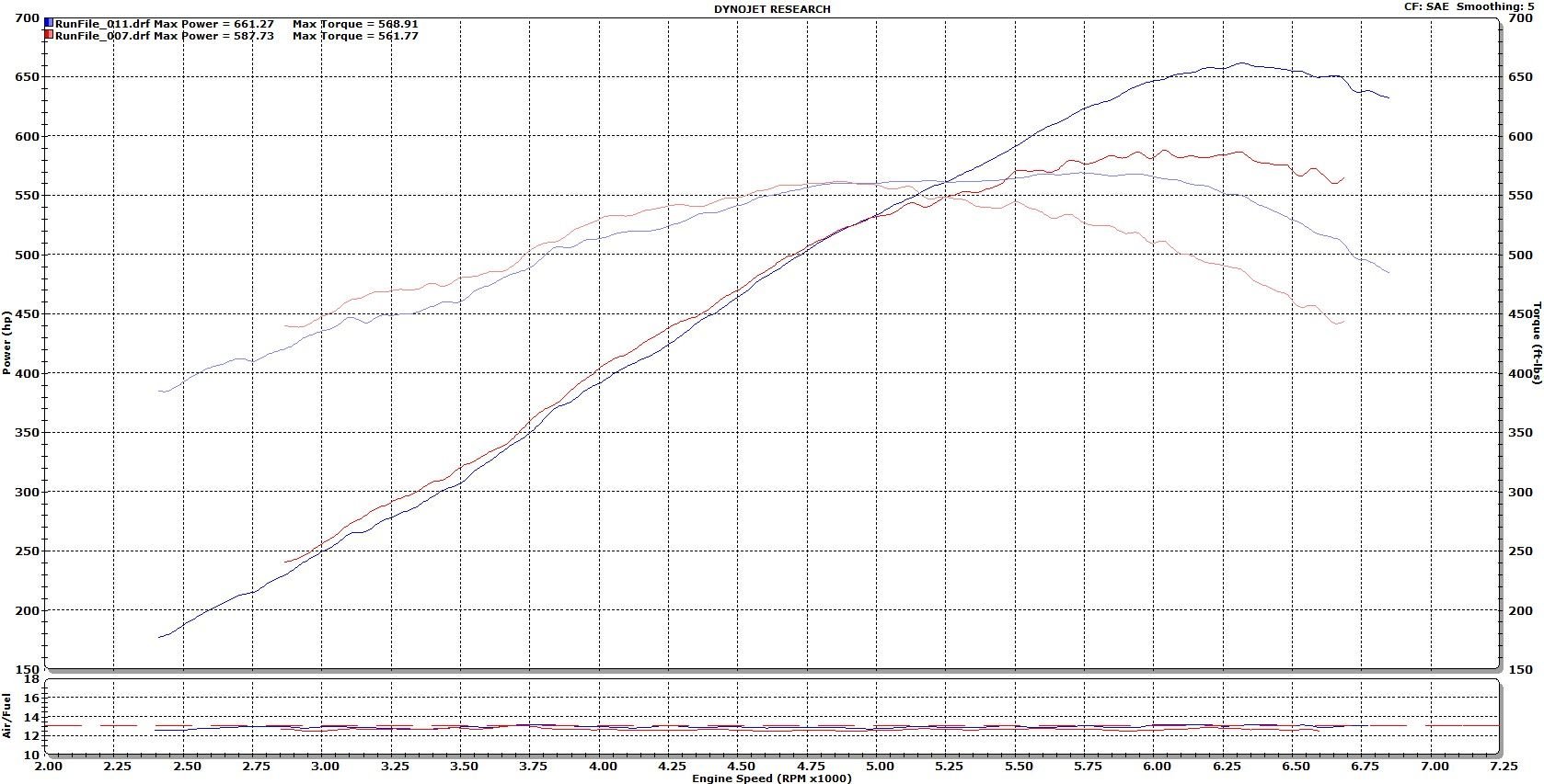

Old May 22, 2019 | 11:35 AM
16 Stingray's Avatar
16 Stingray
Joined: Feb 2019
Posts: 417
Likes: 38
My cam selection. LT4 fuel components and DSX low side. Staying around 9psi boost. I'm thinking right around 640-660rwhp. Any guesses?

Default JRE cam results
8 psi, 93 pump gas
Lost 1 psi. Before and after cam
