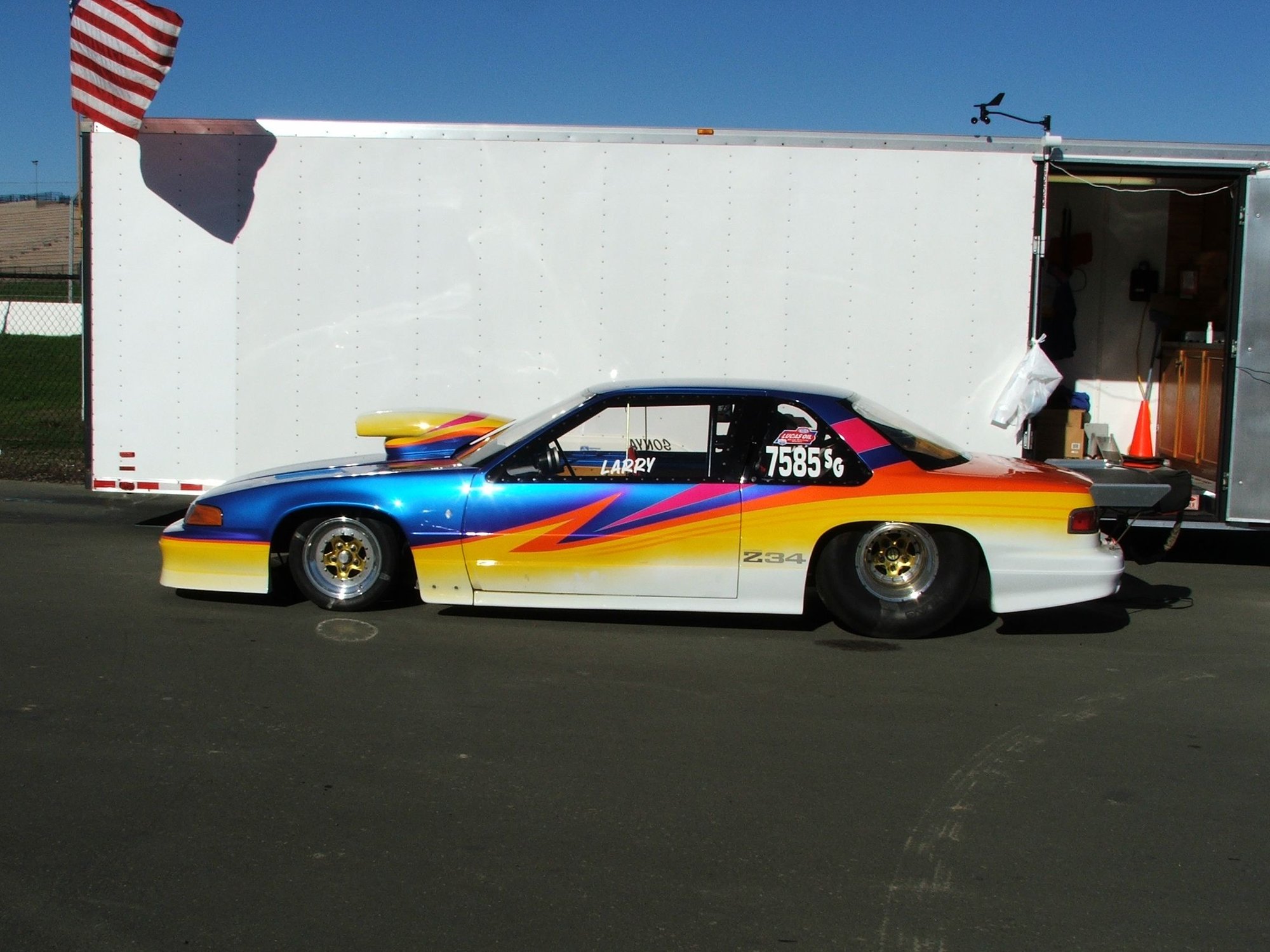

Without having a vehicle capable of making back to back run's within a hundredth or so consistently accurate DA information would not be pertinent. An example, my last drag car was a 94 Chevy Lumina, tube chassis, strut and 4 link, 540 powered, capable of 8:45 at 165 flat out. A DA change of 160' would change my quarter mile e.t. by .010 of a second, your butt dyno is not capable of measuring the difference a change of 1000' would make. A change of 2500' would only change the e.t. by .,150 , that 15 hundredths of a second, so you can see slight changes in DA are for all intentional purposes are going to be indistinguishable as far as a felt difference.
You can see the weather station pick up and sender above the left side of the door on the trailer.
