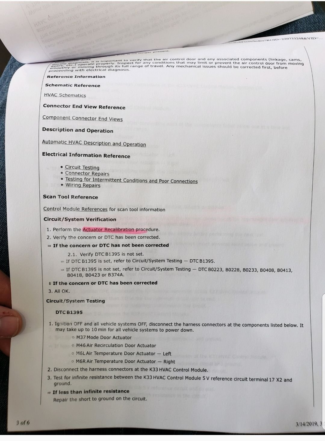

Here's what the mechanic provided

Okay, so one hour of shop time to reprogram the the HVAC Control Module. You won't find an easier fix.

Getting it done today, fingers crossed!
