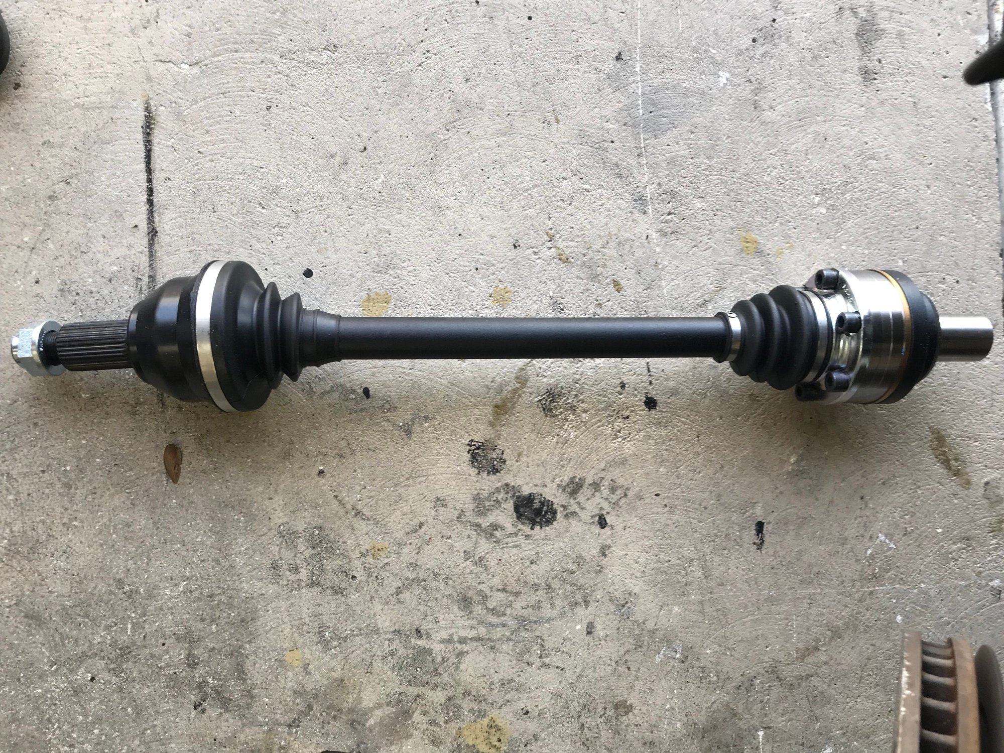

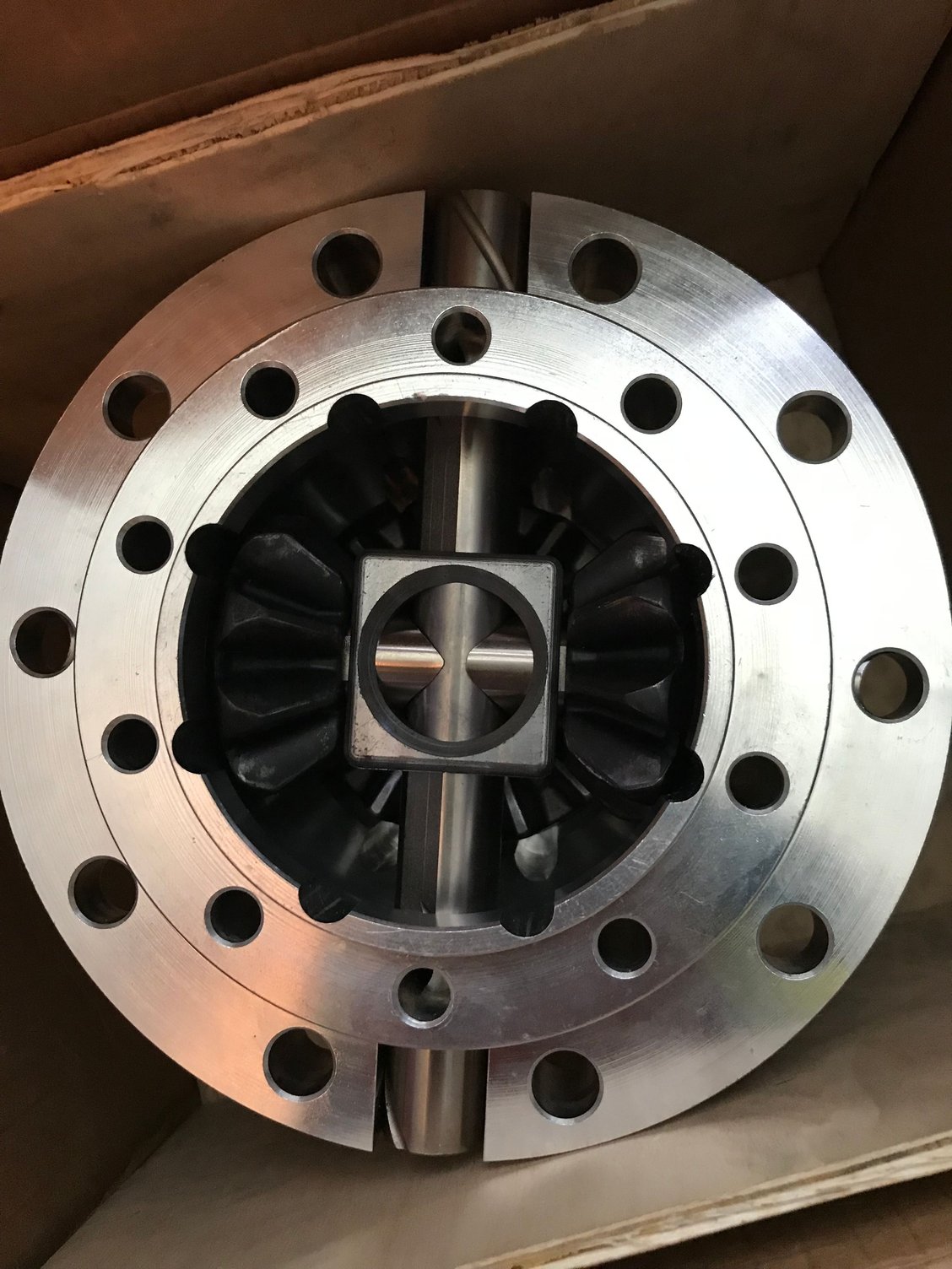

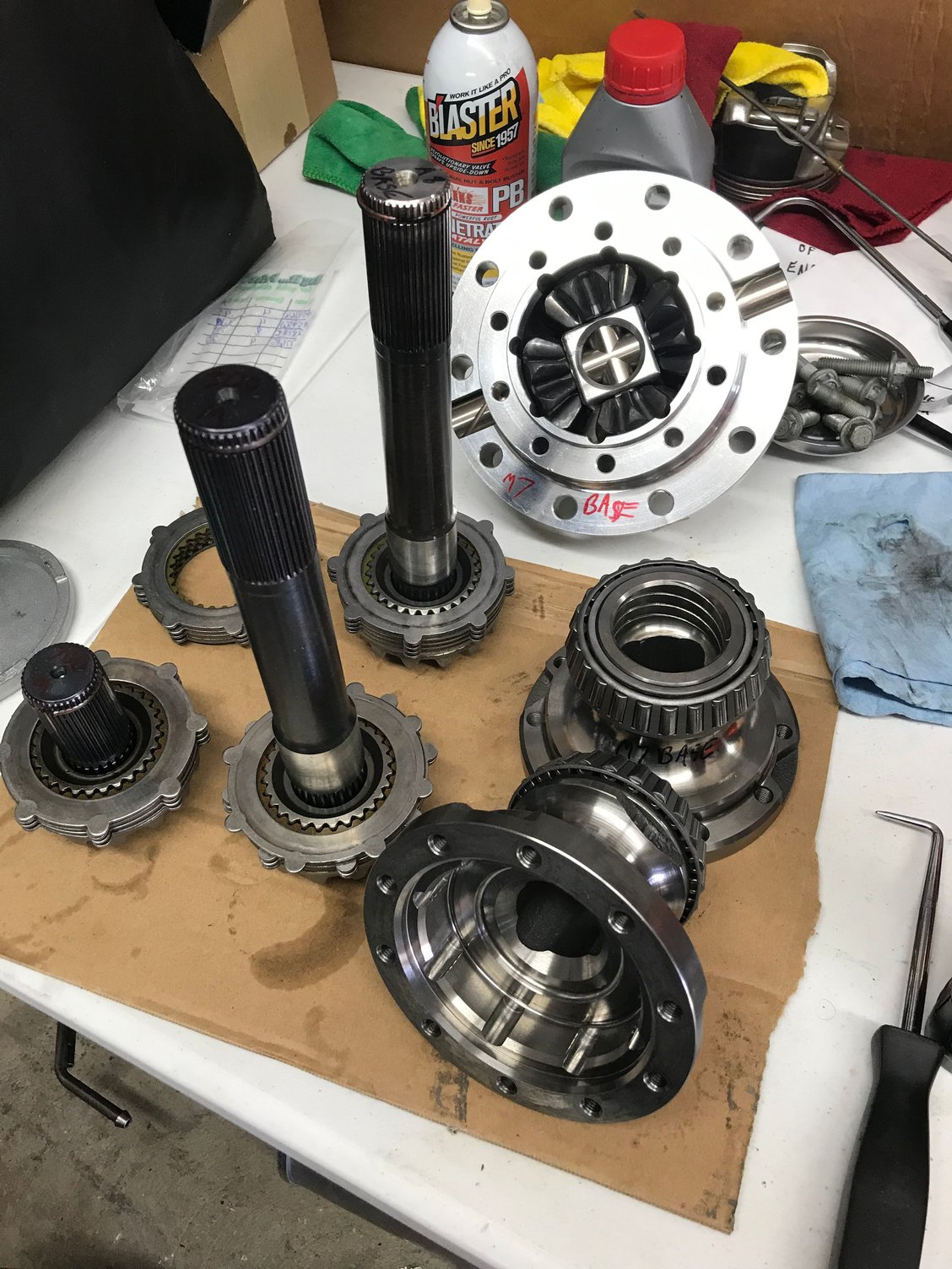

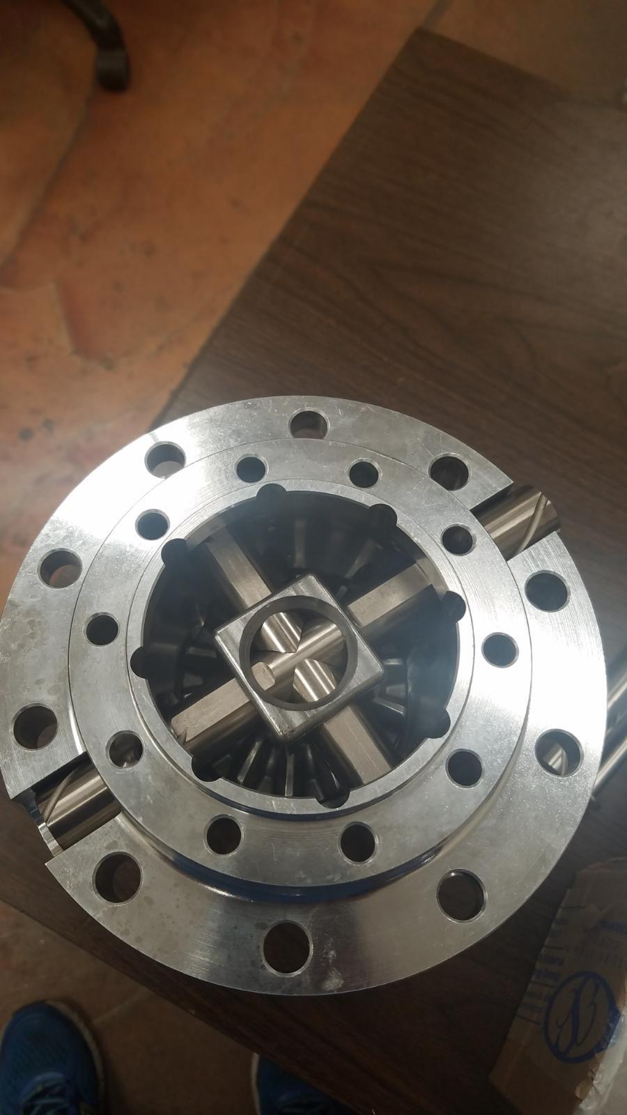

I upgraded everything also. 1040rwhp, with a custom 4 pinion spider gear diff, 300m stub shafts, and DSS 1800HP axles.

Fyreant,
Do you have pics by chance? Thank you.

Originally Posted by Rdubfalco
Fyreant,
Yep..
Ant
