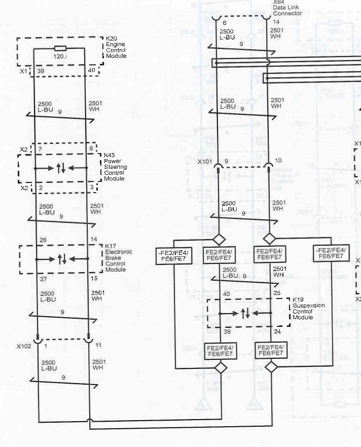

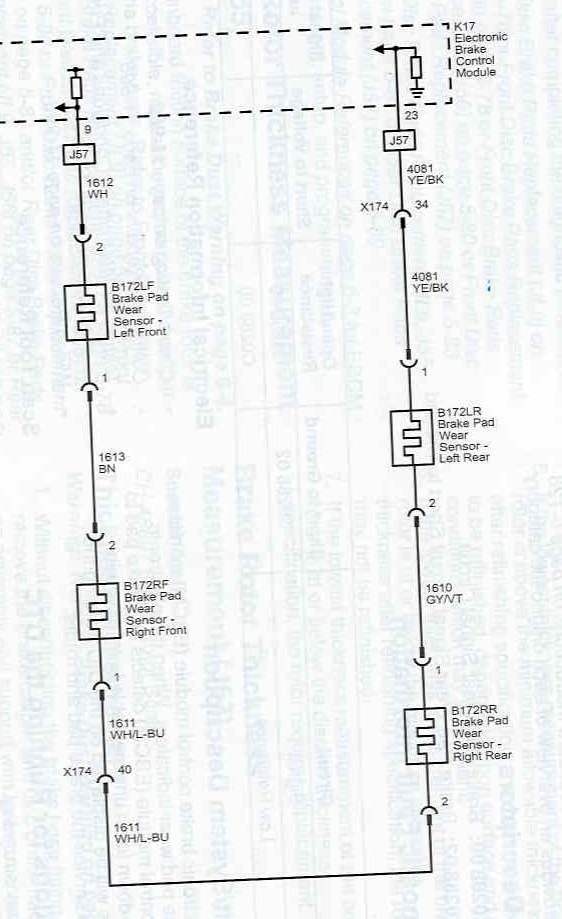

Do any have a pinout schematics for the ABS module connector (2017 GS)?...Having trouble identifying these last 6 wires?
Old Apr 10, 2019 | 09:52 PM
laserdude2215's Avatar
laserdude2215
Joined: Nov 2016
Posts: 1,189
Likes: 436
From: San Dimas CA
Here are four of them. Do you happen to have the pin #'s for the other two?
Old Apr 10, 2019 | 10:05 PM
laserdude2215
Joined: Nov 2016
Posts: 1,189
Likes: 436
From: San Dimas CA
Found them!
