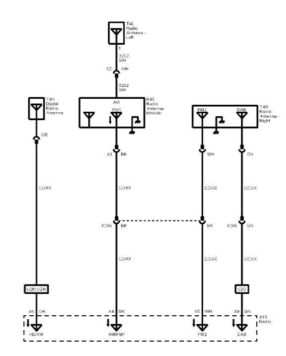

Now I'm really confused. I just went back and looked at the antenna schematics. It says the HD signal is shared with the XM antenna under the left front fender.

My antenna schematic labels this (the one mounted under the drivers side fender) the "HD/XM Digital Radio" antenna, which is for the Sirius Satellite radio, not the FM HD radio.

This is the official GM diagram. U2K is XM satellite, U2M is XM + HD. U2Q is the European DAB system. U2M wasn't offered on 15-17, and on 2018 the HD radio RPO was changed to U2L, so....

The "HD" label in the GM schematic is not correct. HD radio is broadcast on the FM frequencies, and uses the T4L and T4R antennas (located behind the rear bumper cover). Trust me, the GM Service Manual has lots of typos....

That's why I was confused. I always understood it to work the way you're describing it. The diagram made me second guess that.
I guess you could read the diagram a different way. U2K and U2M both include XM service. The same antenna is used for both RPOs, even though the HD portion of the U2M package has nothing to do with it.
That begs the question of why GM didn't offer HD in the 15-17 cars if the only difference was the radio receiver module.
