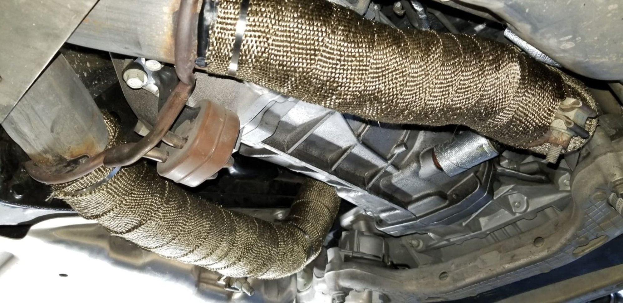

Thanks for the suggestion and information, have plenty of DEI's titanium heat wrap left from another project so it's just a time investment. I have the stock NPP exhaust so I'll wrap as much of the axle back portion that I can reach without removing it in addition to the x pipe.

I just got done wrapping the x pipe so I can install it tomorrow. I plan to wrap as much as I can reach of the axle back as I won’t have time to take the whole NPP out.
