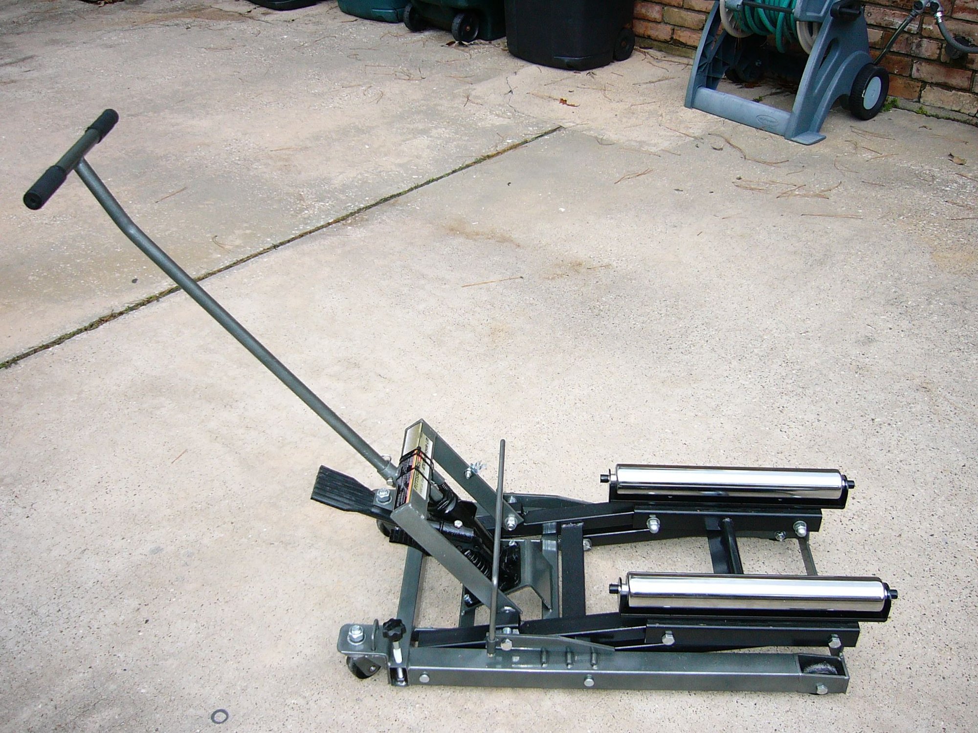

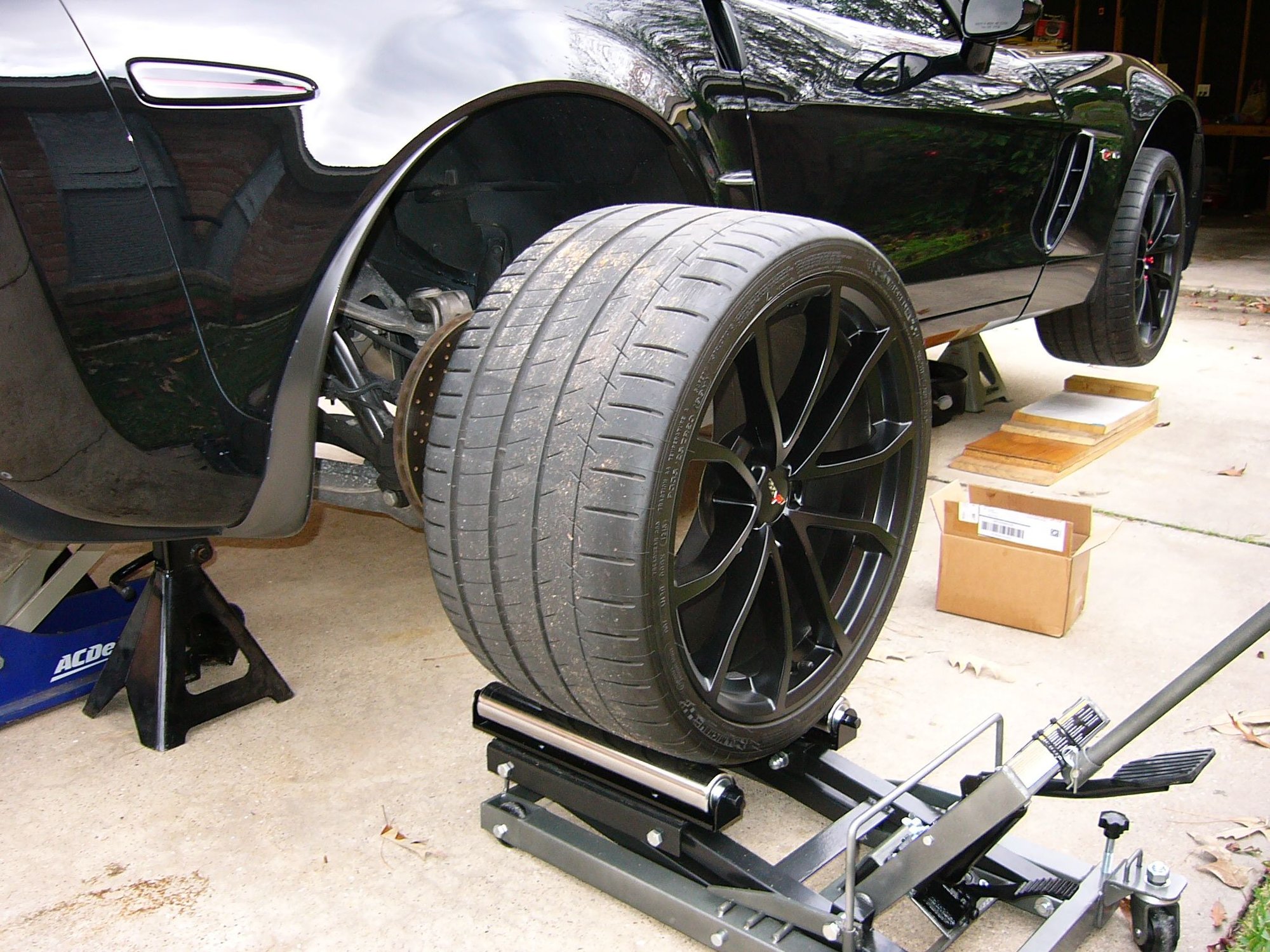

Here's some pictures of a gadget I made to help handle wheels. The ATV lift came from Harbor Freight and the steel rollers from Northern Tool. Maybe 100 bux in the whole thing. Rolls on it's own wheels, lifts and rotates the tire.
Slide it under the tire & give a couple of pumps.
Pull it away and the wheel is off. Roll it back under to reinstall the wheel. The rollers allow the wheel to rotate in place to align the studs.
Easy on & off, no more humping big a$$ tires around. Works great on my truck too.

JonMN's Avatar
JonMN
Joined: May 2016
Posts: 4,488
Likes: 1,028
From: MN
^^^. We have a winner! Thanks!

Now that is slick. It won't fit or work in my car closet but I may duplicate a version of it if/when I move and get a real garage. Meanwhile I am working on V2 of a roller platform for the motorcycle jack. I'll post it up here later.
[QUOTE=wjnjr;1599912070]Here's some pictures of a gadget I made to help handle wheels. The ATV lift came from Harbor Freight and the steel rollers from Northern Tool. Maybe 100 bux in the whole thing. Rolls on it's own wheels, lifts and rotates the tire.
