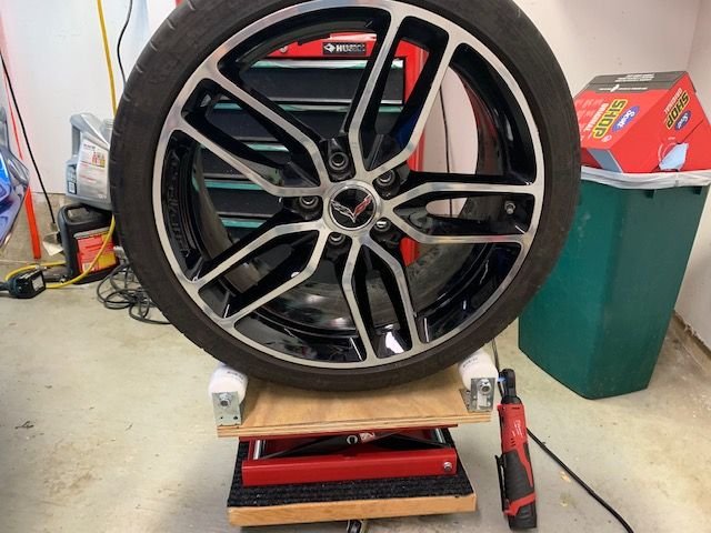

This is not a totally original idea... I got the inspiration from member JonMN to use a motorcycle lift to make wheel installation easier. See his thread here: https://www.corvetteforum.com/forums...ation-tip.html. Jon showed us how to use a motorcycle jack to make this easier and I added a new feature, a platform with some rollers to allow you to spin the wheel to line up the lugs more easily. I really need this because in my tiny garage I have so little room to work that wheel install is a back wrenching PITA even using the ReverseLogic lug extensions.
First I bought a cheap motorcycle scissor jack, that will come in handy anyway because I have a motorcycle. Then I made a small rolling dolly out of a piece of 2 x 12 I had laying around plus some casters from the box store. Put the jack on that and it rolls around easily.
Then I made a wheel roller platform out of a piece of 3/4" plywood, some 1 1/2" schedule 40 PVC pipe and some hardware I had laying around, including some threaded rods, steel brackets, and nylon lock nuts. There are lots of ways to approach this piece.. could use a piece of 1/4" steel plate instead of plywood... could use ready made industrial transfer rollers like this or similar: https://www.ultimationinc.com/replac...r-bracket-set/.They are cheap... but I already had the other stuff so I figured I'd just use it.
Measurements for the roller platform are approximately as follows:
Plywood: 11.25" x 16.5"
PVC roller: 1 1/2" x 10.75" (including end caps)
Threaded rod: 1/2" x 12.5"
Roller center to center= 15.5"
These measurements aren't totally critical, you could alter them and it would still work. Main thing to watch for is if the rollers are too far apart the tire will bottom out on the platform and not roll.
This setup will work for C7 wheels with the car lifted to the high position on a quickjack. Smaller rollers or a piece of iron for the table would gain more clearance. The dimensions above will work for wheels somewhat smaller than C7 and larger than C7, although really tall truck tires might be a little tippy.

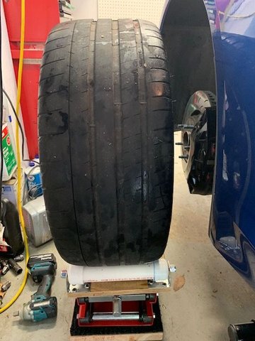

That's what I used to use before this jack method. It is way better than bare lugs but it doesn't really work well for me in my tight garage. I can lift the tires easy enough but then there isn't enough room to squat down enough to be able to visualize the lugs and extensions. I have to sort of contort myself from the side which makes it exponentially more difficult. This jack method is the killer app for wheel install. :-)
