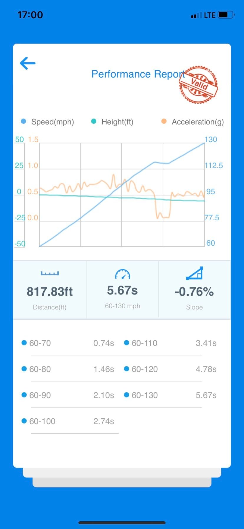

Well I’ll at least provide actual real world data for OP not just internet rumor and the use of “everyone knows” type ****....little buddy 😉 this is how we get these stupid myths....”everyone knows mustangs dynos read 15% lower bullshit” and it spreads like wildfire unfortunately. Damn near any two dynos even if the same make aren’t going to have identical numbers. Had you said 15HP lower that’s at least somewhat possible....but 15% just shows how much you don’t know and have no clue about so why tell this man some nonsense line that?
Dragy run on a C6z making 840whp loaded and SAE corrected video and graph below, dragy and Vbox have lots of data on damn near everything worth measuring. A C6 making mid 800’whp is good for a mid 5 seconds 60-130 time, other factors do play, I was on a a 19” drag radial so no 2nd to 3rd pulls, probably cost .07-.09 alone, 6700 rev limiter maybe another .03-.05 either way a 5.49-5.69 is spot on for mid 800’s on a C6z or any C6. Low to mid 900’s will get you into the low 5’s....5.1-5.3sec shifts definitely matter and can bring the times up or down but the data and graphs reflect all of this.
OP it’s just a tool but if you use the tool wrong or are given bad advice on what the tool does it ends up being a pretty shitty tool. This little $150 device let you put actual real world numbers to the dyno sheets and per round of mods so you know exactly what you gained and how much $ per power or time shaving it got you, highly recommend this thing!
I could care less about the dyno numbers especially if they don’t match up on the street....I’ll take a 800whp dyno sheet that gave me a 5.4 sec run but that would be wrong because it’s just impossible to run that time in a vette with no weight reduction, end of the day the physics must add up, so “15% lower nonsense” is just what it is....nonsense. 🇺🇸
By this 15% lower mustang dyno fairy tale that would mean -126whp so 714whp, not a single C6 no weight reduction would be any where near running mid 5’s, so here’s actual real world data and video that what you were told above is complete and total nonsense.
Btw Dave....stock C7z runs a blistering mid 8 second 60-130mph
