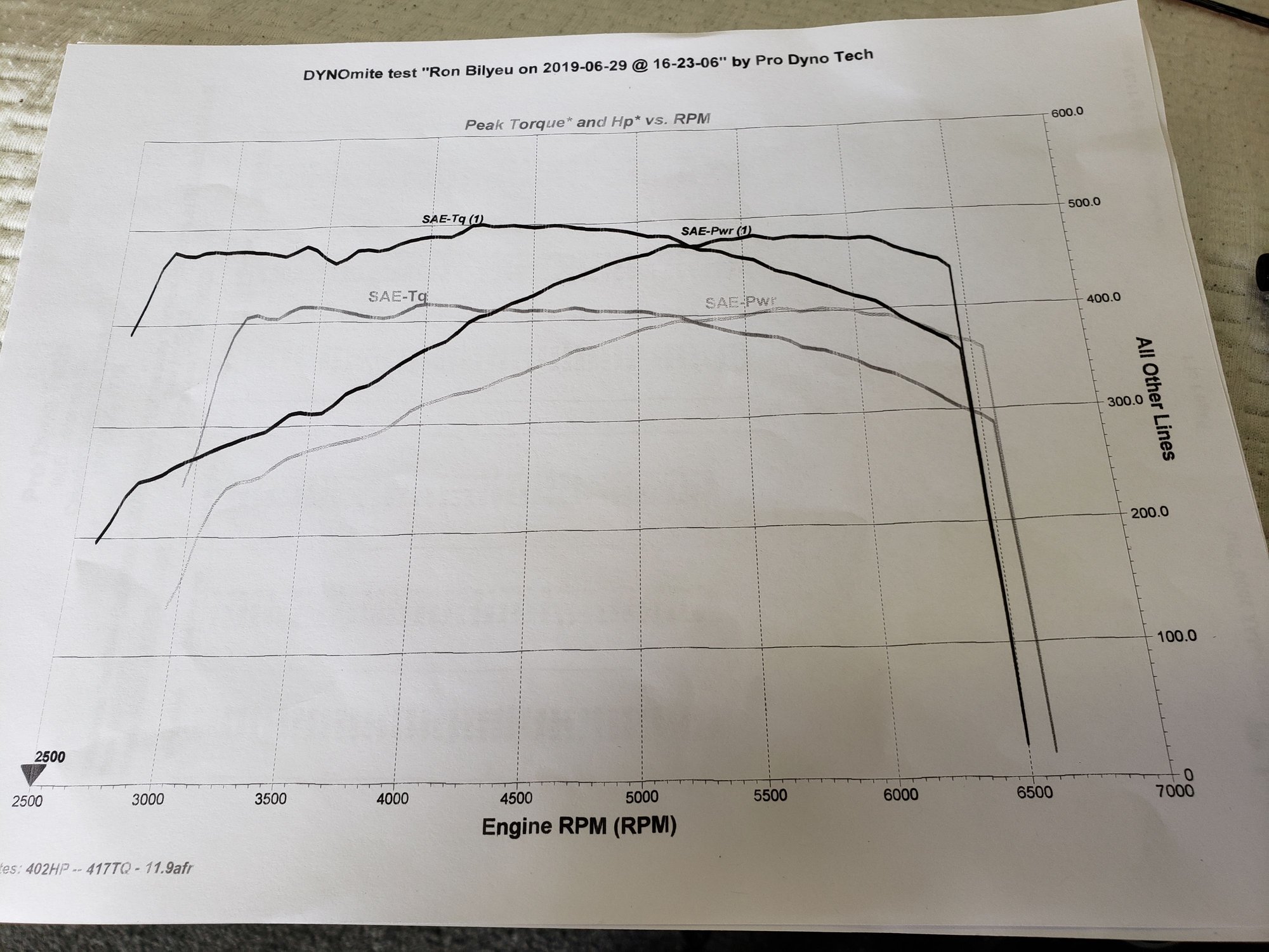

I was asked by a former customer to bring back the Mongoose Packages like we did on the C5. When looking at muffler options for sound and power I could not find find anything on the flowmaster system. Our c5 Mongooses ran either B&B or Flowmaster I decided to try flow master on the C7 Our goal was all bolts on no head modifying no camshaft Making a reasonable price Mongoose C7 560 We were at 460 RWHP with the stock non NPP muffler we need to be above 465 with a 17% loss thru the drivetrain on an auto Adding the flowmaster we got 479.3 RWHP and 500 FT Lbs RWTQ Flowmaster added 19.3 RWHP & 24RWTQ
No drone just a nice sound when you step into it. Welcome Back the Mongoose with the Mongoose C7 560 100 HP at crank. Seems to be in line with other catbacks out there I will try and figure out how to post the dyno sheet later Ron

20rwhp from a catback?!

The non NPP mufflers are very restrictive more exhaust flow is required with air flow increase. the other mods sufferered because of restriced exhaust flow
gain was 19.3 HP 24 Ft Lbs rear wheel. also has custom Brisk spark plugs and Granetellneteli 0 ohm wires
