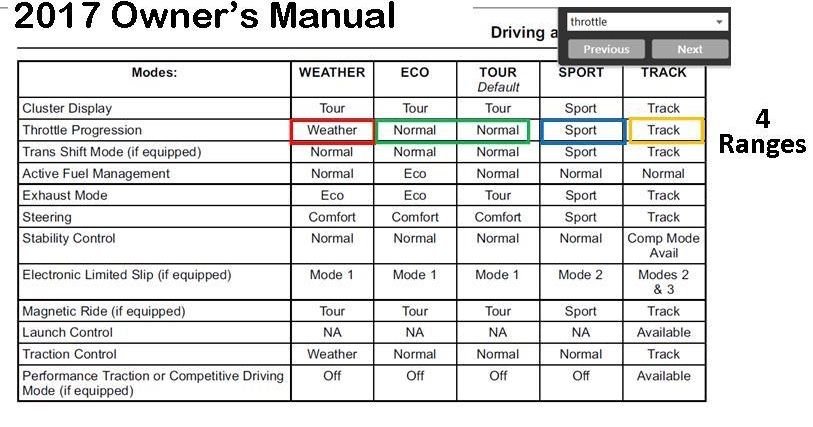

I’m sure you seen this already...please disregard the highlights. I’m having the same issue noticing MRC too.
