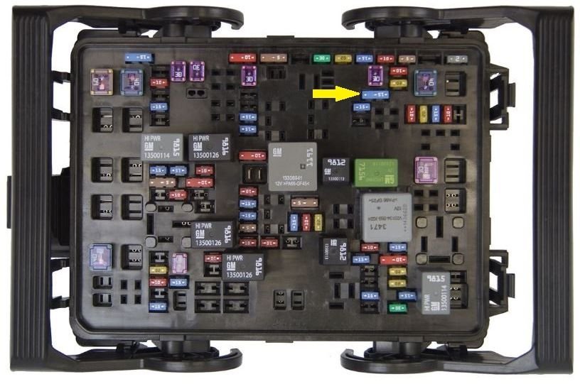

So, would this be the fuse? (2019)

It must be, that is the rear fuse box; right? In my 2015 Stingray, it is this one, in the engine compartment (front) fuse box.

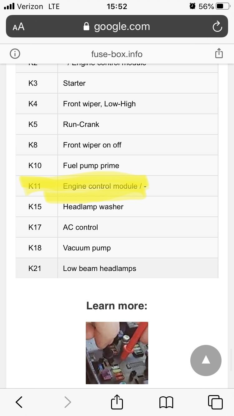

Yes, there is one in the rear too. The front one is easier to access. Looks to me that in the 2019's either 55 or 78 will do. The figure above is pointing to 78.
The K's are for relays, don't pull those.
