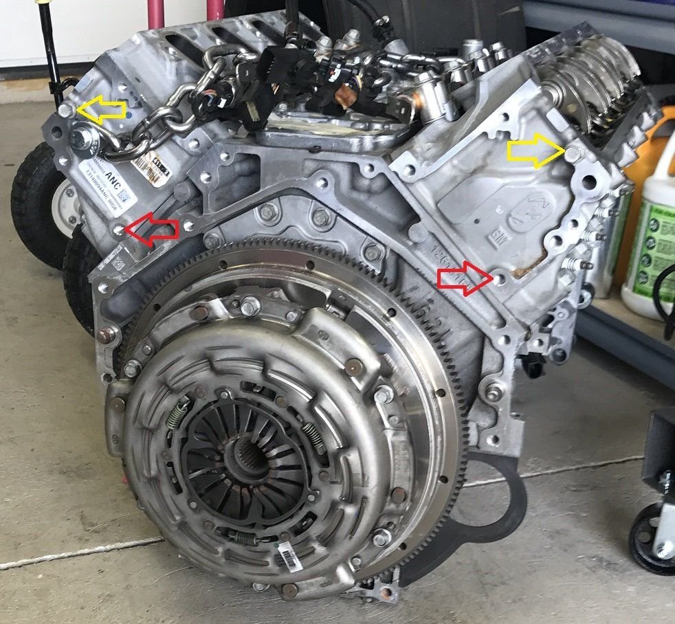

Side Q: What fluid change needs the exhaust to be dropped?????
Maybe when the exhaust was hanging by the Ox sensor wires, it put so much strain on the wire-harness, above where the first harness clamp is, that the metal edge of the clamp cut through some of the wire insulation.
I would follow the ox sensor wire harness to where the first retention clamp is (probably on the back of the cylinder heads), and carefully inspect where the wires pass through the clamp. Also, the ground bolts should be checked, pulling on the wire may have loosened them. Also, check the tightness of the +12V (caution these are 12V battery hot all the time) connection nuts that are between the underhood fuse box, and the coolant reservoir. There are 3 or 4 studs/nuts under 2 black plastic covers, in this area.
From the engine removal thread:
We also need to disconnect two 13MM ground bolts connected to the back of the cylinder heads (one on each side and shown with yellow arrows below) as well as two 15MM bolts used to bolt the large wiring harness to the back of the heads (one on each side shown with red arrows below). These two 15MM bolts proved to be the biggest pain in the *** out of the entire job so far, so best of luck with those. Simply put, they serve no mechanical purpose and are just used to secure the harness from moving though the harness cannot move much anyway in that area. That being said, I will NOT be reinstalling these! For Simplicity, I am showing a pic of where these bolts are after the motor is already out so you can see them better.
