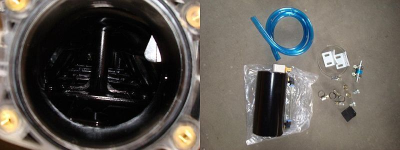

I install the mightymouse catch can on my car but im not sure i did it right. The other hose is connected to the valley port. So do i cap off the pcv return? Thank you

Need more details. Is this a wet or a dry sump car? Usually a diagram is included from mms. I’m assuming this is the c7 wild kit.

Its a dry sump and its the wild catch can.

According to the directions you have it backwards. You need to Connect PCV valve exit on catch can to intake manifold (top).You can relocate the valley plate port (lower) to where the driver valve cover connected previously, or cap off. If this goes to the dry sump, you should remove the assembly from the valve for free flow in both directions. You can also instead Tee this line straight from the rear ‘sidekick’ oil tank to the rear line of the main oil tank. These are right from the directions.

What he is saying here on a wild dry sump. Robert

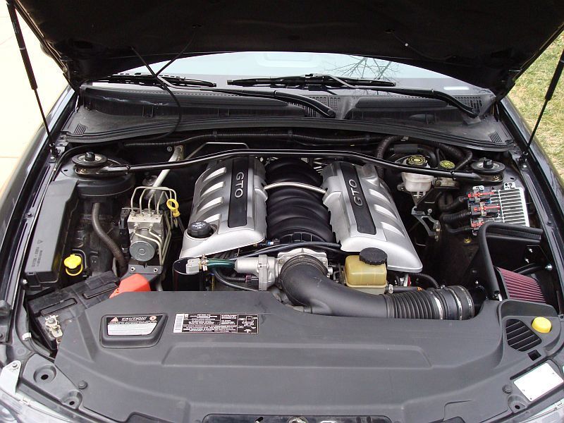

Catch Can Installed LS2

That's what he has.
