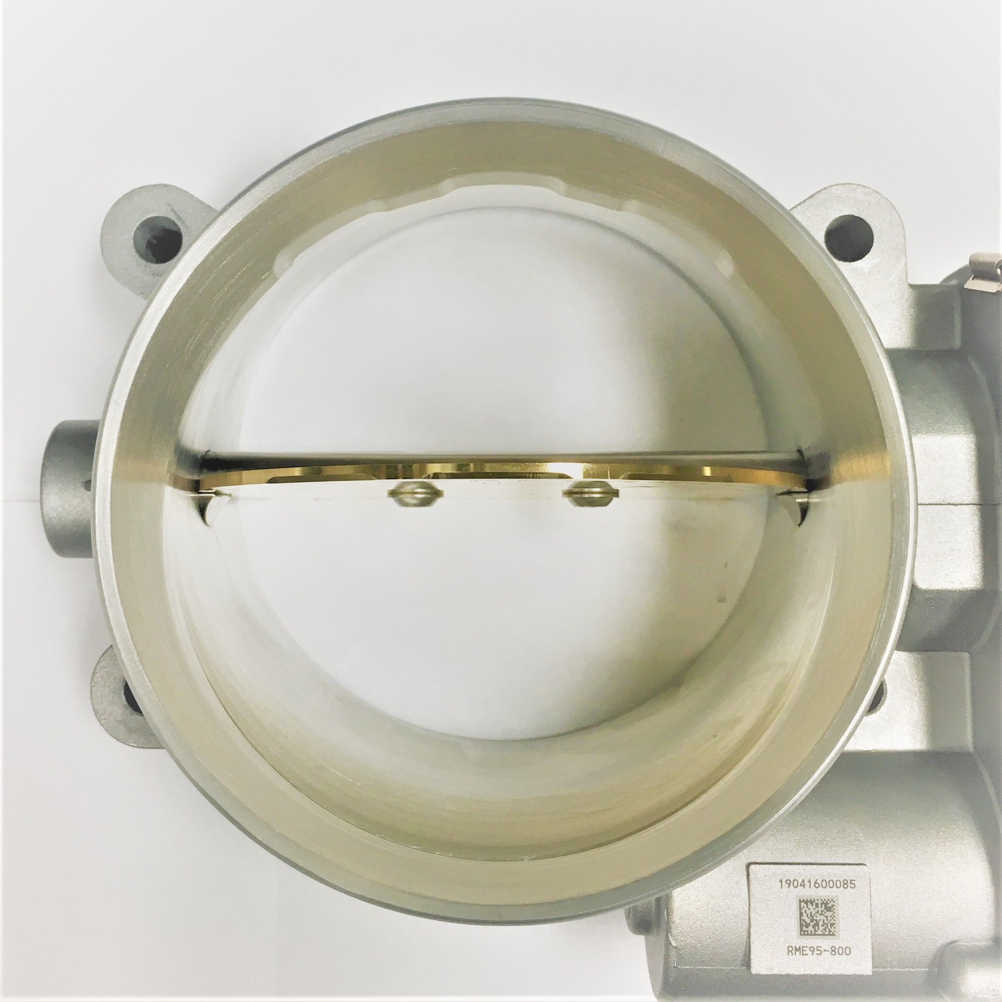

I can’t speak for the Katech ported TB, but I can for the Soler TB. On my M7 Z, big improvement to throttle response from tip in to ~ 30%. I think any of the ported TB’s out there are an improvement over stock. Mamo, Soler, and Katech seem to be the most popular around here. I researched all 3 and went with Soler. I’m very happy with it. Mamo has just released an updated version of their TB which is supposedly a noticeable change from the first version.

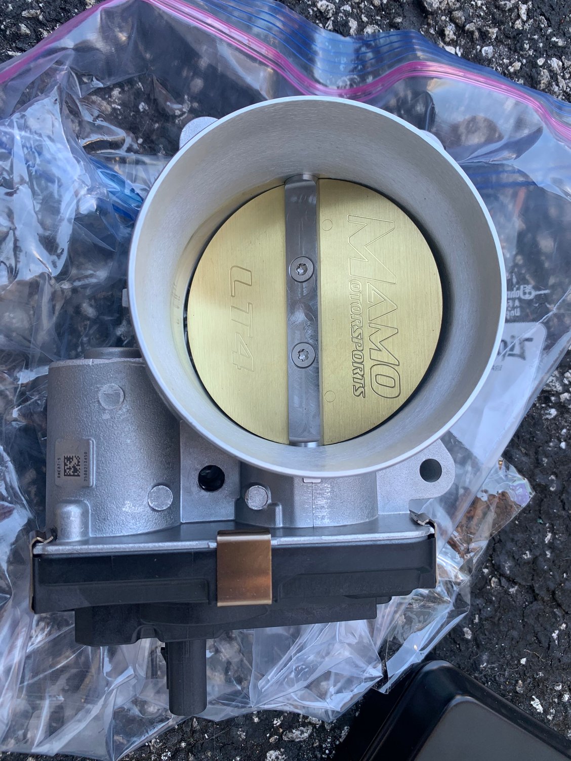

I just ordered the Mamo v2 for my Z06 M7. I'm going to see what sort of changes happen to Torque Management and Airflow on my already tuned car.

Share your feedback after install. I’m sure you’ll like it. Day and night design compare to his old model

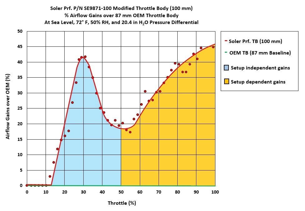

Thanks, everyone for your kind words.
Gbrooks, we completely understand what you are after. That is the only thing we do here and the reason we exist. We offer a full solution to the issue, Throttle Body + Throttle Controller, 15-min DIY, warranty safe, Money back warranty. Please consider us. Feel free to email or call if you have any questions.

Definitely a great mod. Really glad I did it.

Glad you liked it! Yea you can tell Tony’s new style TBs are much better then his old style. I’m sure more will jump on it once tony makes his official release on them. We lucky to be one of the first with it

Soler seems to be the clear leader right now, and the only one with actual technical data to back it up. I like how he cuts the shalf down so it's only 1-sided. I upgraded from another brand to his and overall car seems to run smoother with less hesitation. I haven't retuned for it yet, but my tuner said not to worry about it just swapping from one brand to another.
Mamo appears to be incorporating some of Soler's design ideas into his v2. Good for him, competition drives the industry! Katech was the first to cut down the shaft on the LT1 TB way back when and I always wondered why others at the time weren't immediately jumping on that idea (the other popular brands at that time were WeaponX & Vmax). WeaponX is still around and makes a solid product. Vmax seemed to be junk though and finally stopped selling them. There's been a few other brands that have also come & gone after their 15 minutes of fame of being the current "hot street set up."
You really can't go wrong with Soler, Mamo v2, or Katech though. All make a legit product.
