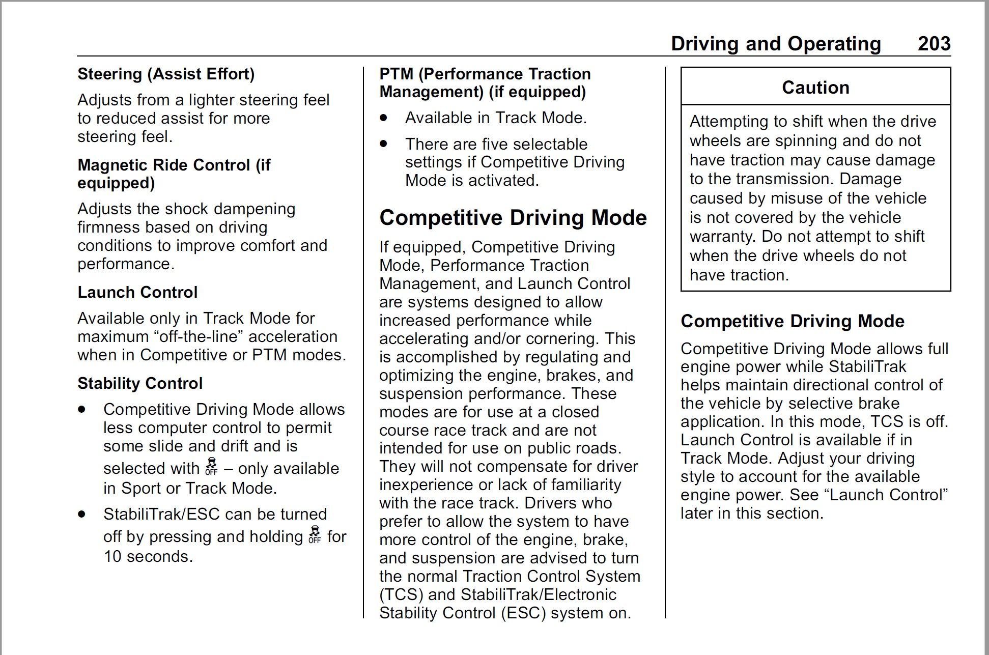

Clearing codes hoping the problem is temporary usually doesn't work. You had the console apart to install a shifter. It is highly likely the connector to the drive mode selector came loose or a wire was damaged. Have you tried setting your drive mode to each of the specific settings, Weather, Eco, Tour, Sport, Track to see if you can see a change on the DIC? When in Track Mode did you push the center button twice to enter the PTM mode selection menu and try to select Wet, Dry, Sport 1, Sport 2 and Race?
I didn't even know there were sub options in track mode

Clearly spelled out in the OM which really needs to be memorized to use the car properly. Also a major portion of the class room discussion in Spring Mountain Corvette Owner's School and use of Sport 1 when on track.
From the 2019 OM (earlier versions with different page numbering system have the same content):
This is one of the best features of the car. It lets you drive it closer to the limit. All of the people who do videos and say they put the car in Track Mode don't address the sub modes and what they might do. Just moving the selector to Track Mode without pushing the button twice leaves you in an undefined mode. It your car has MRC it has PTM and Competition Mode (a carry over from the C5 and C6 days) is only available in Sport Mode.
Bill
