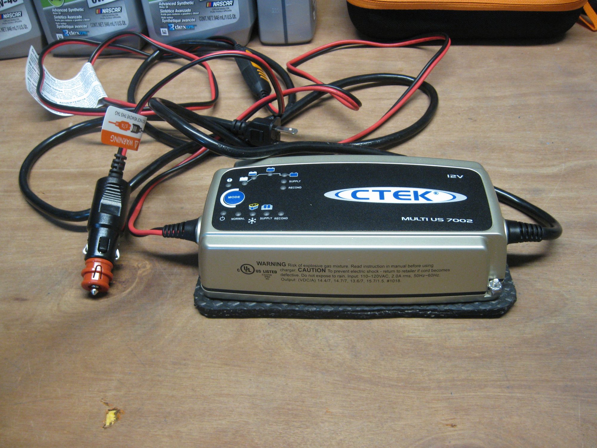

I’ve been using a Ctek 7002 for about 4 years. The last couple of times I’ve used it the charge indicator goes to green (meaning battery is charged and unit is in maintenance mode). However, the green light goes out after a couple of hours. The only lights on the unit at this point is the normal and power lights. Anyone ever experienced this? I’m using the car’s charging port.

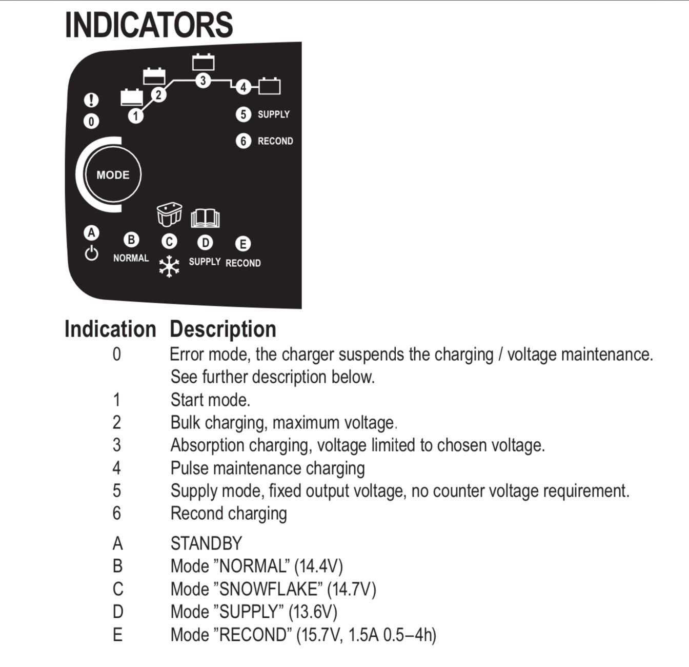

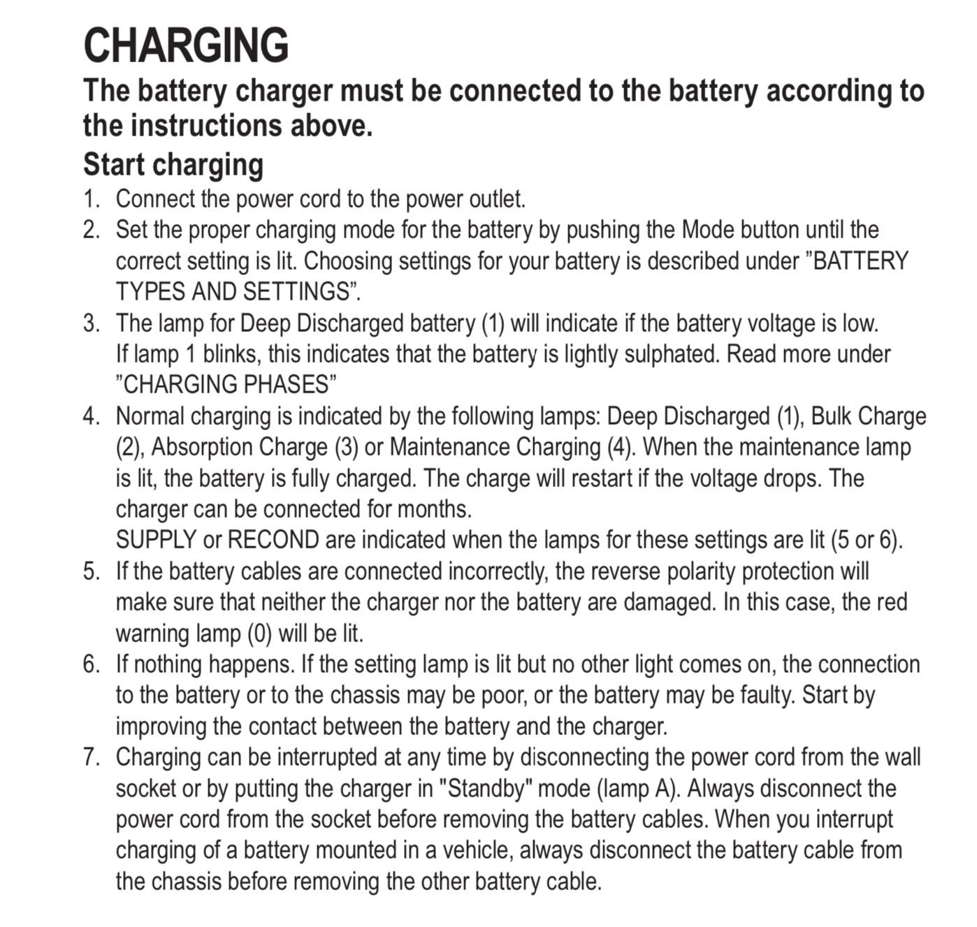

What lights are lit? (see diagram below). See note 6 below.
