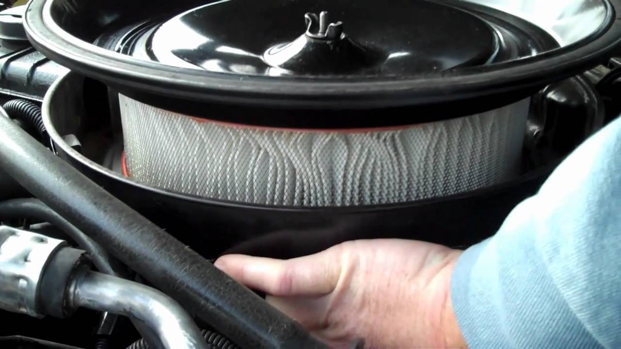

Bigger, less restrictive cold air intakes are a popular mod to increase horsepower.

Default Air breather "flip."
Wow!!!! that's a blast from the past!Common sense dictates ... less restriction = faster throttle response.More HP without the use of a blower...probably not.
