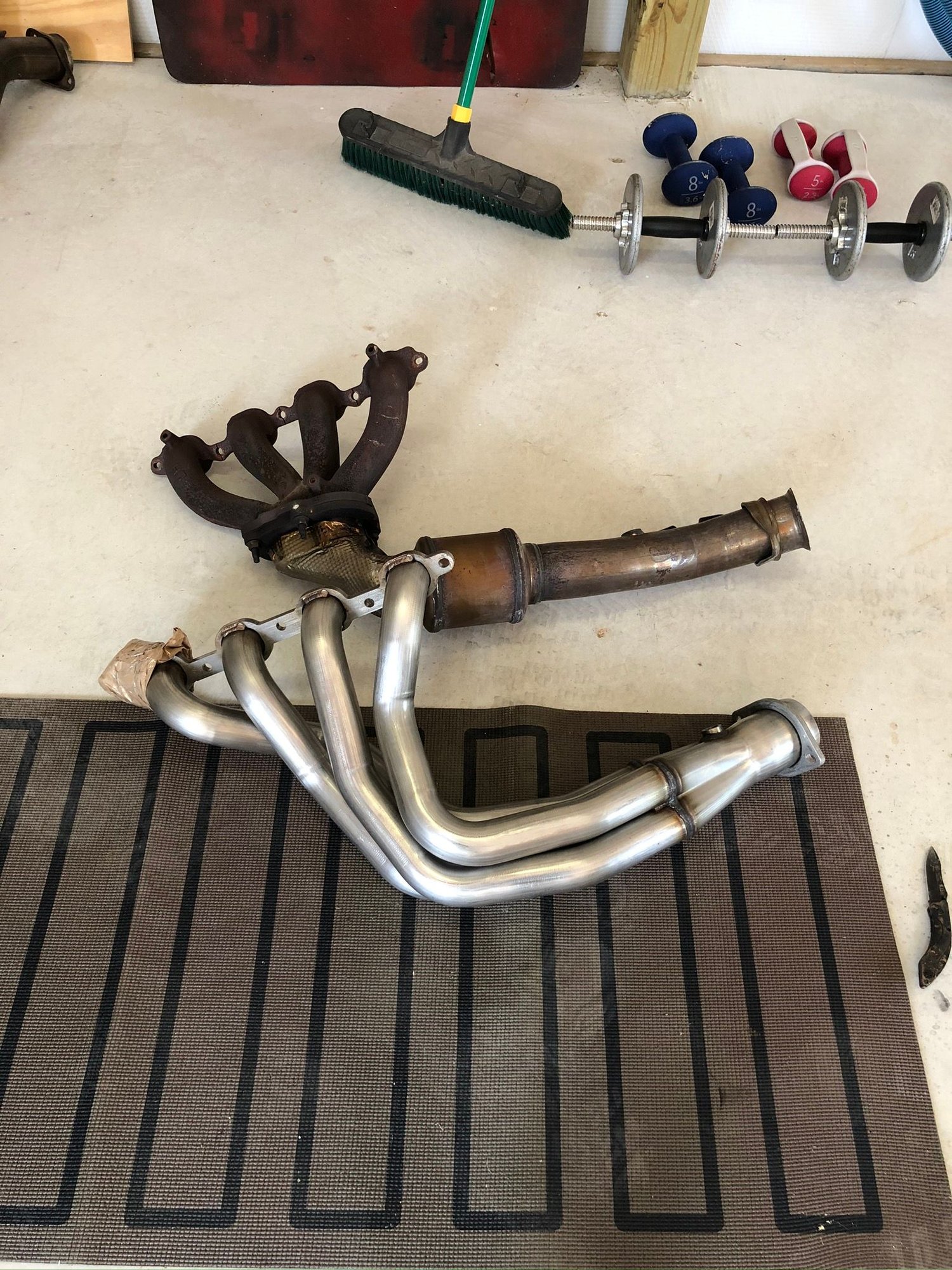

So I pray this doesn’t come across as me being argumentative. That’s not my intent at all, but I realize how valuable these forums are for people like me searching for good and reliable information. My ARH long tube system came in today. After looking at the system, it’s not fair at all to say that any system that is designed to bolt directly to the factory mid pipe should be considered a mid-length header. In fact, the primaries on the ARH headers are not quite as long as those on the Corsa or BBE headers. I say that because the collectors for the ARH system are closer to the engine than the collectors will be for any system designed to mate up to the factory mid pipe.
So for anyone considering a decent set of headers that will allow you to use your factory X pipe with the secondary cats in place, don’t worry about the Corsa 16004 or the BBE equivalent being mid-length headers. Their primaries are every bit as long if not longer than top-tier systems like ARH. Ive attached a photo of the factory manifold/cat pipe section compared to the ARH primary section for reference.

Thank you for confirming. I can admit when wrong and appreciate that I learned something new today.

I'm with you, didn't think these were a thing, but learned that they are. Thanks to the OP for updating the thread!
