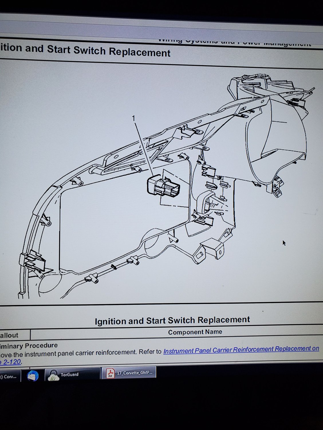

Well my manual says remove panel but heres the back side so u know what your looking at

I don't think it's possible to remove without pulling the dash. You have to release two clips, and I can't see a way to do that from the front without causing some real damage.
