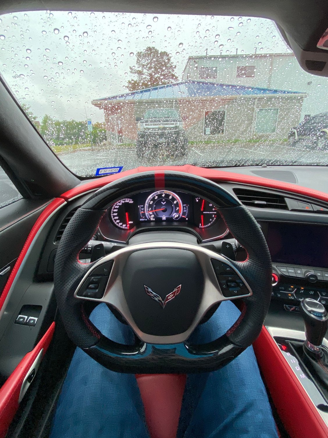

Stripped (Badly) the giant t50 torx bolt holding the steering wheel to the column. Any ideas besides taking it to a dealership?.. which is currently my next option. Bolt is still pretty tight but 2-3 full rotations away from the factory torque spec

So I ended up just bringing it to a trusted shop and it took them 2 hours to get it out. They used one of those fancy induction heaters and it heated up the oem loctite allowing it to spin easier. The wheel is on now and looks and feels great. Thanks for all the replies guys. I just bit the bullet and played it safe so I didn’t make my problem worse
