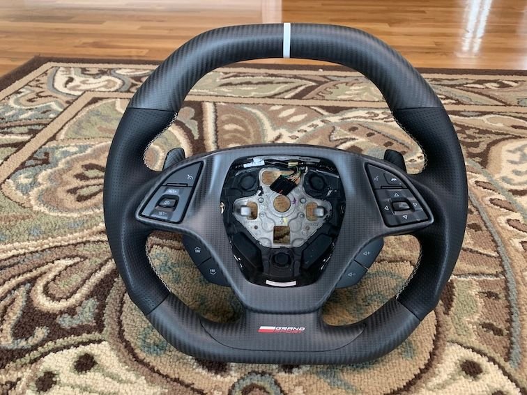

Hey guys, my custom steering wheel from Auto Dynamics West just got delivered, and I'm BEYOND excited for it. Huge shout out to Greg for the stellar work. So tonight I set about getting started (car is stored for the winter, so no rush). Everything started off fine, removed the airbag easily, disconnected wires, but something just isn't right with the bolt! I could not get it to budge with a 1/2" ratchet. My battery operated 1/2" impact wouldn't budge it either. Finally I broke out my pneumatic 1/2" impact that I save for 'special occasions'. I applied some gentle heat with a small torch type butane lighter (wanted to try to warm it up a little, but not add too much heat due to where its located) and it FINALLY started to back out, a tiny bit at a time. The bolt would turn like maybe a quarter turn, then stop, then a little more and stop. I tried putting some penetrating oil in it, but then my t50 bit sheared off. At this point I had to give up for the night, mostly because I don't have another t50 so I have to make a trip tomorrow to get one. I feel like the bolt may be galled or something, but at this point, I HAVE to get it out. For what its worth, the car is a 2019, I bought it brand new from the dealer, so I know it hasn't been messed with before. Is something up here or is this bolt really this much of a pain?
Worst case scenario and the female threads are totally screwed up somehow........would I need a new steering column?....gulp!
Pic of my new wheel for those interested.

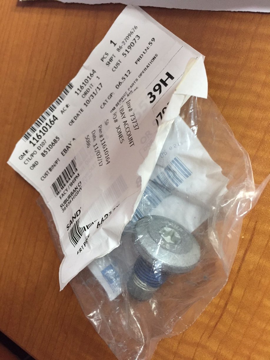

Quick update; Ordered a new bolt, a tap and die (clean out the hold, remove the OEM thread locker from the new bolt), and drilled the head off the old bolt to remove the wheel. I've got 2 options that I can think of to remove the remainder of the bolt; heat it up with a small torch, clamp a vice grip on it, and hopefully it'll move now that I can apply some more direct heat. 2nd options, suggested by my dad, would be to drill a hole through the bolt, almost like I was going to use an extractor, but instead reverse tap it, run a right-hand threaded bolt down into it, then heat it up and use that bolt to remove it. I think I'm going to try the vice grip solution first, since I have everything on-hand, and we'll go from there.

Since you are going to use a new bolt, how about a pipe wrench and a 2' piece of pipe on the end for leverage?
I have an easy out set that is pretty large and it might be what you could also use. It has reversed spiral threads that wedge in and as you turn it and the threads bite inside the stripped torx hole for left turn "Counter clockwise" movement.
