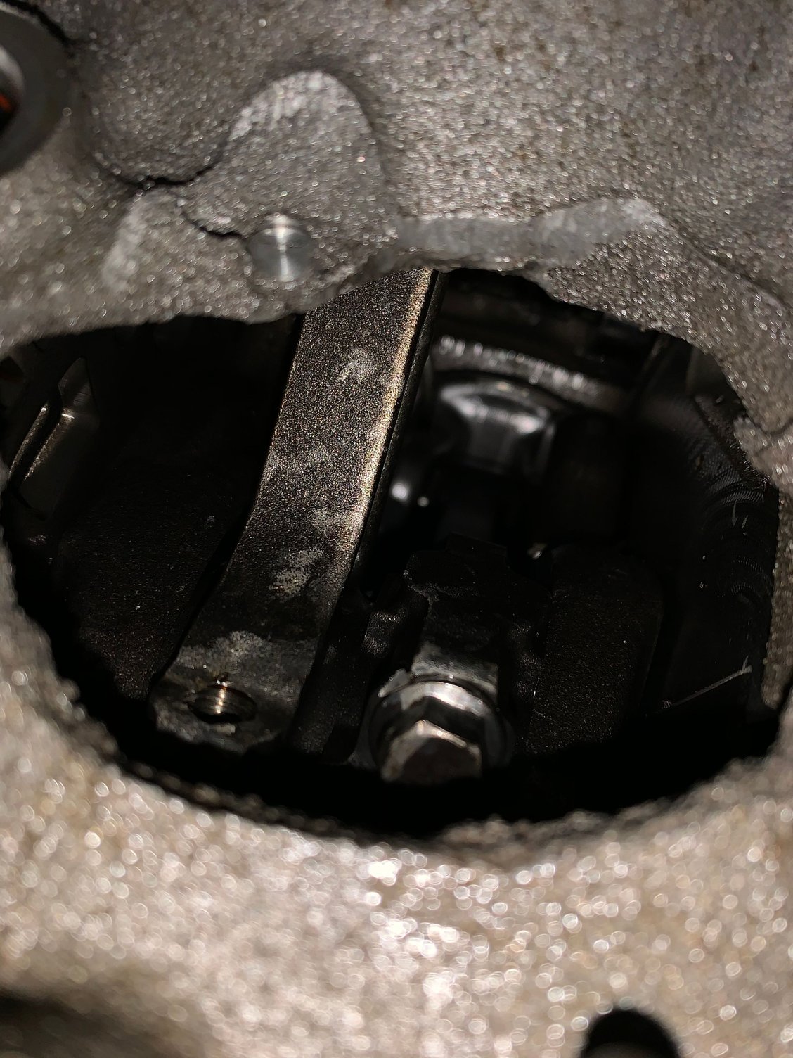

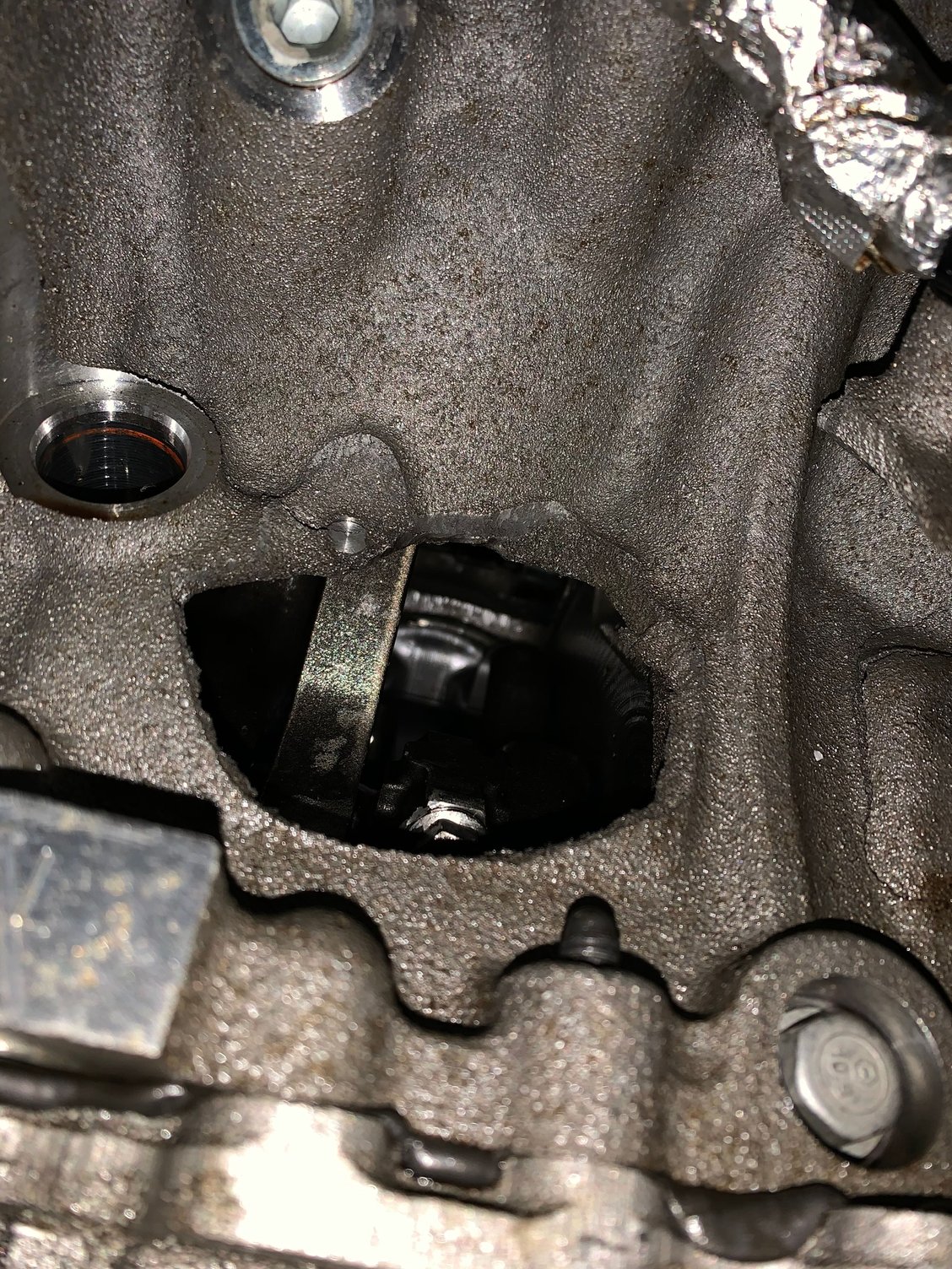

I’ve come to that point where my C7 and it’s engine must part ways. The engine was strong and ran great up until it didn’t. Lol. It looks like I had piston failure of some kind. Basically a piston came apart an scattered throughout the engine. So now I’m looking for a replacement. Thoughts and ideas on this are welcome.
Okay the current set up is a LT1 6.2L 376ci. I’m open to replacing it with a same size low mileage engine. My question on that is if I’m not mistaken isn’t the 2014 less desirable than a 2015 - 2019? Was this engine improved for the later years?
Im also considering a fresh build with forged internals 416ci stroker engine. I know this will cost significantly more than a good used engine but I’m wanting to know exactly what I could expect from both options so I can weigh out the differences.
Also if you have any other ideas and or suggestions. Please feel free to share. Thank you.
