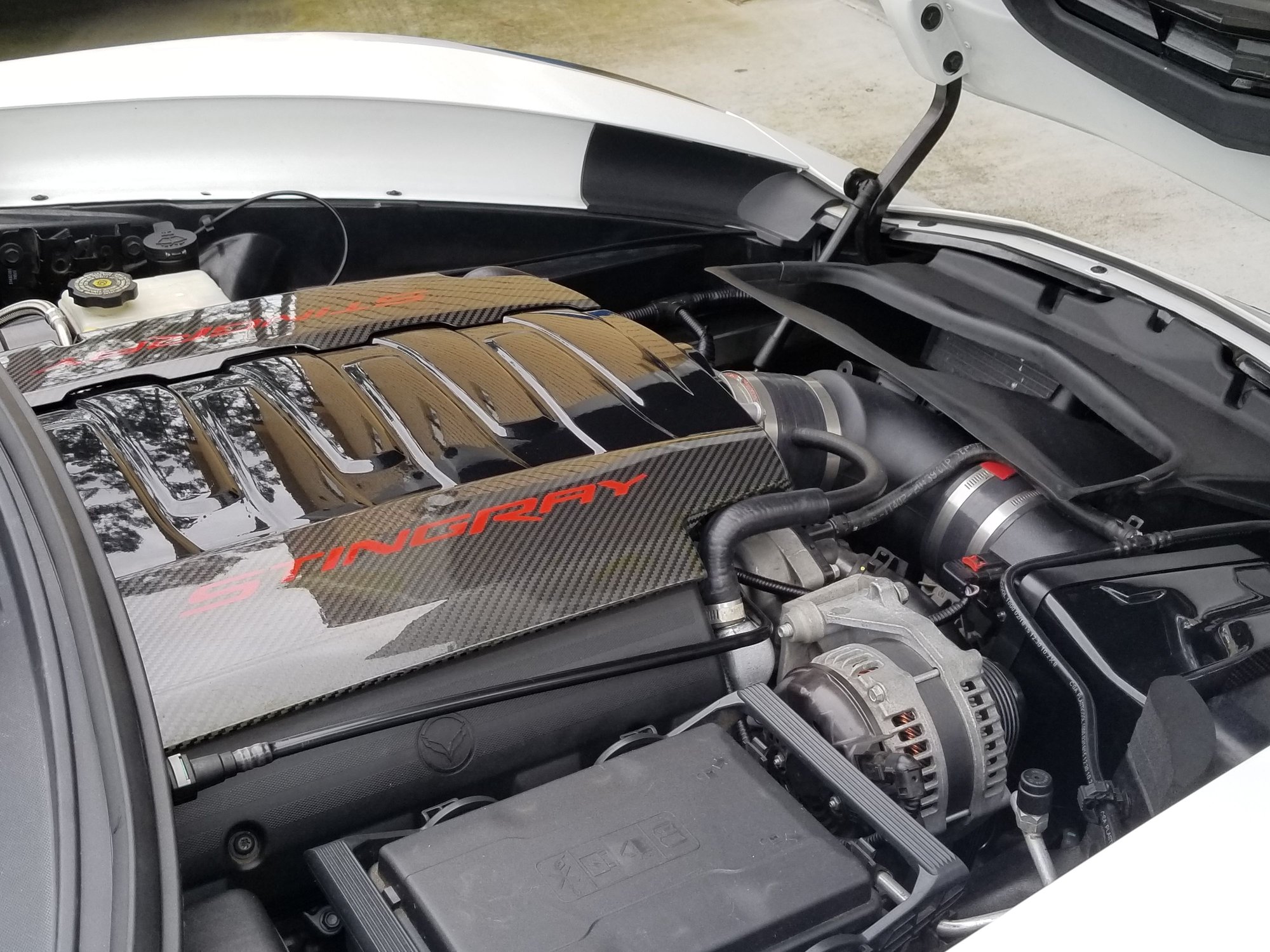

I installed a Vararam on my 19 GS. I drove to Bowling Green and all seamed well. Last week my car started sputtering. I opened the hood and discovered one of the hose clamped silicone couplers had popped off. I put it back together then discovered that there was no give to the assembly. None. The motor moves. You can’t have solid on a moving motor. I took the assembly off and discovered a warped POS. The plastic lid was totally warped and seal free and the rivets were hanging on by a thread. I replaced the rivets with nuts and bolts. I have a hump silicone coupler coming that should give it some give. I replaced the hose clamps with T bolt clamps. I spent an hour trying to make it work. Their customer service didn’t return my call. Anyone else have these problems?

Everything was good. Drove to Bowling Green and back to San Diego. No problems until there was. The stock hose clamps on one of the joints popped out. I guess the joint wasn’t tight enough. I read that hose clamps aren’t supposed to be used on silicone hose that’s why I’m switching to T Bolt clamps. I still won’t tighten them enough to damage anything. Usually, I buy K&N cai, but I thought I’d try a different brand this time. It installed easily. Everything fit. Then everything warped. It doesn’t fit very well anymore.

Do me a favor please. My car has 20k miles As well. Would you go give your plastic hose a push and a pull to see if there is any give? It’s rubber mounted. There should be some give to allow movement.

It wasn’t just the coupler letting loose, it was the warped condition of the air box. Yours is warped like mine, except mine is worse and lets in air. I’m talking about where the snap clamp that holds the lid on is. As you're looking at the air box from the pass side, the right top corner isn’t flush. Mine started out fine. Now it’s tweeked. I thought about heating up the plastic lid to try and straighten it out. I’m also considering cutting off a small portion of the plastic tube. No matter how a adjust it, that tube is is against the throttle body and the air box side. Another part of this, is that the Vararam folks have never called me back. I just wanted to know if my warping is common? After reading these reply’s, I guess not. Lol. I’ll try the hump coupler I received yesterday. It gives give. Thanks guys....

I figured out my fix for the lack of flex between the assembly and the motor. I mentioned before that I bought a hump silicone coupler. It gave me the flex I was after. I took apart the whole assembly and used a heat gun to get the lid as straight as I could. I used some round stock under the two star bolts in the lid. The two small bolts with washers would easily crack the thin plastic they tighten against without any support underneath. By the way, the nuts and bolts I replaced the rivets with? They’re outside the air filter. A bolt can’t pass through. A nut in the throttle body is not a good thing. That’s it for me. My problem was solved with a little rework. One thing more, I sanded flat the raised block letters that say “Vararam” and painted the letters in red. I like it. It’s cool. Thanks all.
